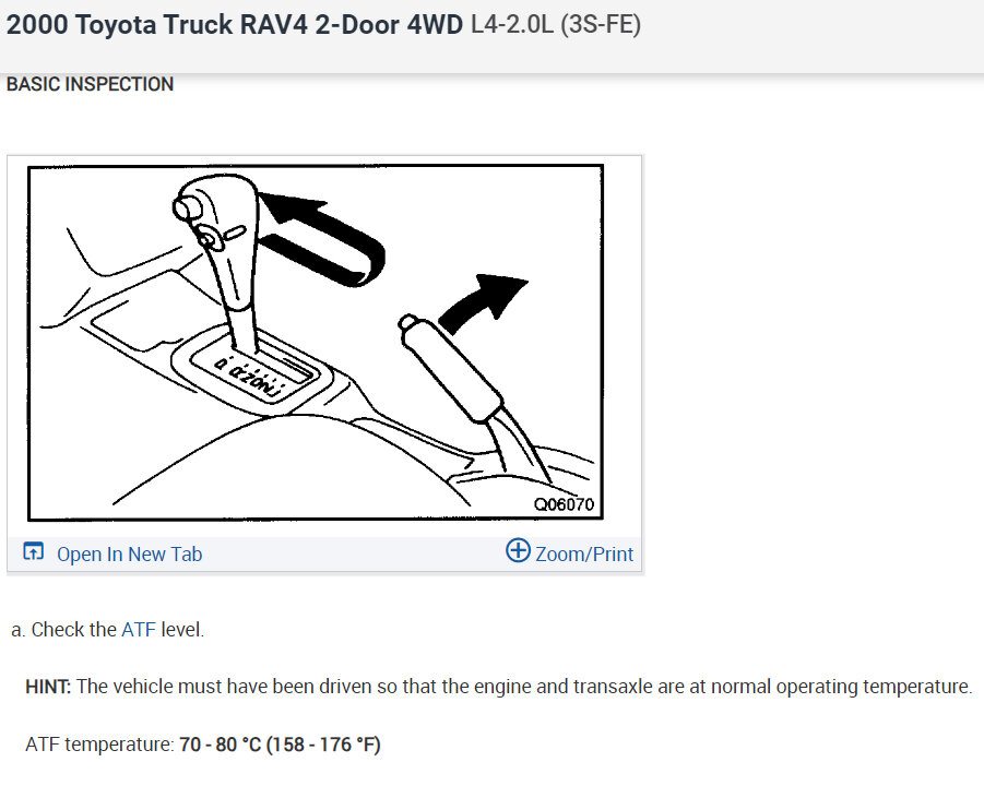

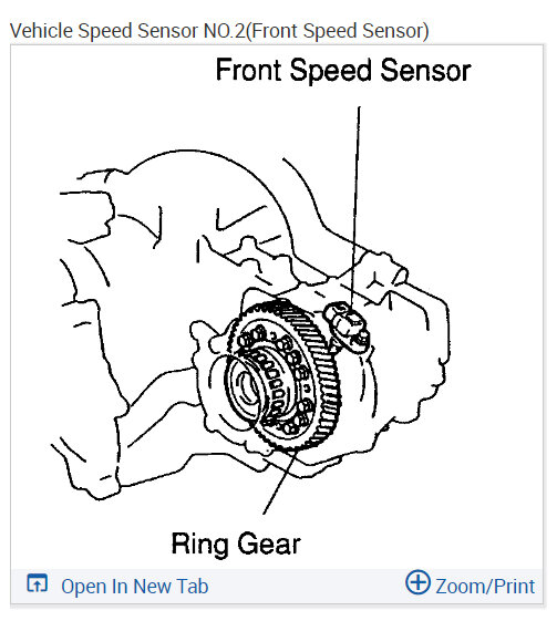

I have seen a bad front speed sensor cause this problem, lets run the codes to see if any are stored, this guide can help:

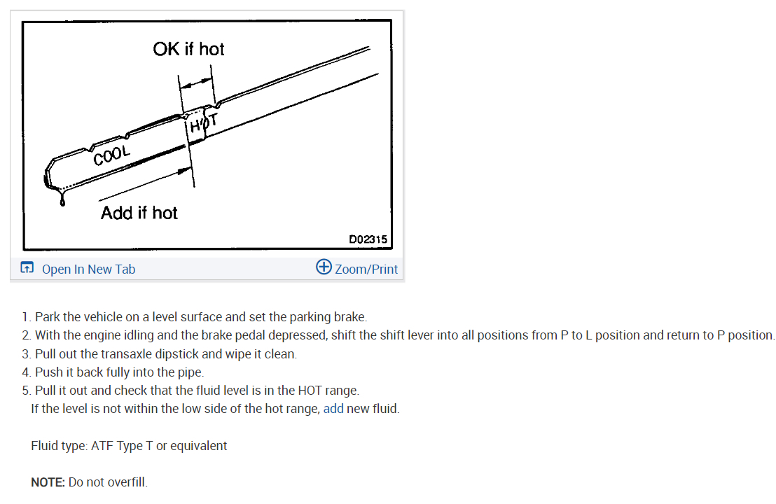

Here is the location for the front sensor in case a code is present for it. Also, check the transmission fluid level as well. Can I ask if the transmission has been serviced? Check out the images (below). Please let us know what happens.
