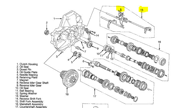

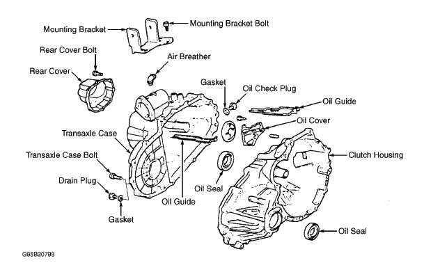

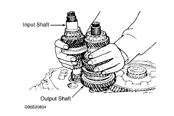

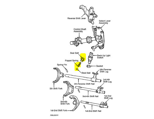

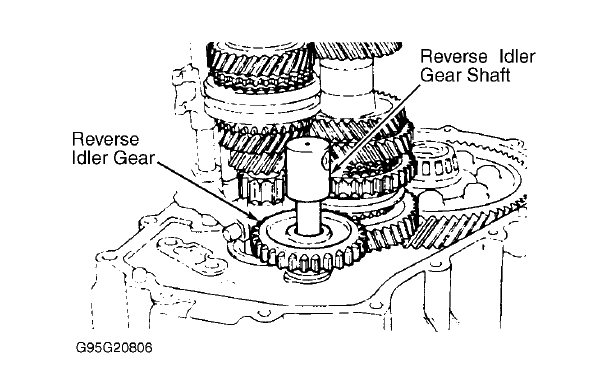

Hello, it is a basic manual transmission i don't think it needs special tool. i found exploded view of front wheel drive gearbox you can have an idea what inside it. check fig 1, first after you drain gearbox oil remove the rear cove and transmission axle cover fig 2. you will see the gear assemblies input and out shaft fig 3 and fig 4, on the input shaft biggest gear must be the first gear, fig 5 you can see the selector shift fork assembly and the steel ball with its spring that seems your problem is there. gear with the small point which is the metal ball that when the gearbox is disassembled clearly defect must be appeared at the selector link for the first gear.

Thank you very much for your reply. The exploded view is most helpful as well.
