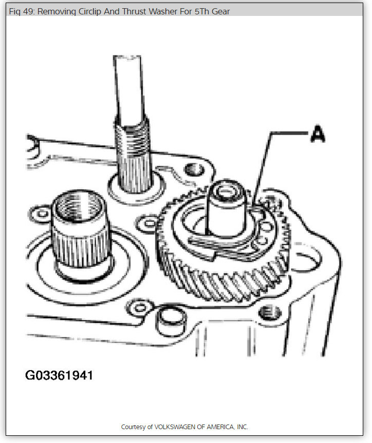

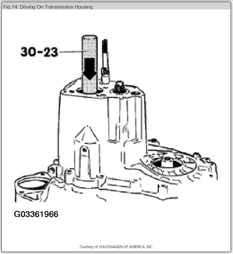

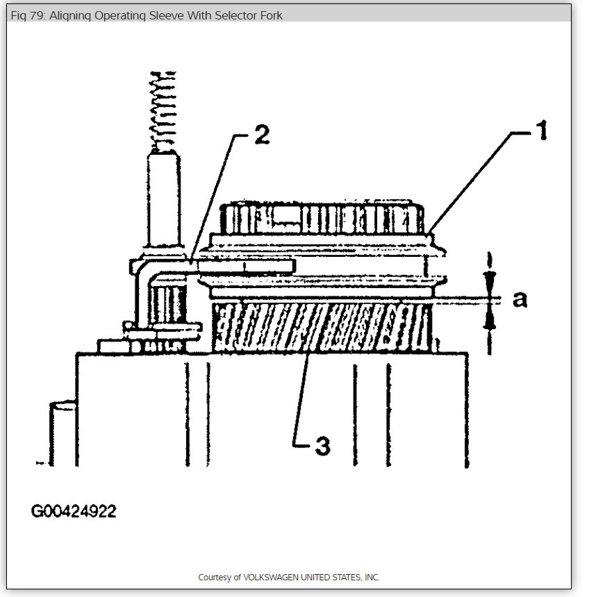

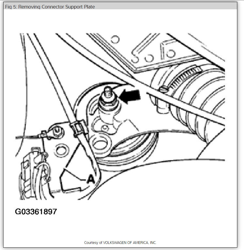

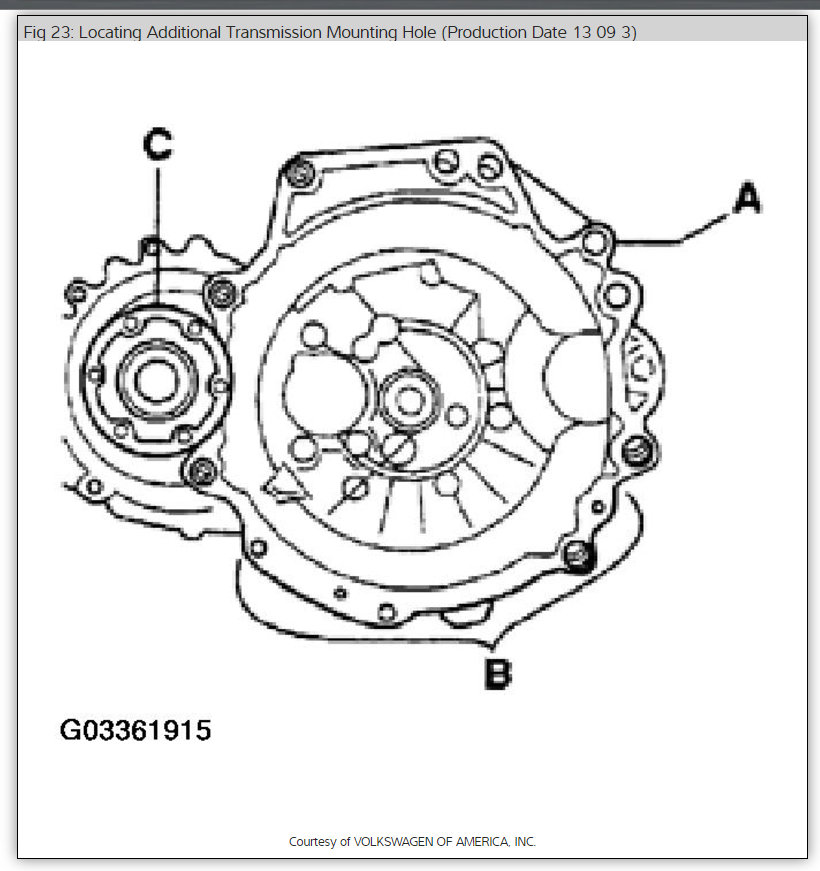

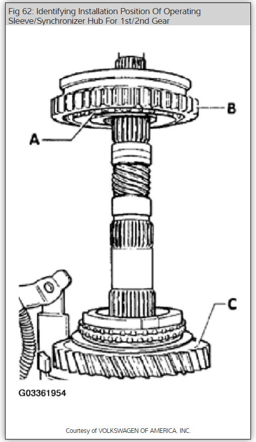

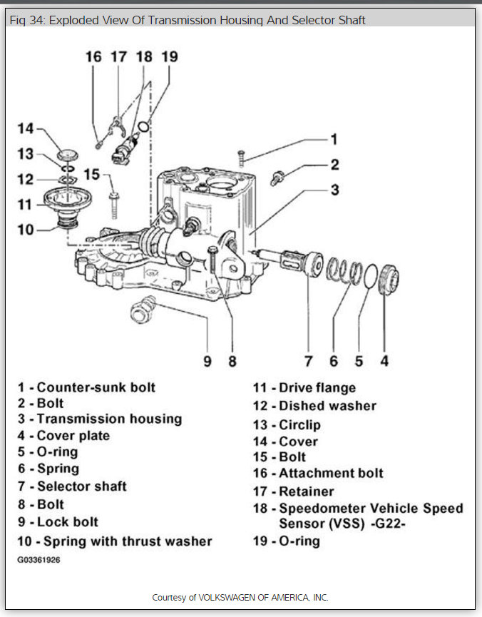

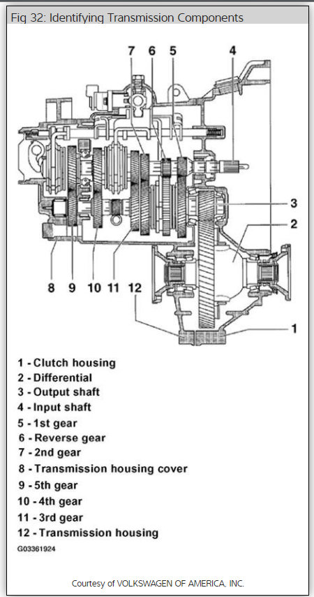

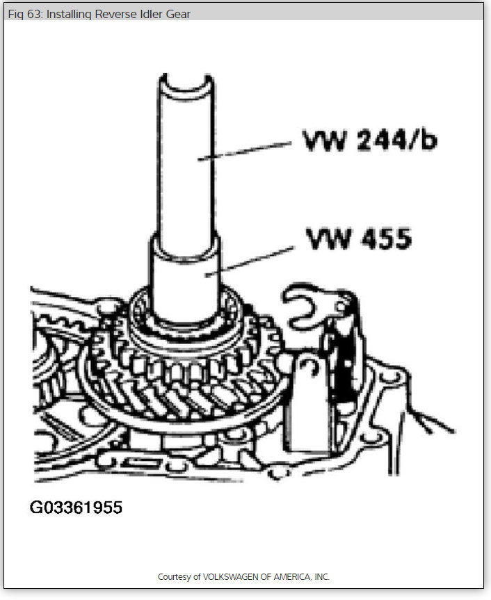

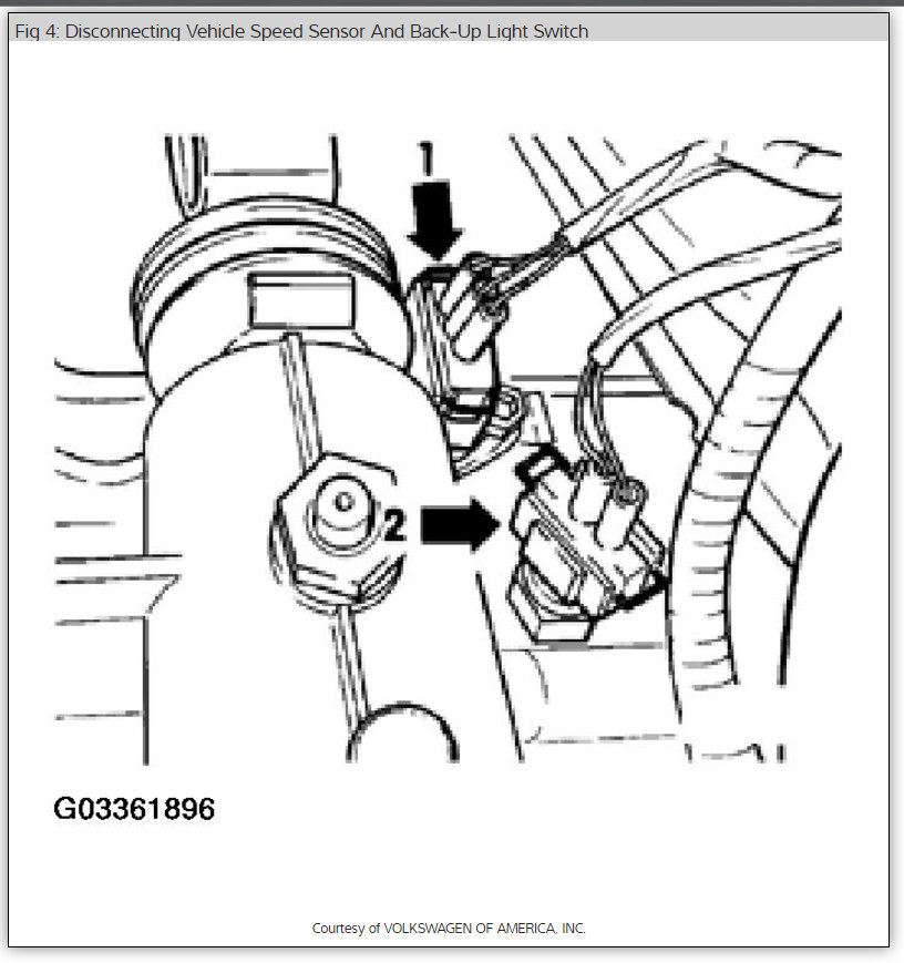

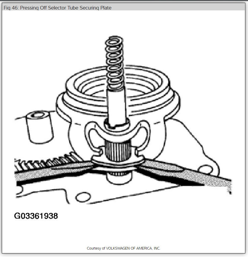

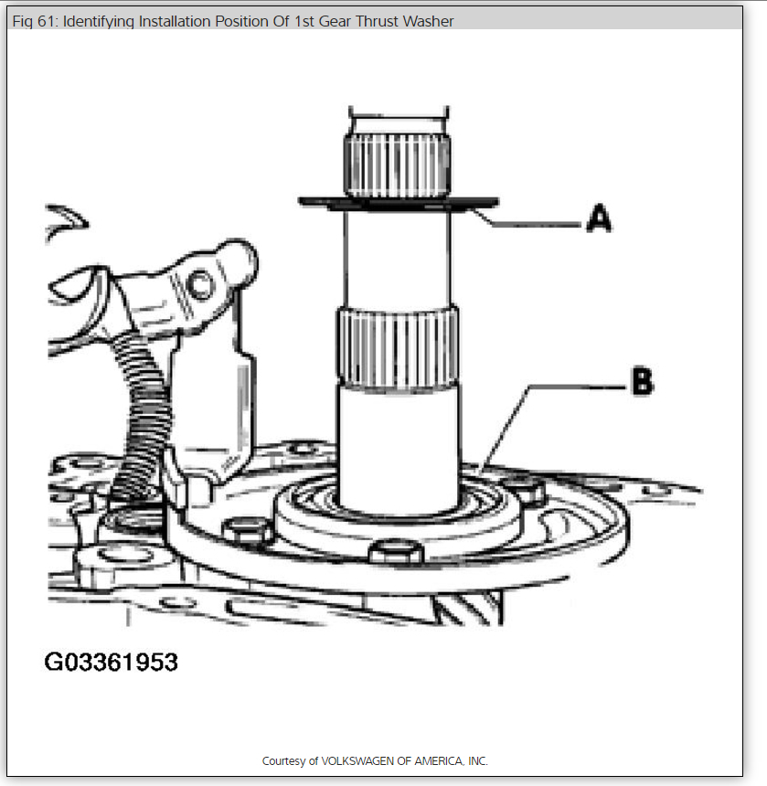

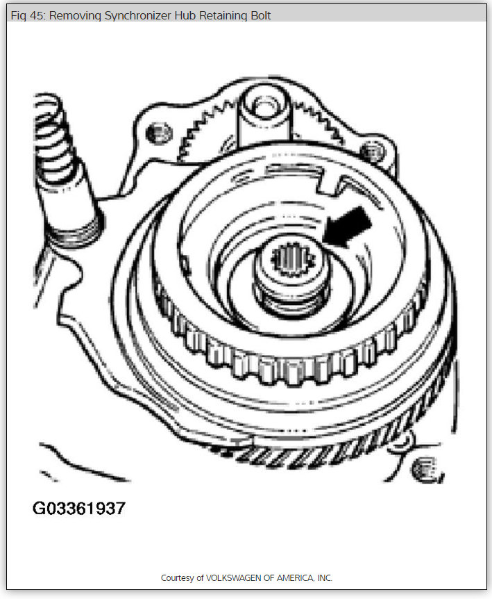

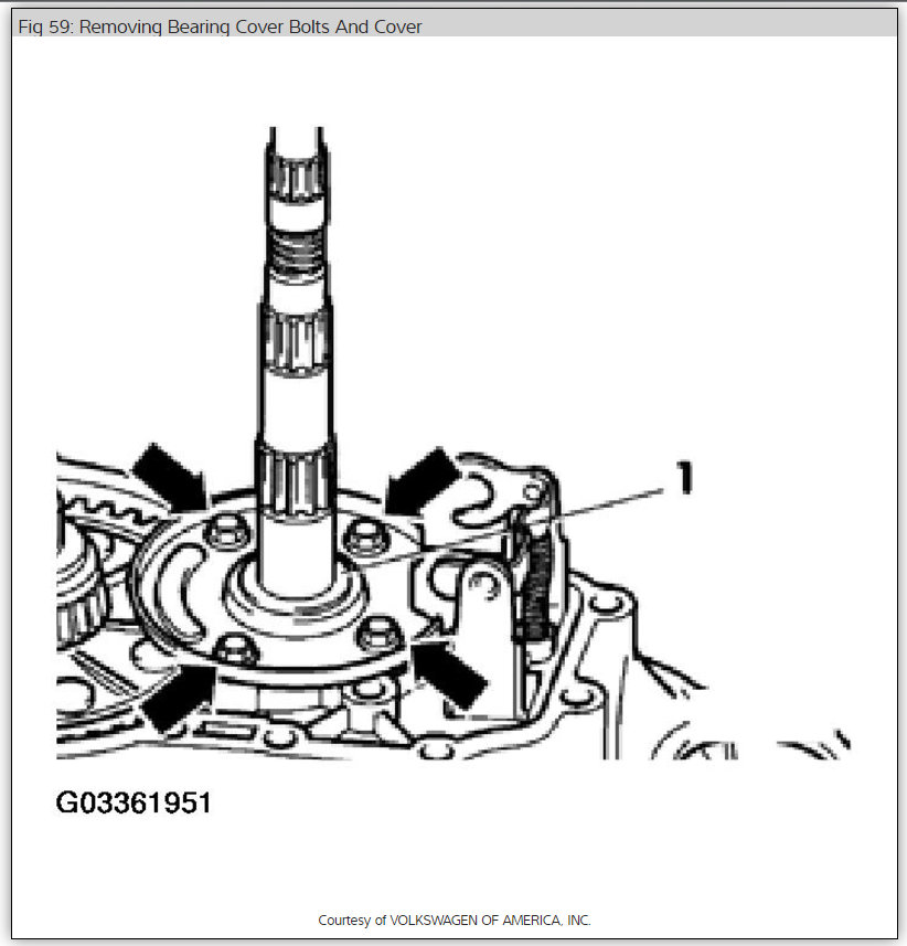

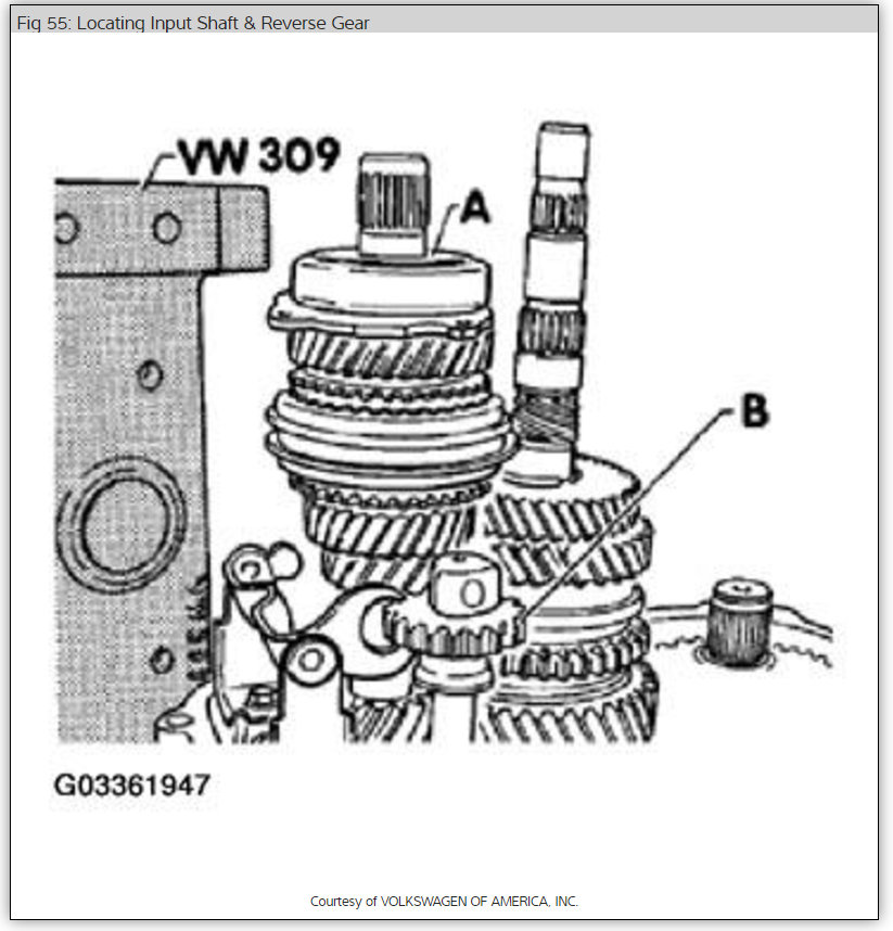

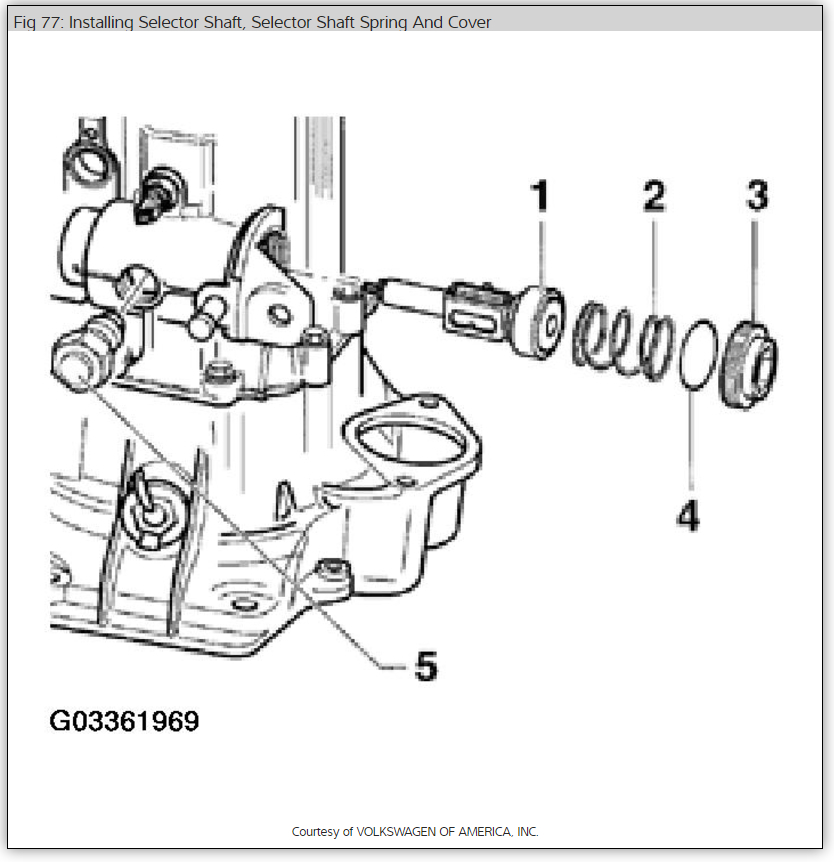

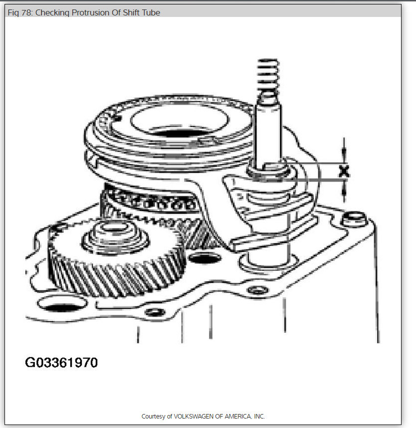

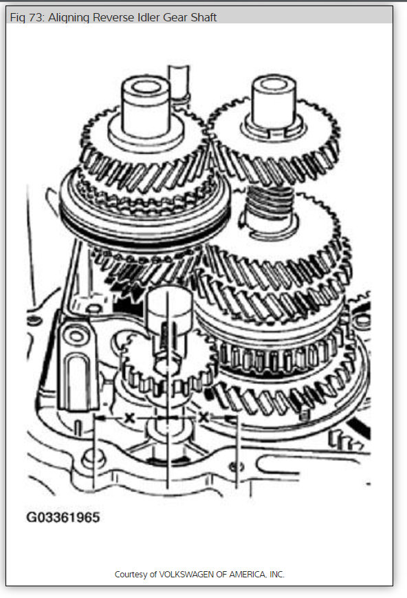

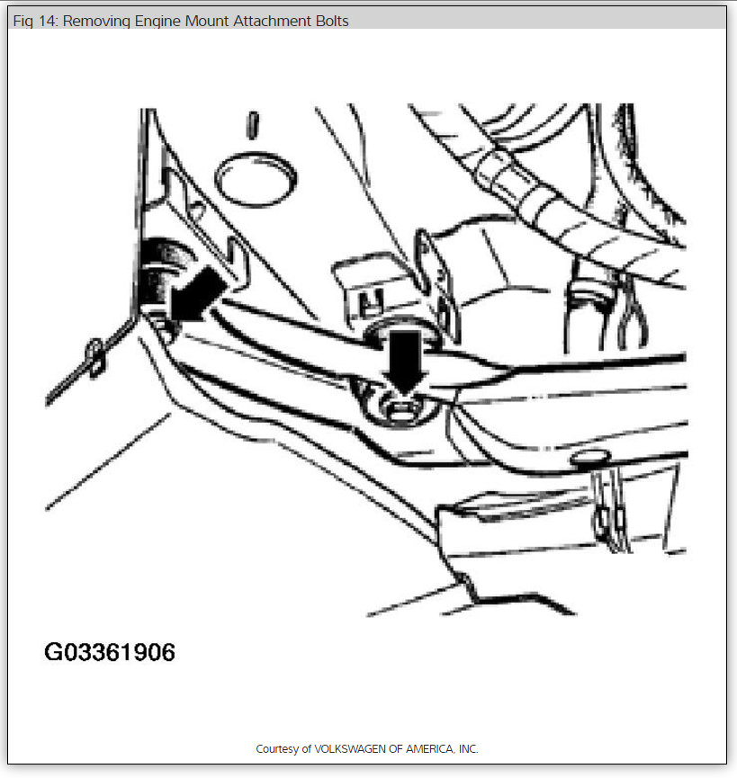

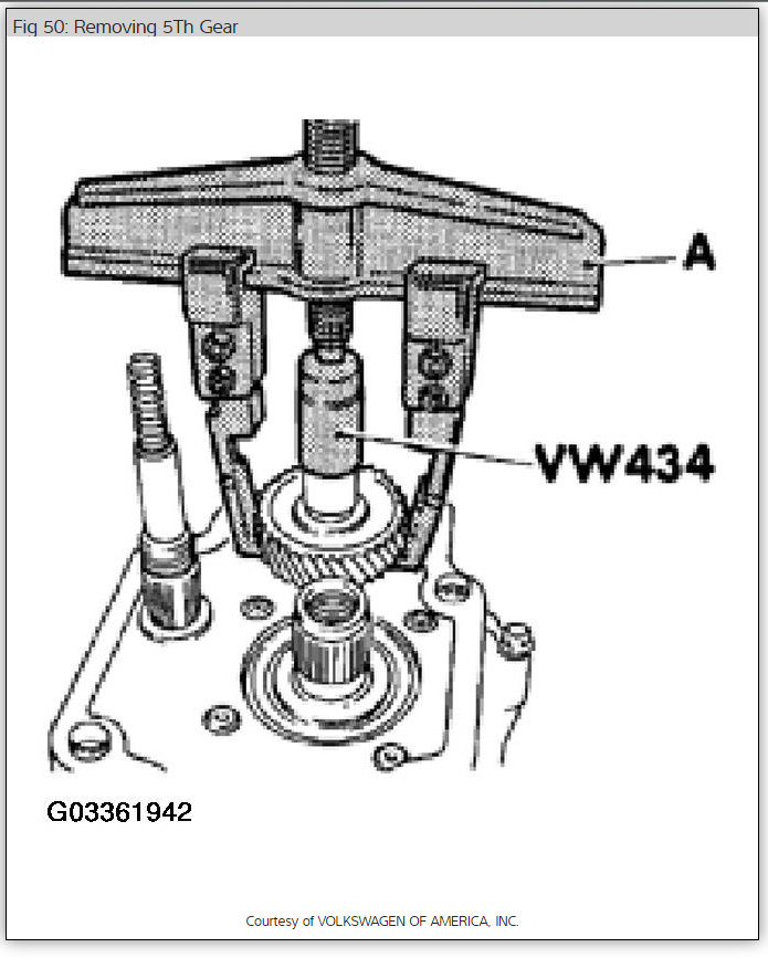

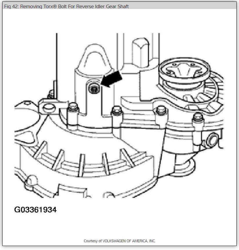

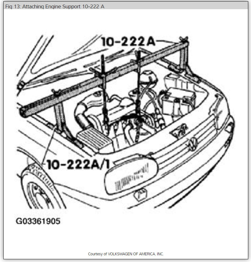

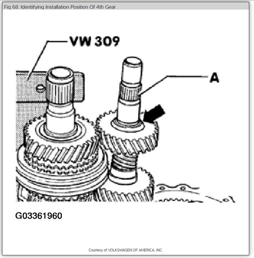

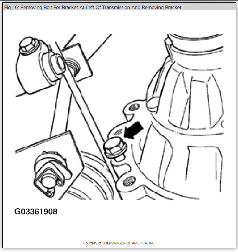

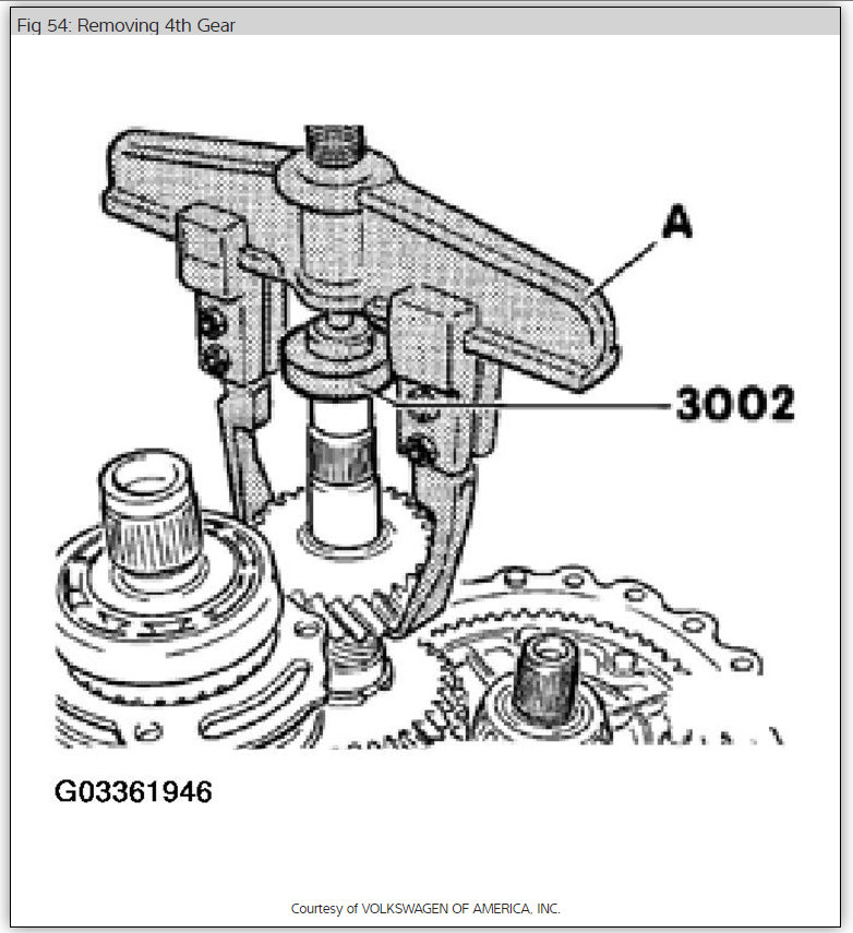

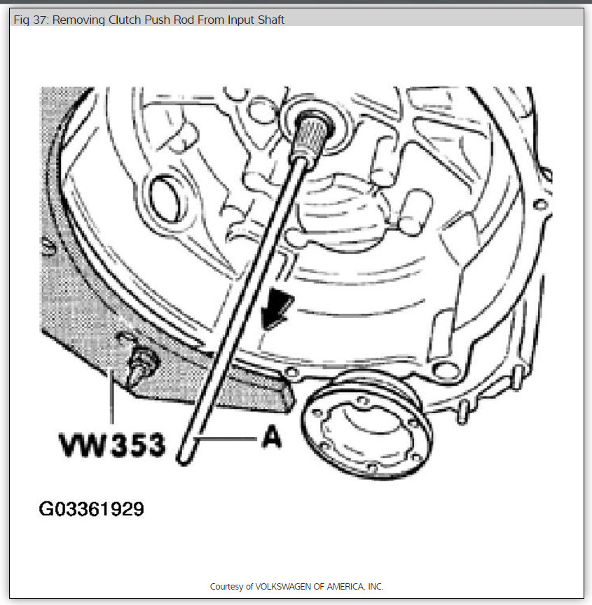

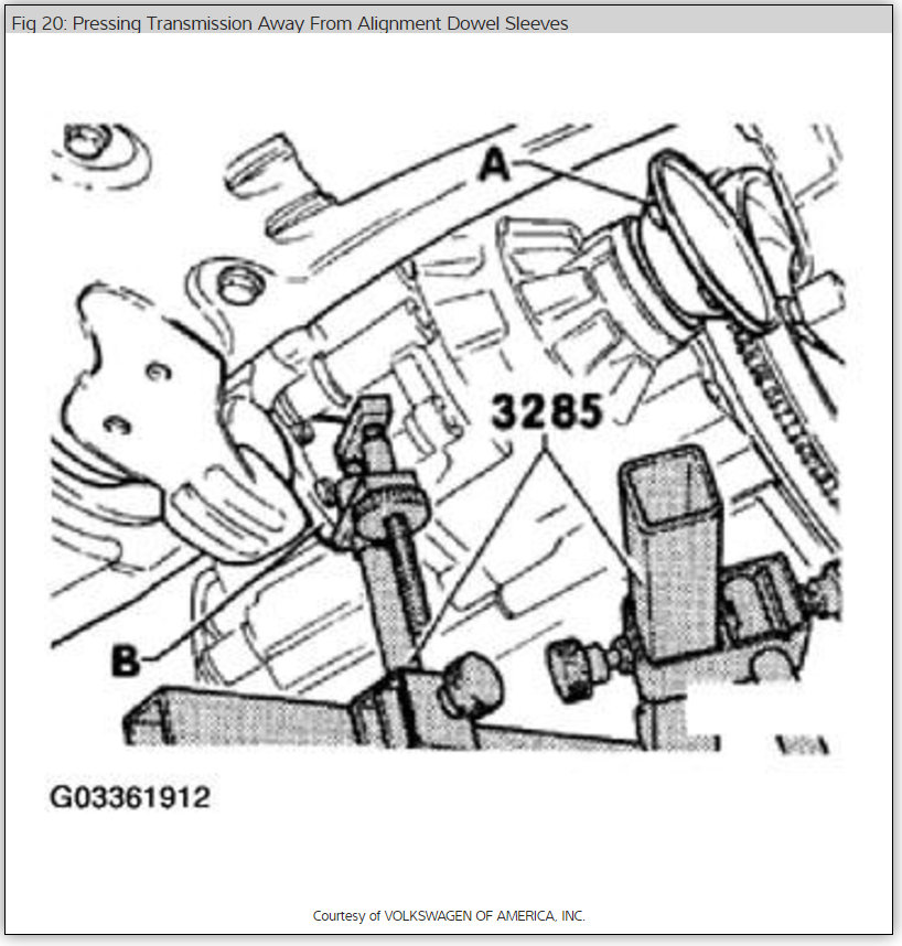

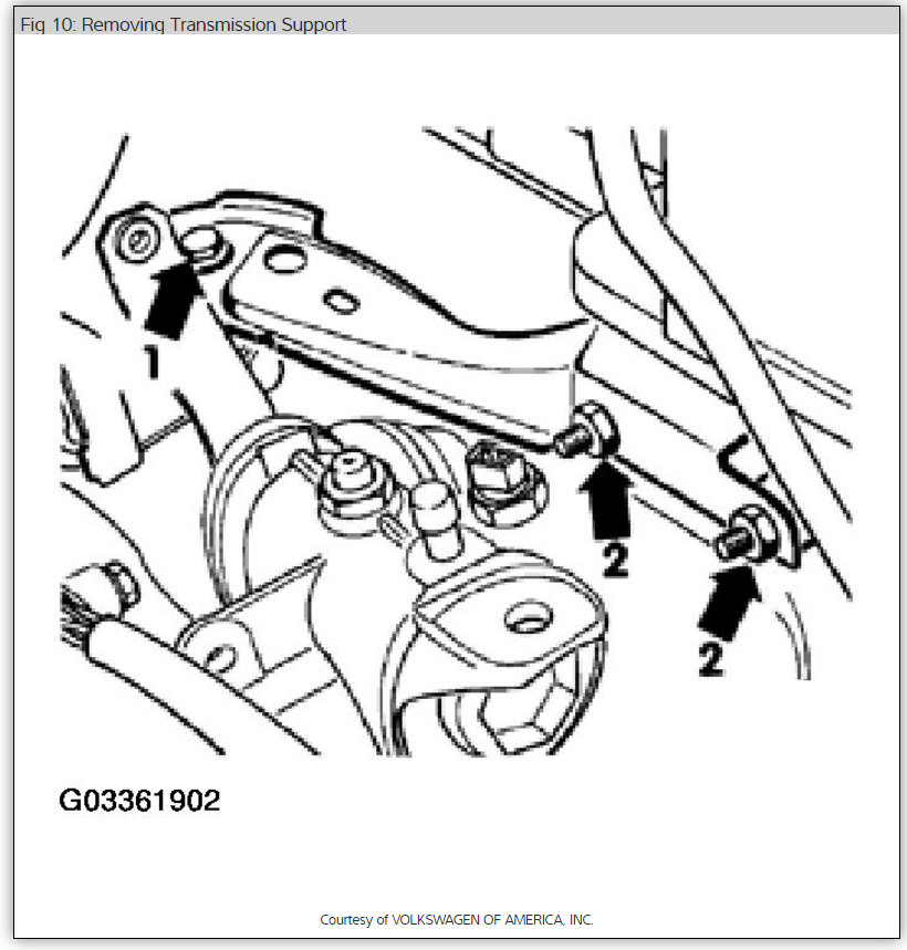

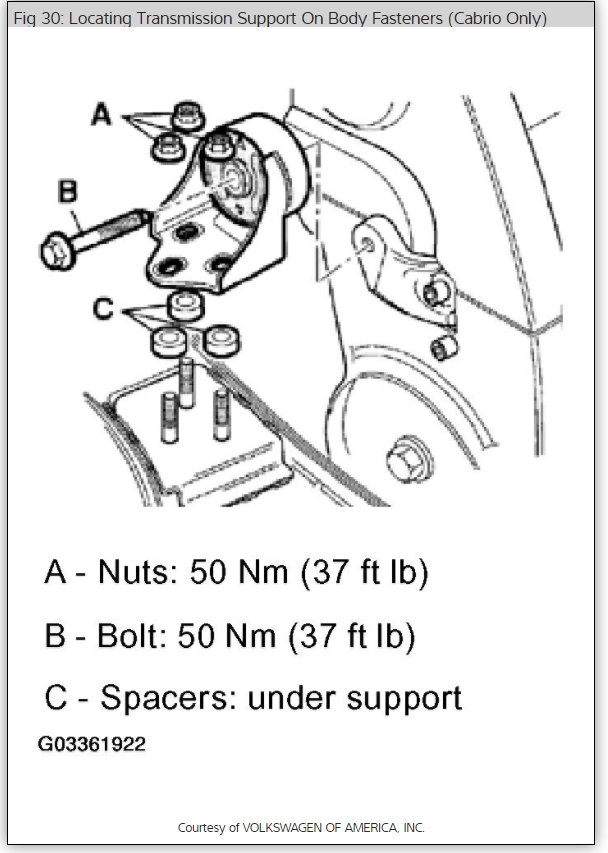

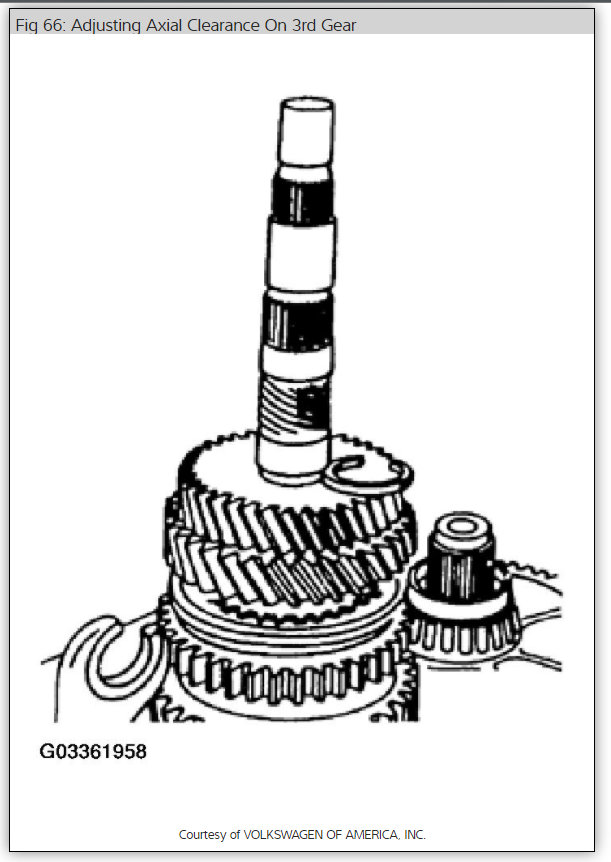

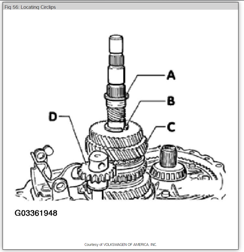

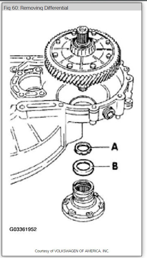

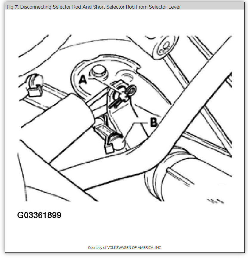

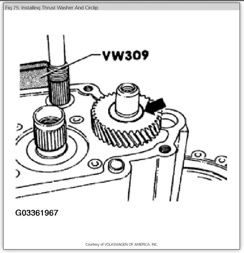

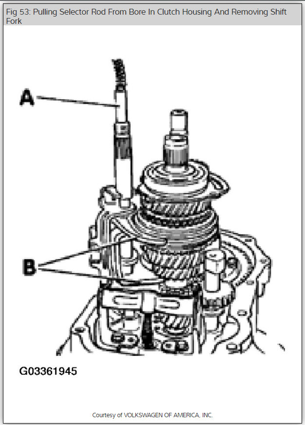

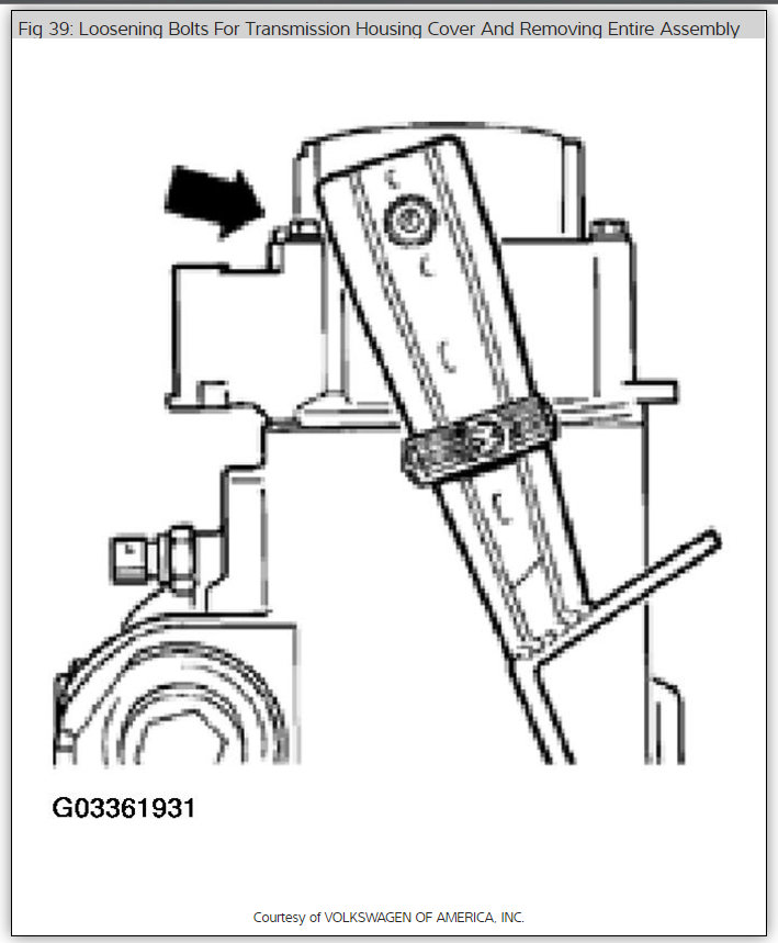

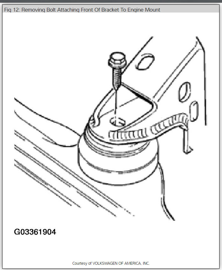

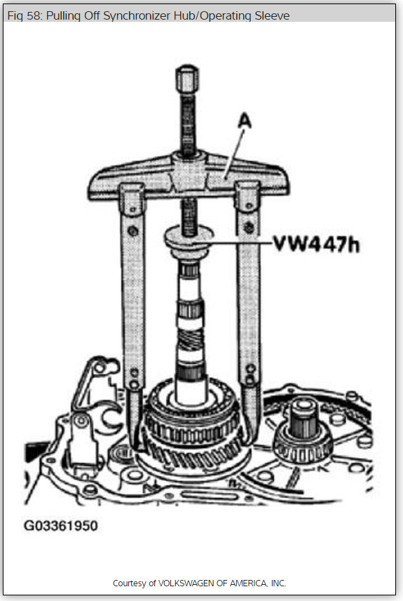

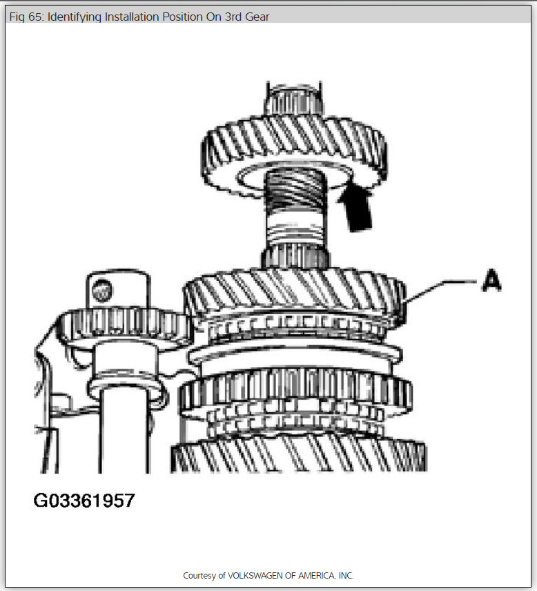

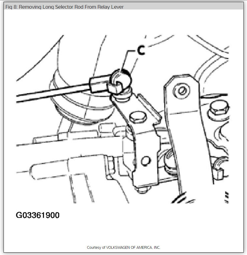

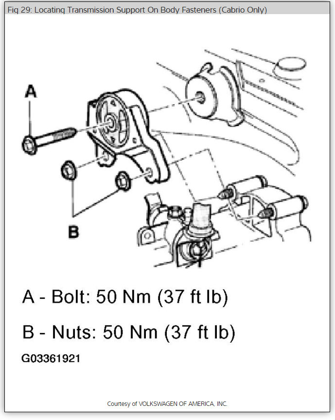

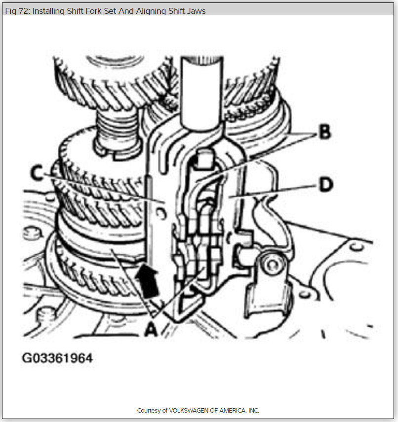

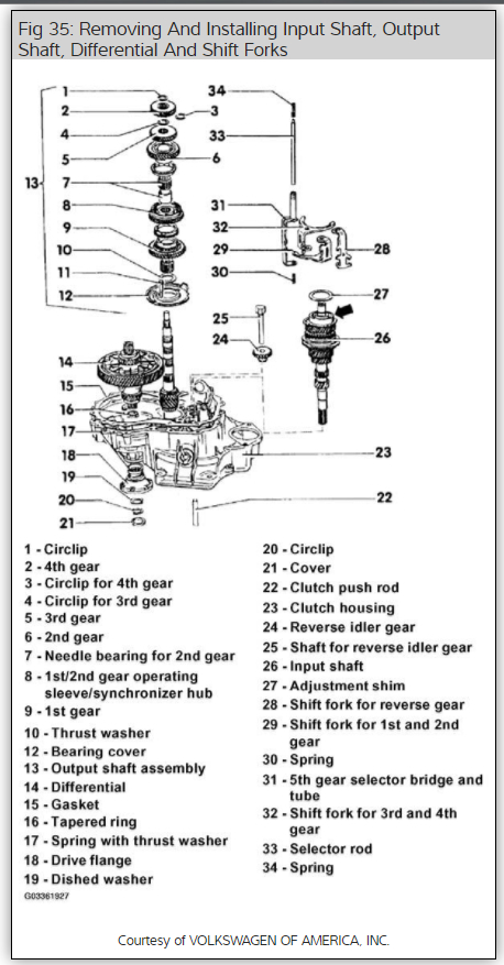

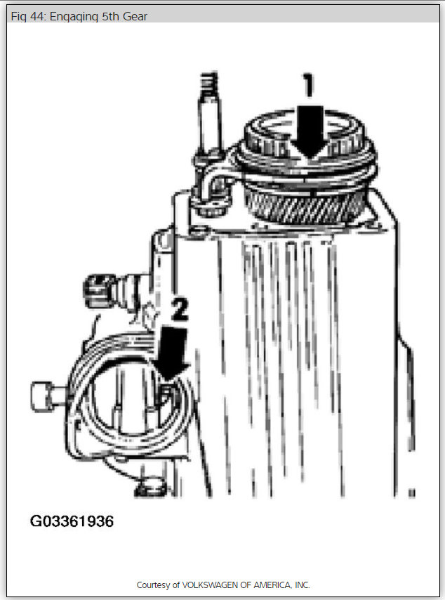

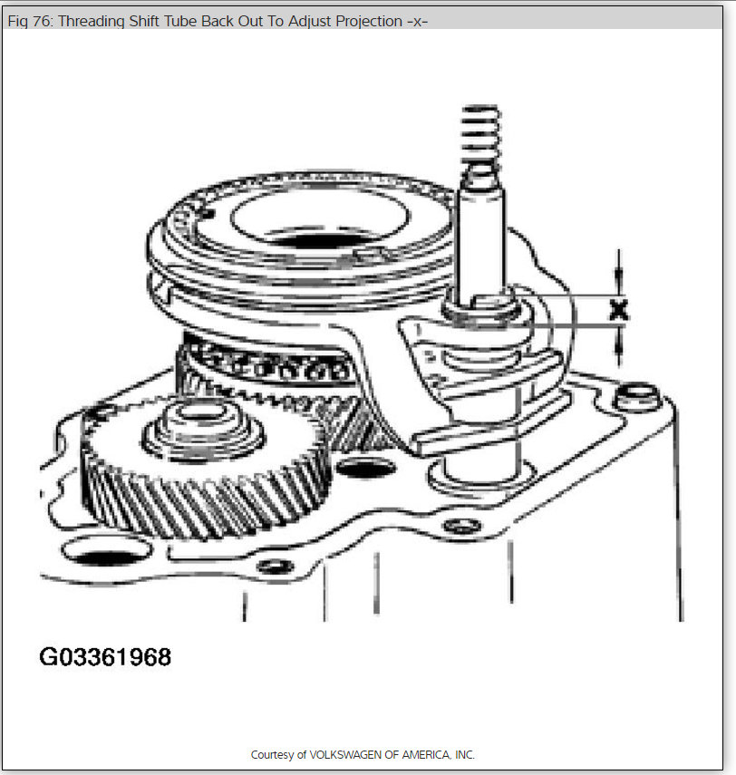

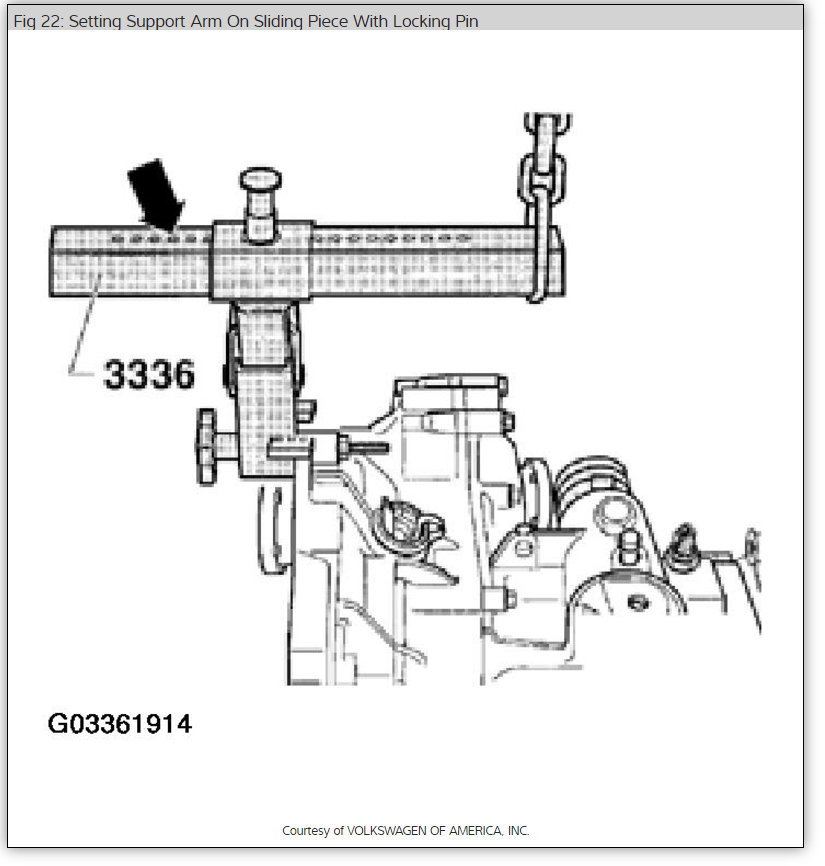

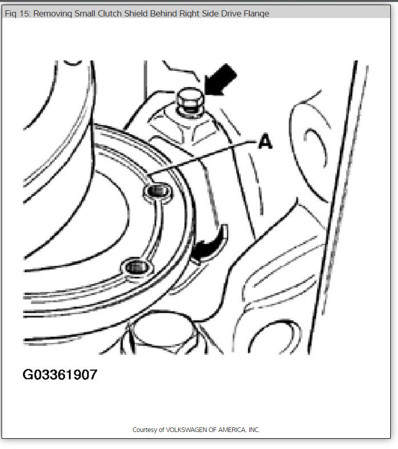

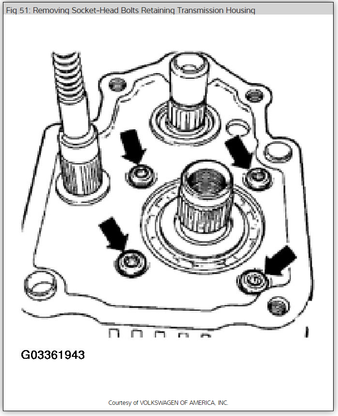

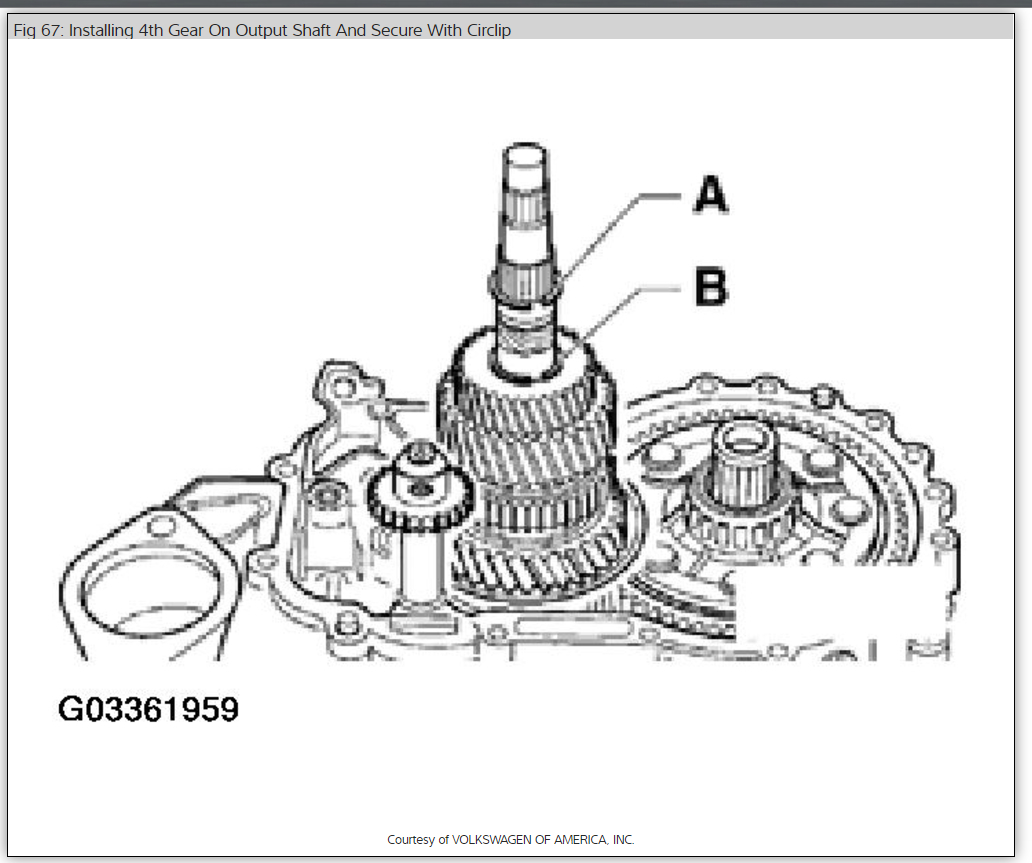

How can I repair linkage that broke off in gearbox? it is stuck in third gear. the box is already removed from the car (Polo Playa 2000 four door hatchback).
Jul 31, 2017 at 5:41 AM
  • 55,421 POSTS

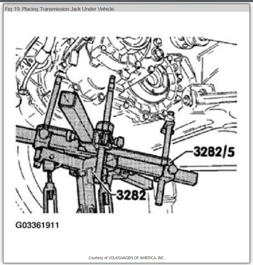

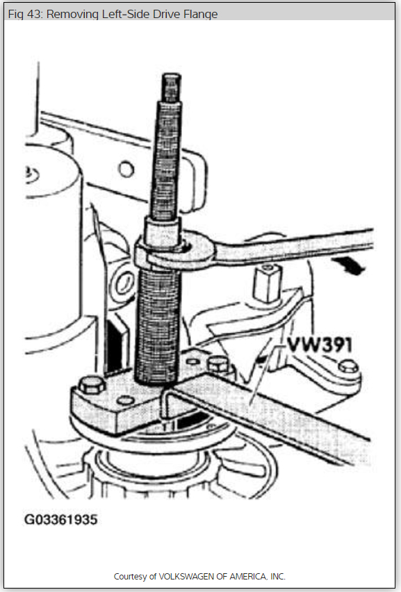

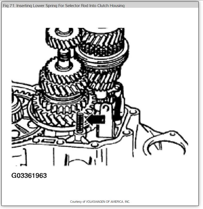

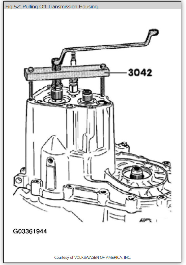

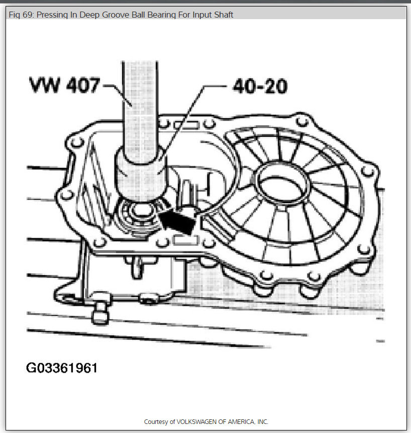

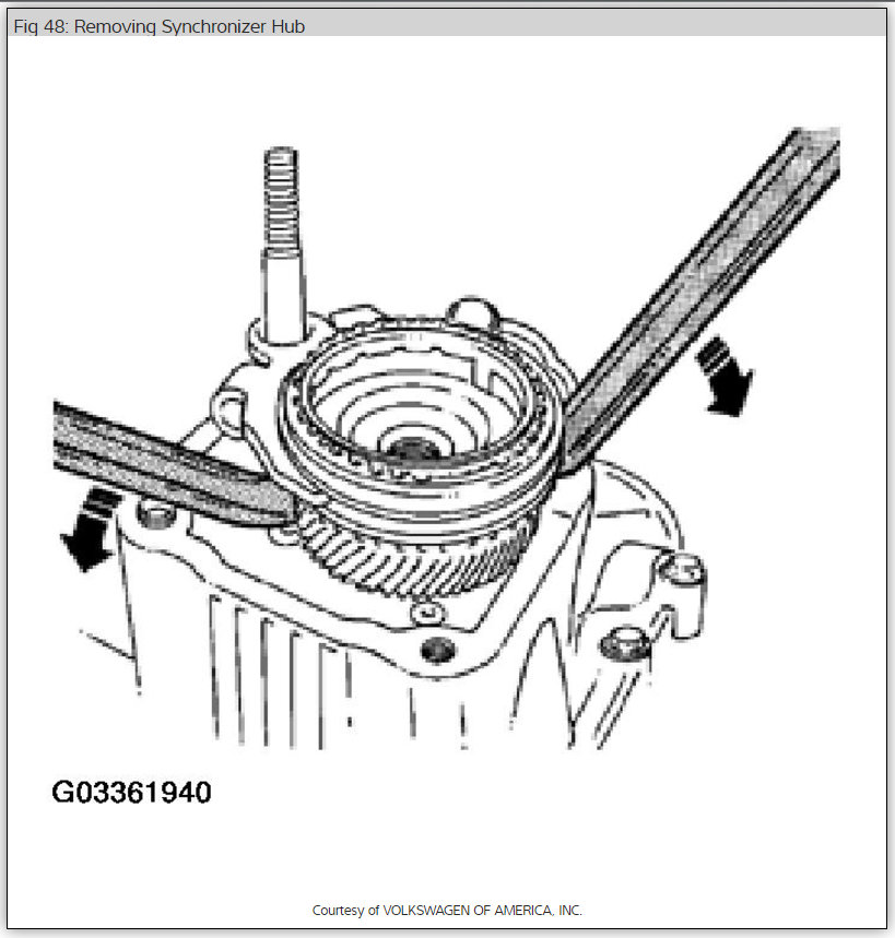

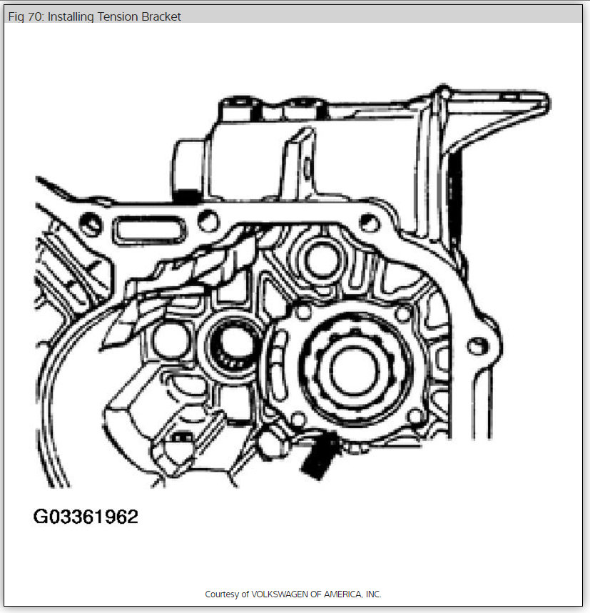

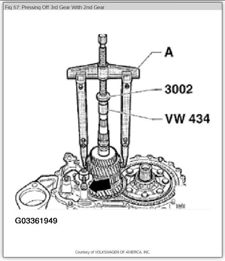

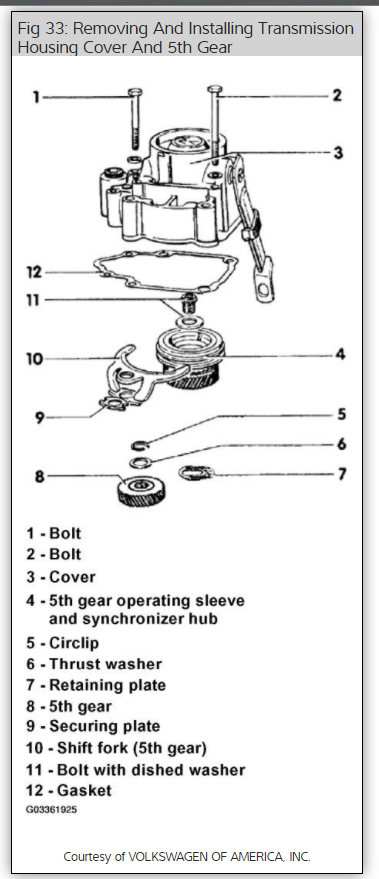

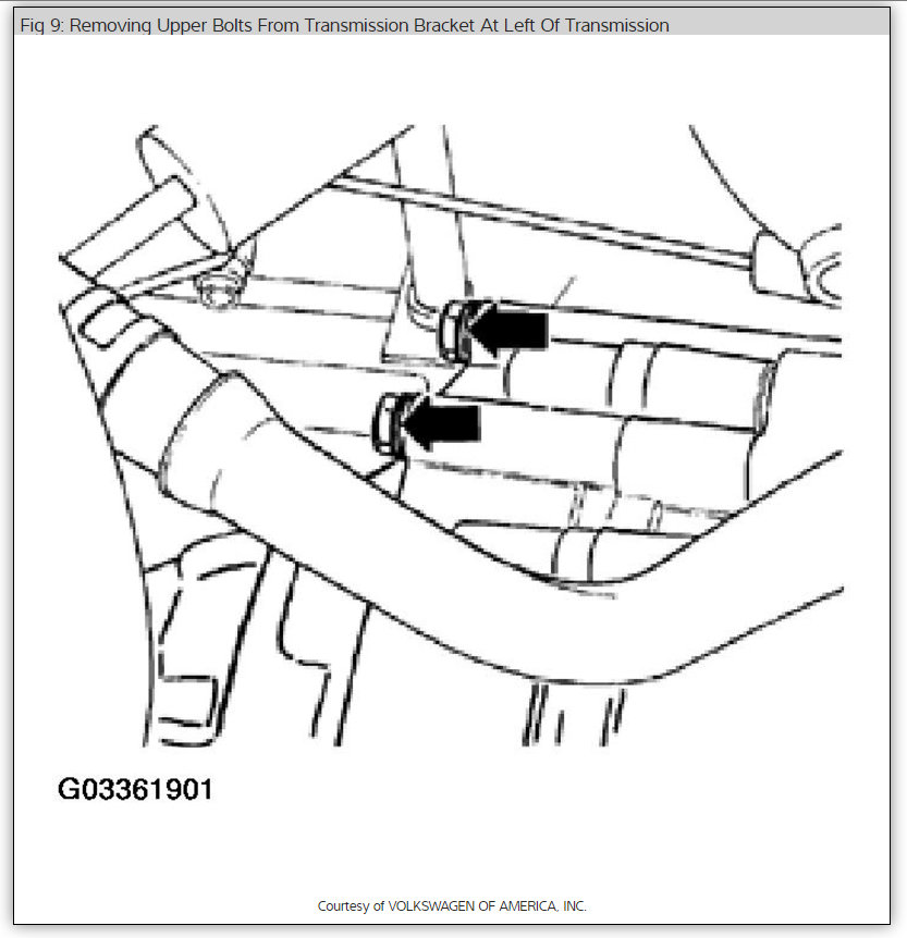

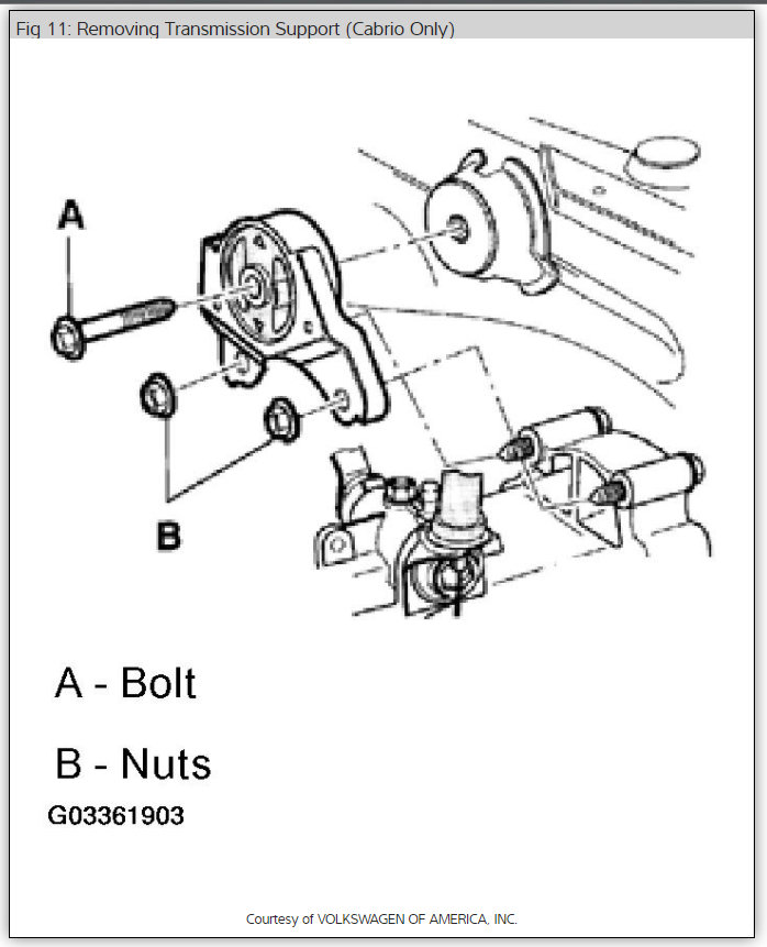

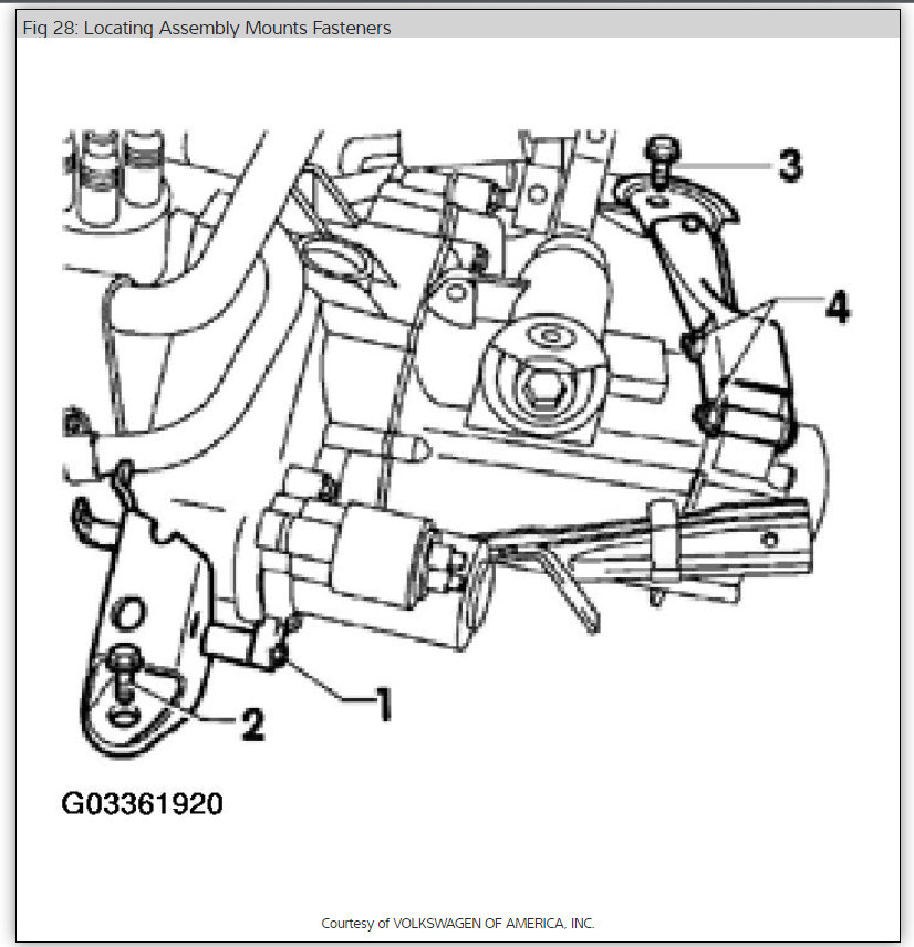

You need to take the transmission part and see what has broken, I have included the diagrams to help you get the job done and how to get the transmission out even though I know you have already got that done.
Here are the diagrams (Below)
