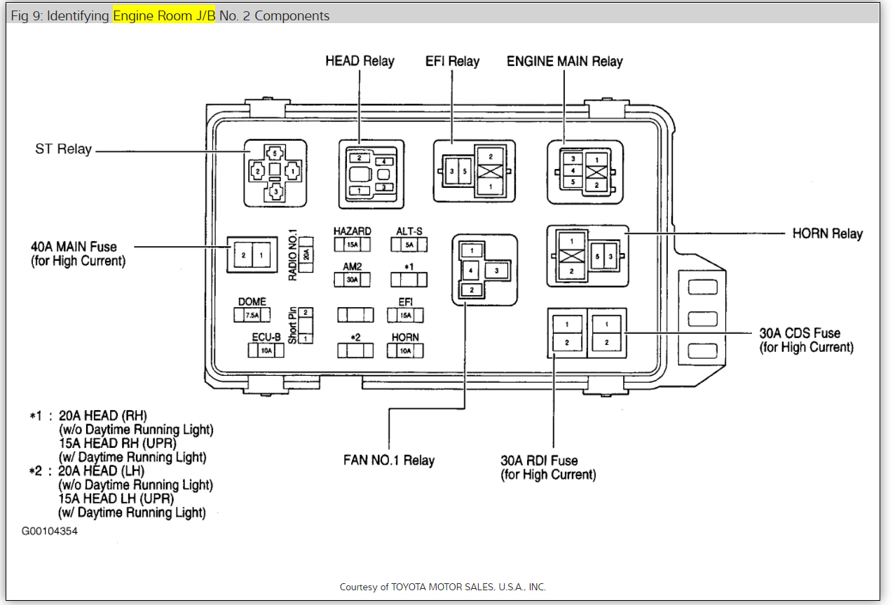

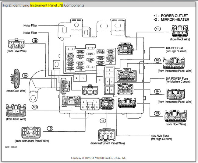

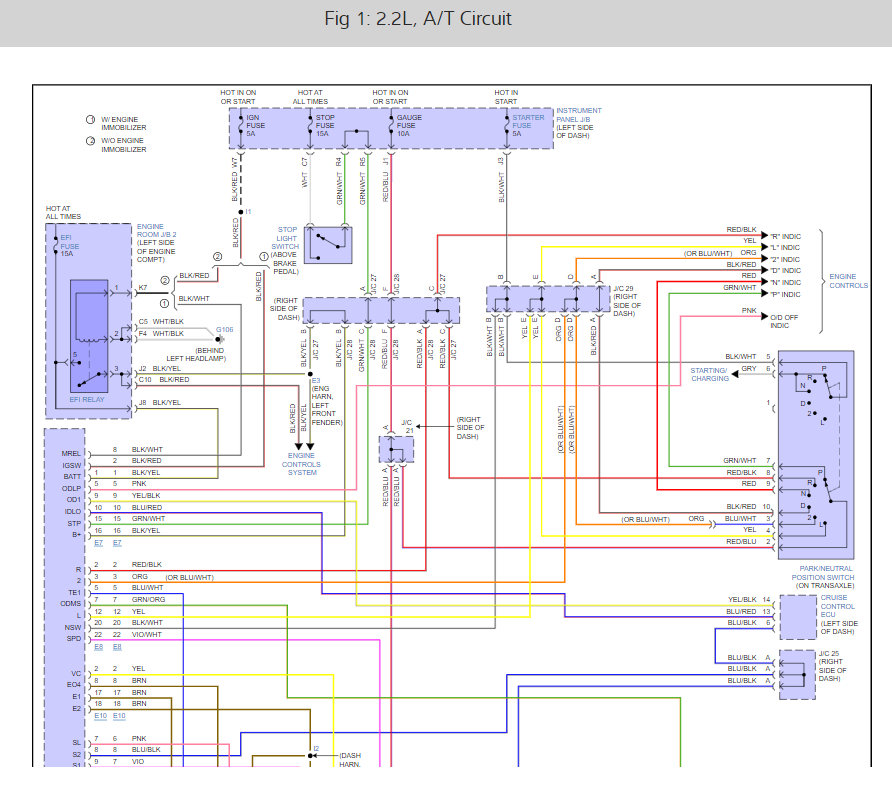

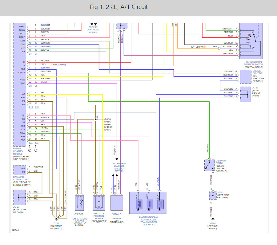

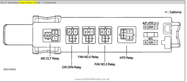

I have 1G FE engine Automatic transmission the gear won't shift into the fourth gear the overdrive button hasn't got any Voltage.
How can I rewire It and where?
Jul 23, 2022 at 6:57 AM
  • 55,395 POSTS

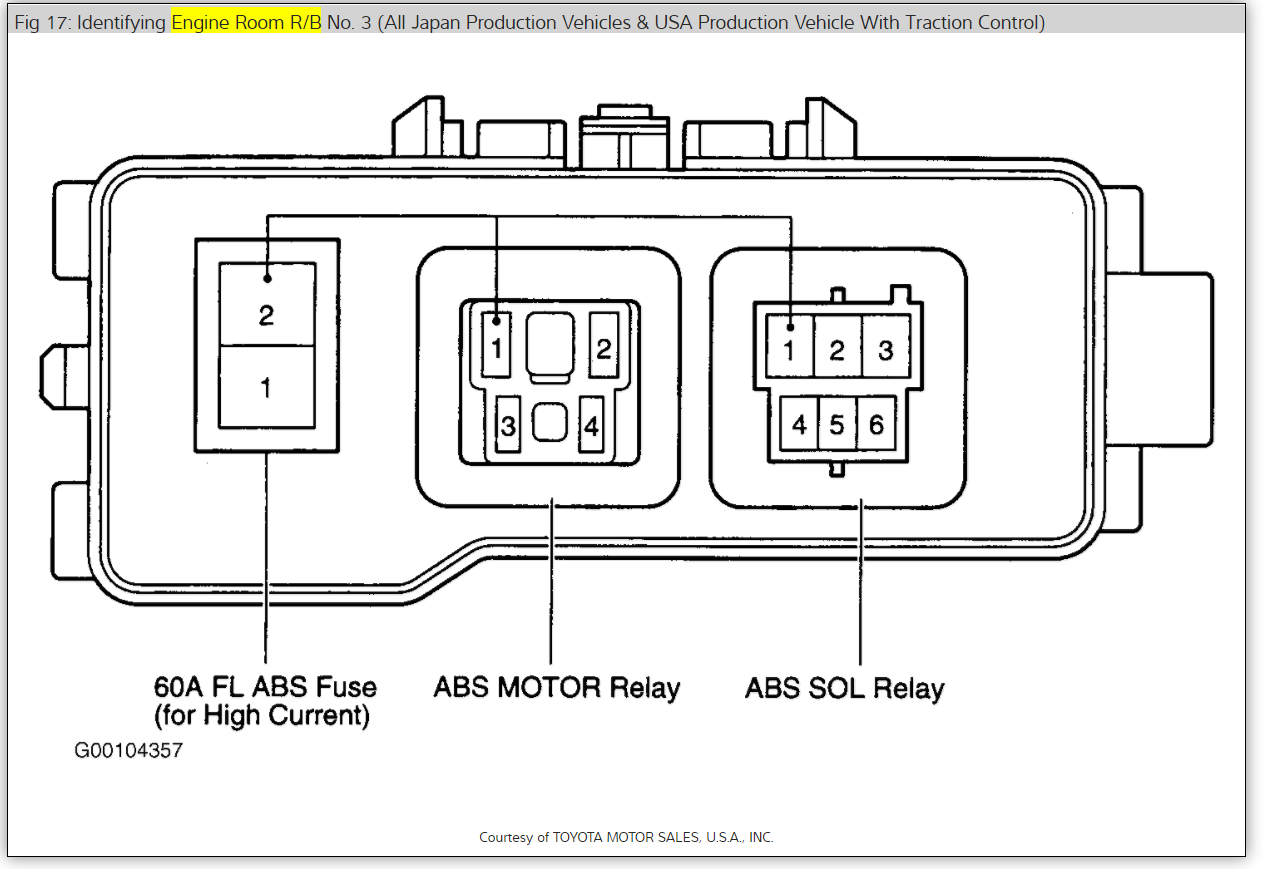

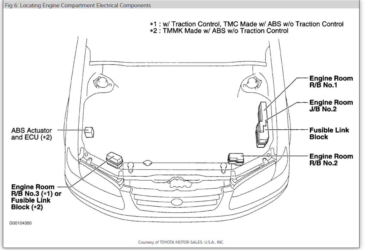

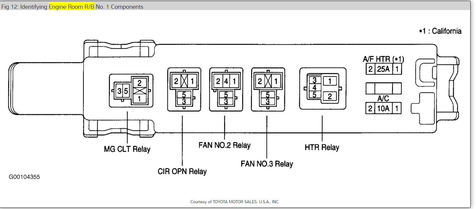

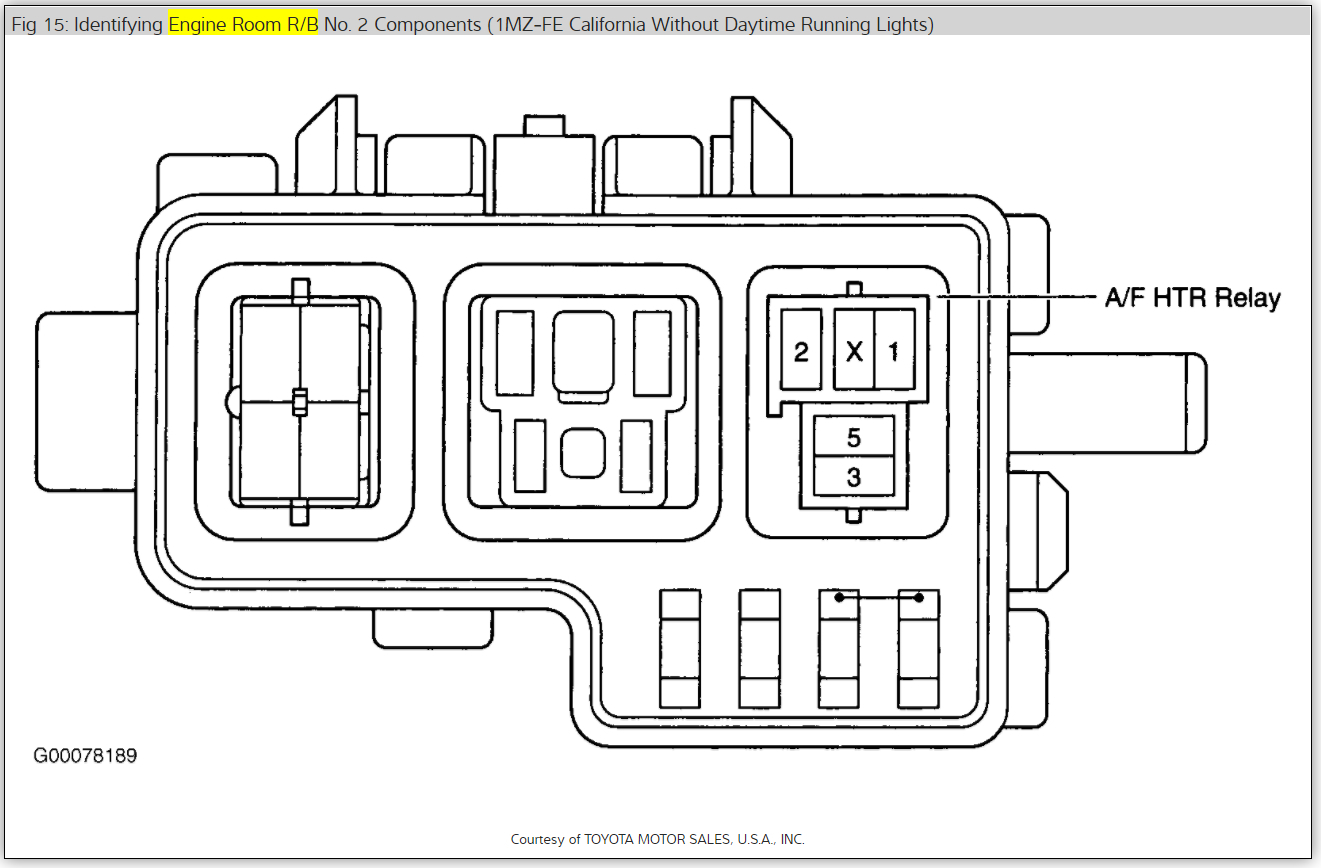

We need to check for codes, here is a guide that will help:
Also, have you checked the fuses? This guide will help with that and the fuse location or in the diagrams below along with the wiring diagrams for the transmission so you can see how the system works:
