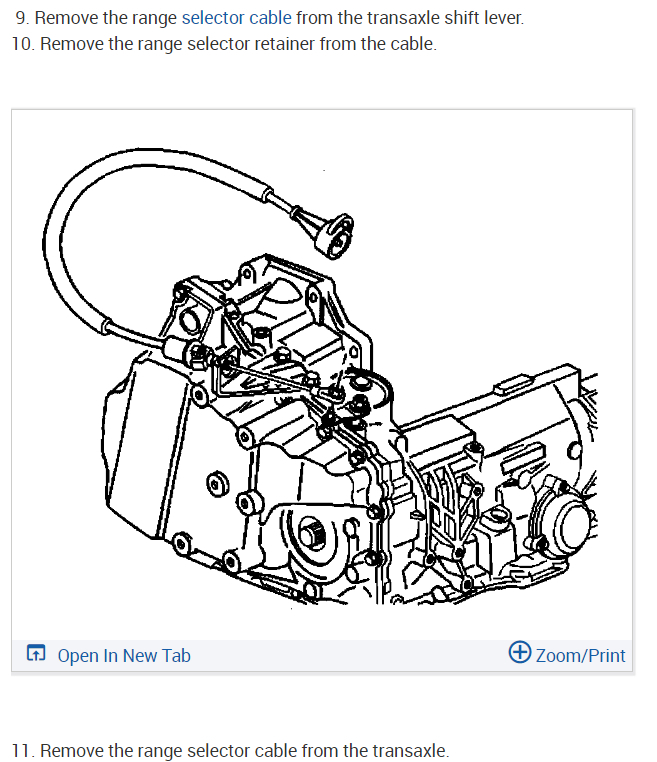

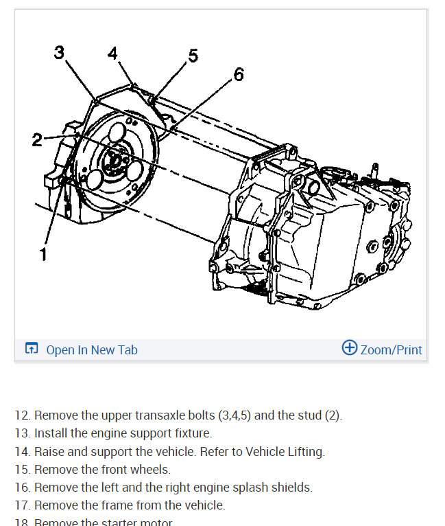

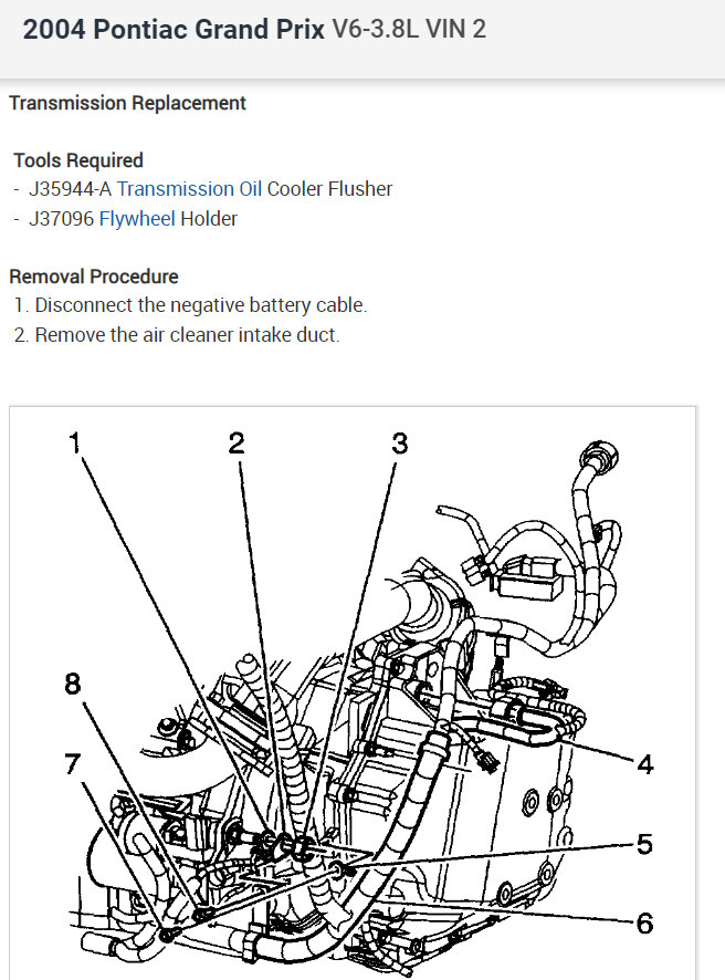

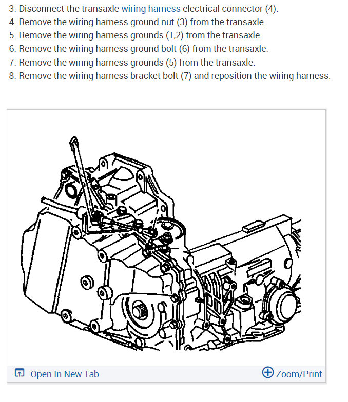

My car won't shift to drive and reverse from park. Sometimes it will shift when I cut the car off and on and try it again. The transmission fluid level is full. When it does actually change gears it drives for a short distance and then stops.It was working fine yesterday and just happen all of a sudden
Feb 21, 2015 at 2:23 AM
HMAC300
  • 48,601 POSTS
Yep, this happens when the transmission torque converter fails apart internally. The transmission will need to be removed, here is how and a video to show how to change it out.
https://youtu.be/ZC7xHVMKLRw?si=P2dOuyOiMekpnN_d
Check out the images (below). Let us know if you need anything else.
