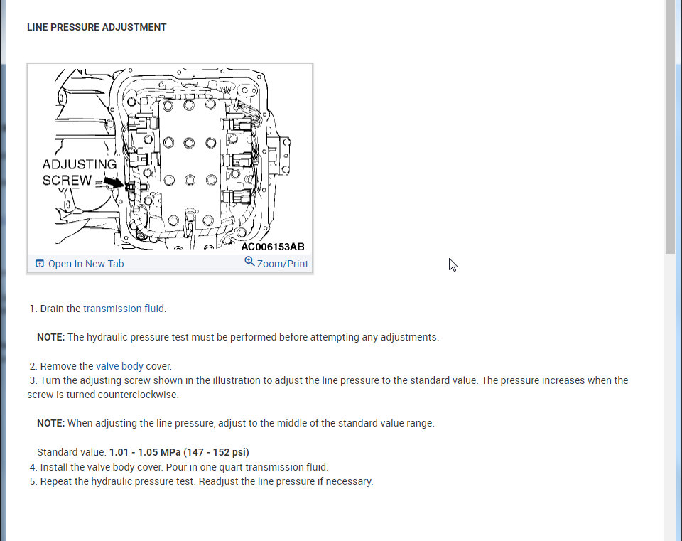

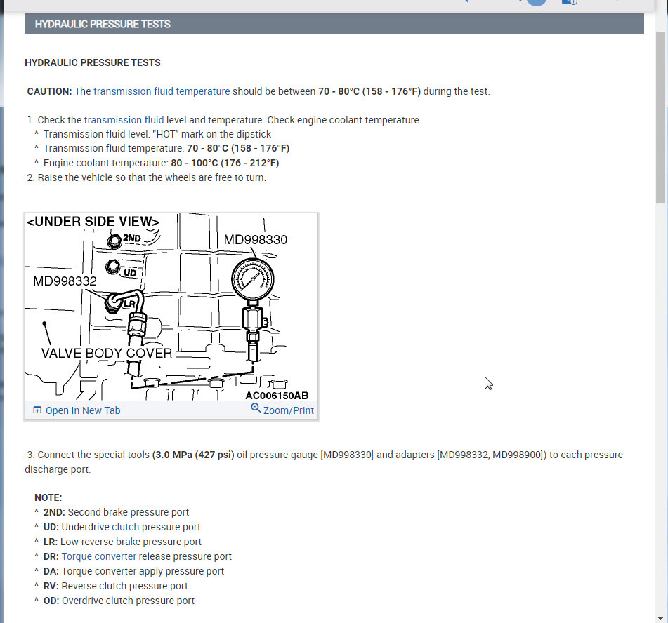

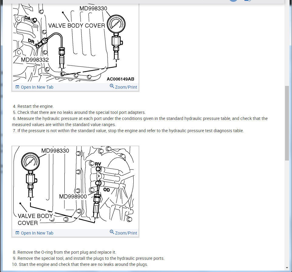

The next step if there are no codes is to check the pressure. This is not an easy thing to do but would be what we need to find out. I attached the process for your review.
