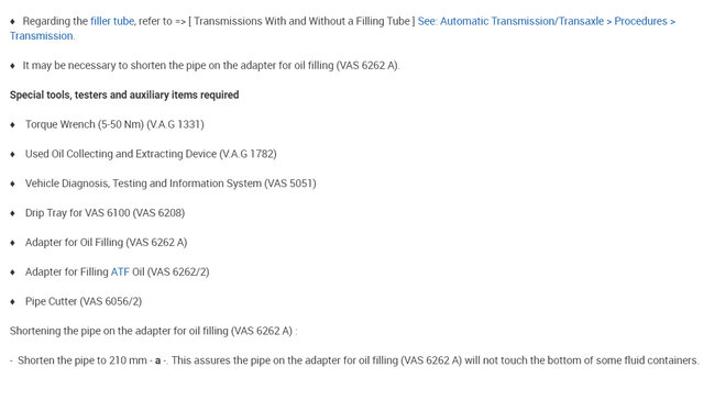

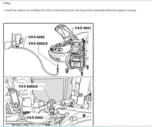

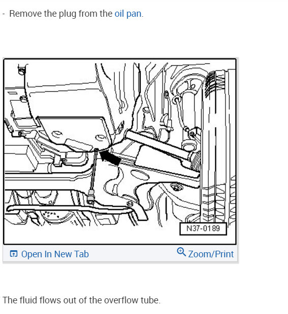

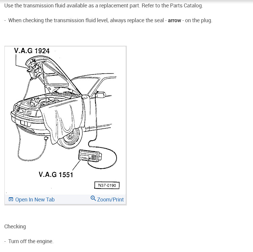

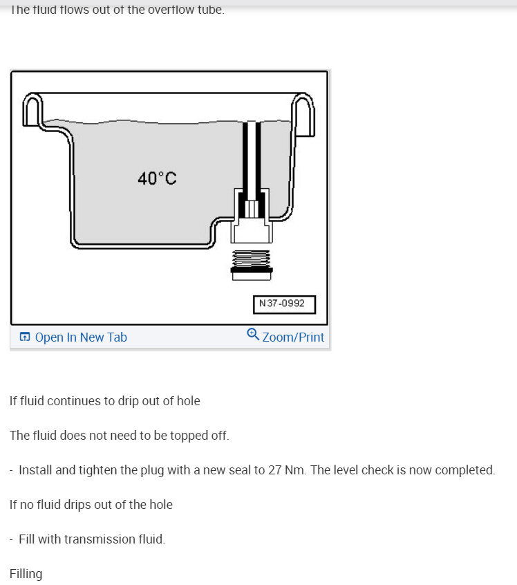

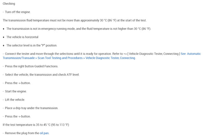

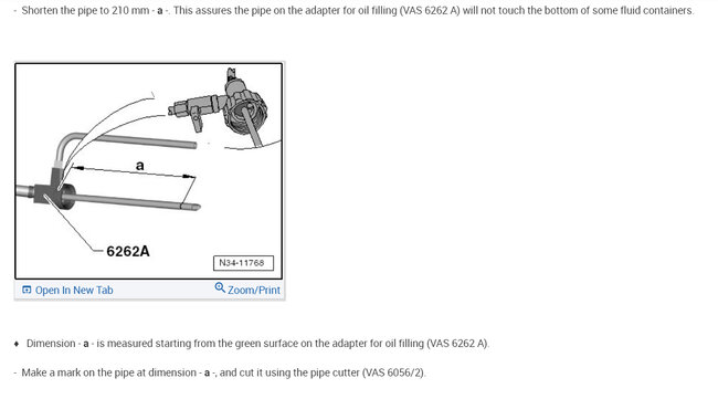

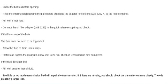

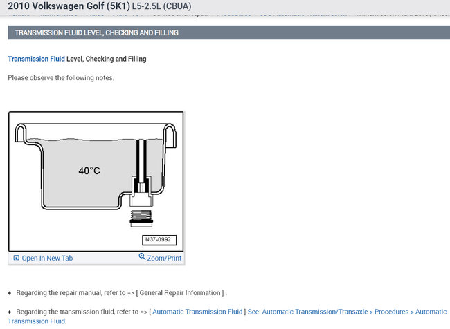

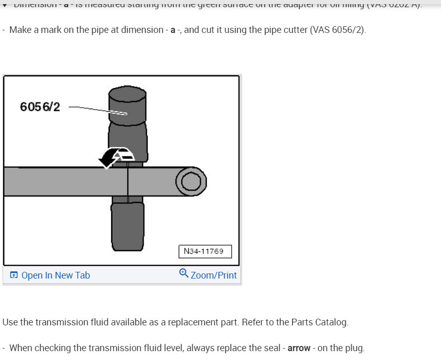

Can you please shoot a quick video with your phone so I can hear the noise? That way I can tell for sure what's going on. You can upload it here with your response. I would start by checking the transmission fluid. Here is a generic guide to help you step by step with instructions in the diagrams below to show you how on your car:
https://www.2carpros.com/articles/how-to-check-and-add-transmission-fluid
Transmission Fluid Type
VW part number .................... G 055 025 A2
Note: Transmission 09G
Also, we should run the codes to see if anything is stored.
