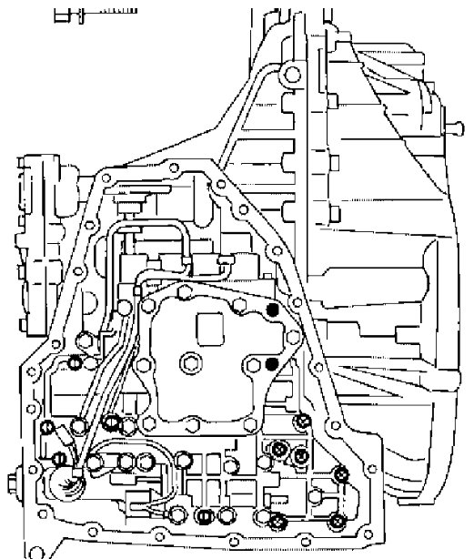

gear stuck while driving
2003 NISSAN WINGROAD
70,000 MILES • 1.5L • 4 CYL • 2WD • AUTOMATIC
ASANKA
while driving in slowly (twenty km/h) in first three km's gear stuck to some position and car revs up when accelerating but not gear changed and still moving slowly. No engine mil pop up.at this situation, nothing happens if I change gear selector lever and the only solution is the engine restart with the gear lever in neutral position. Then everything is okay and no more trouble with in traffic or slow driving again. This happens in once a day. Several attempts were done with obd scanner, but no DTC found out.
Thank you
Jul 10, 2017 at 3:21 PM
HMAC300
  • 48,601 POSTS
Your problem may be in the valve body or governor on this. but, a mechanic should see if any monitors for TCM are screwed up and should be manually seen if it will shift there is a protocol to go through steps to see the problem, but should be left to a transmission specialist. We do not have that model in US so it may be a little different than ours.
