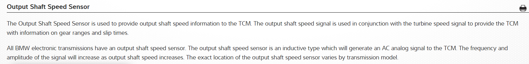

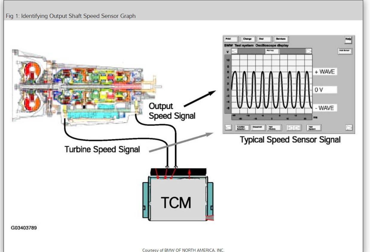

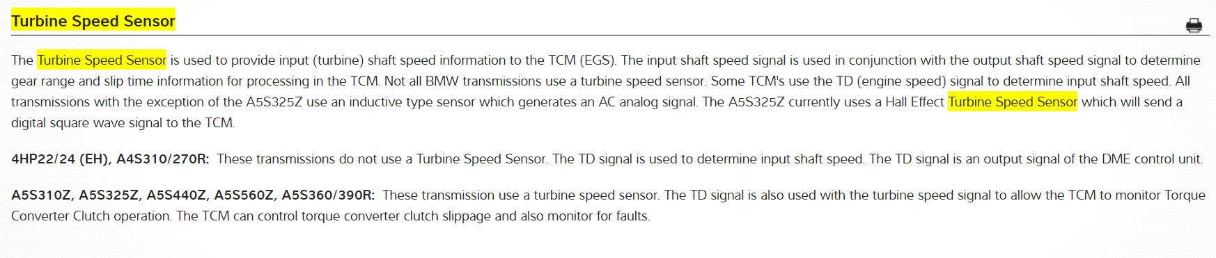

To me it sounds like the electrical plug to the transmission needs to be cleaned, if that's okay let's change out the turbine sensor. here are instructions and diagrams. Check out the diagrams (below). Please let us know what you find. We are interested to see what it is.
