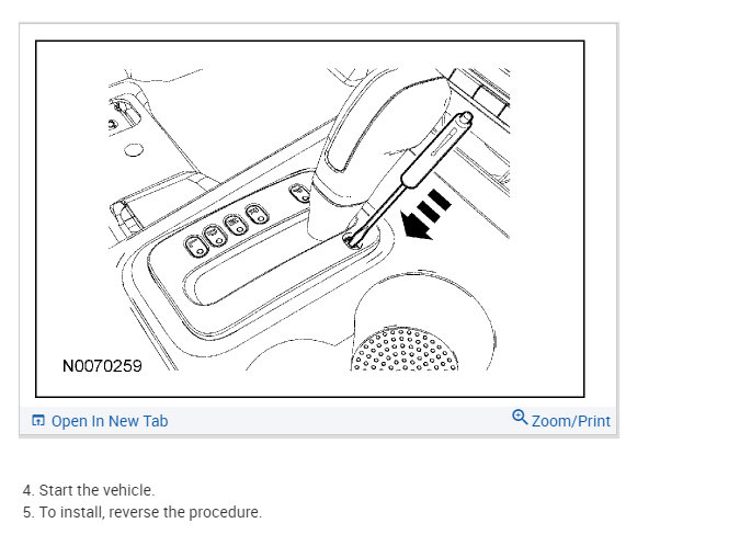

Won't come out of park when the brake is on and started.
Jul 31, 2022 at 7:06 AM
SQM
  • 6,383 POSTS

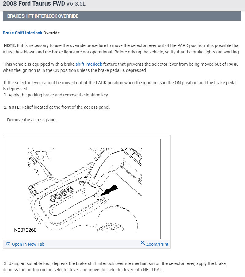

This could be due to a faulty shift interlock solenoid.
There is a way to over-ride it.
You will see a small cover on the base of the shifter, remove it and press down with a small screwdriver while the engine is off. This will allow you to put it in neutral and start the engine.
I have attached the procedure below.
Let me know if this works for you.
