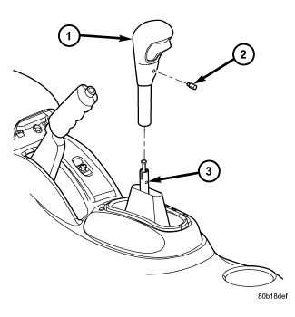

Got home, put the gear shifter in park and took my foot off the brake. Seemed like the car was moving. It was slowly rolling backwards. Look at the dash and the car is in reverse even though the shifter is in park. Shifter won't move. Brake won't depress. Turned the car off and tried to restart. Wont start.
Mar 10, 2021 at 12:53 PM
  • 110,240 POSTS
It sounds like the shift linkage is off. See if it will start if the indicator says neutral.

2. Remove the gearshift knob set screw (2) and knob (1).

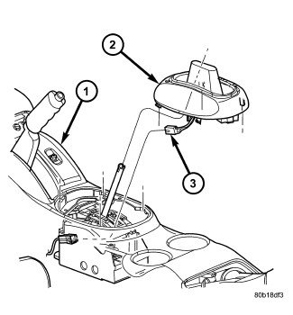

3. Remove gearshift selector bezel (2) and lamp wiring.

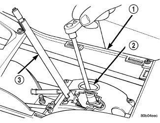

5. Place gearshift lever in the (P) Park position.
6. Loosen the gearshift cable adjuster nut at the shifter assembly.
7. Move the gearshift lever on the transaxle to the Park position.
8. Verify the shift lever and transaxle are in Park position. Tighten the gearshift cable adjuster nut at the shifter assembly. The gearshift linkage should now be properly adjusted.
