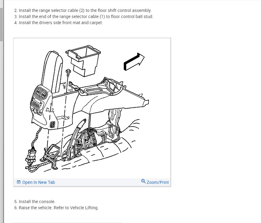

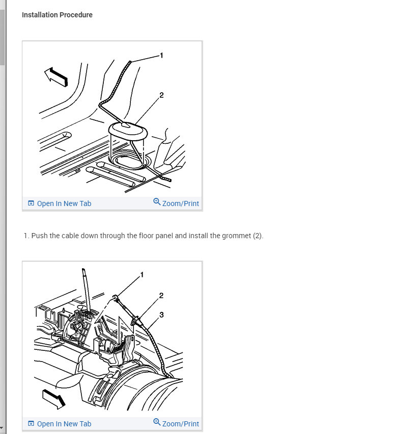

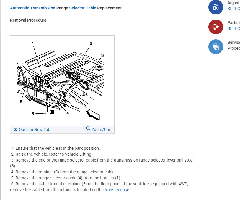

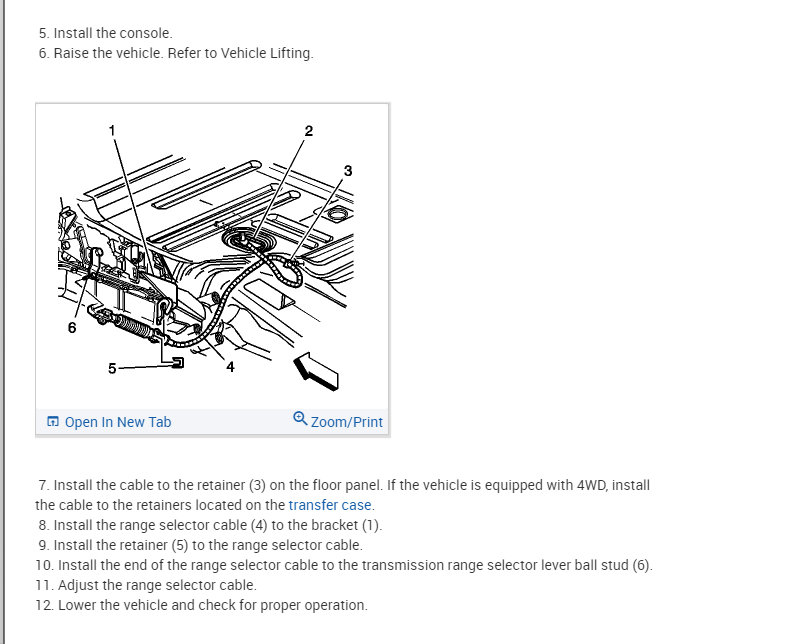

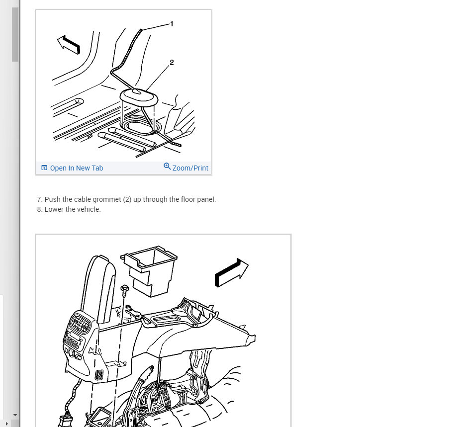

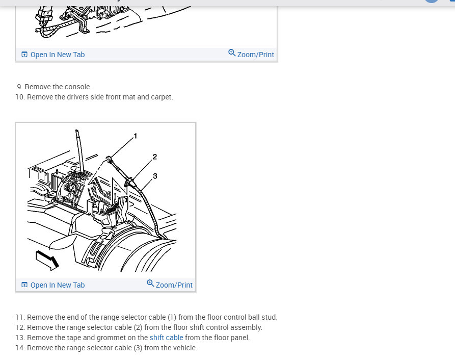

Got it. Thank you. Yes. I suspect you are correct that the gear selector that you move with your hand is moving but the selector on the side of the transmission is not moving.
That means the cable is broken or seriously out of adjustment.
I am attaching the info on replacing this cable, but I think the best course of action is to lay on the ground, have someone sit in the vehicle and keep their foot on the brake and shift the vehicle from park to drive/reverse. You will see on the side of the transmission where the cable attaches and this is called the transmission range sensor.
This is nothing more than a sensor that tells the PCM what gear the transmission is in. This cable moves the manual valve that goes into the transmission.
Let's just watch this and see if it moves when the shifter is moved.
If not, then we need to replace the cable. I will say that when this breaks the shifter normally will move very easily and not feel like there is any drag on it at all. If it does not feel like this, then it could just be out of adjustment but let's get there next.

There actually is an adjustment procedure but that is not going to fix this issue. If there is no resistance, then the cable or a connection broke so it will most likely need to be replaced.
Even if it just came unhooked, it will most likely do it again, so we are going to need to replace it.
