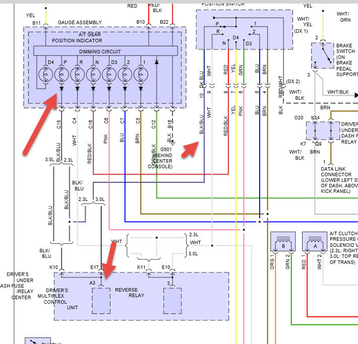

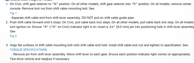

My transmission was just rebuilt and I have been unable to get it back on the road due to an issue that I cannot seem to resolve. I replaced the Transmission Range Switch/Neutral Safety Switch with a brand new TEC one from the Honda Dealership. I am going to exactly explain what I am having issues with. First I have the gear selector cable disconnected from the gear selector inside the car and where the console was until I removed it to try to adjust the cable. I installed the new NSS with it in neutral and the transmission in neutral. When I turned the ignition on, the indicator light in the dashboard indeed showed it was in neutral. I then pushed the cable up one click and it displayed it was in reverse and the reverse lights were on. I pushed the cable up into park and the park light indicator did not display and the car would not crank either. I pulled the cable out one click, and again was in reverse and it displayed correctly. Pulled again one click out and it displayed neutral correctly. Went down through the gears and each one displayed the correct gear it was in. So I am in gear one and going to go back up through the gears by pushing the cable back up, one gear at a time. When I go from first to second, gear second does not light up in the gear indicator display but it still shows in gear one. I am actually in gear two at this time. I go up another click and it displays gear two, but I am in gear D3. I go up another click and it displays D3, but I am in D4. This remains the same all of the way up, one gear behind what is actually displaying. When I get back into Park it does not display. There is no cable adjustment because I have the cable disconnected and I'm manually pushing and pulling it through the cable sheath to change the gears. I know it is not the Transmission Range Switch/Neutral Safety Switch because I just replaced it with a brand new one from Honda. If you could direct me to the problem so that I can fix it, I would Greatly appreciate it. Thank you very much! Dan

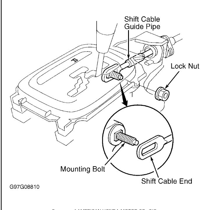

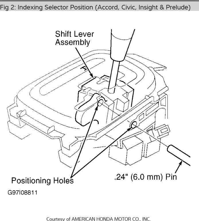

scan for codes it may be a TCM or a wiring issue /connection. see pictures for adjustment procedure.

I have scanned for codes and the scanner shows no DTC's stored in cars computer. Also this problem occurs without the shift cable being connected to the gear selector. I am manually pushing and pulling the shift cable by hand going through all of the gears. I have the same issue when the shift cable is connected to the gear selector and properly adjusted. I have read where it could be burned diodes in the TCM. What steps should I take at this time with no codes showing? Thanks.

You can try a new TCM but it may have to be programmed to your car or check the wiring to see if it has a good ground or maybe a short in wiring between TCM and switch. looking at the wiring diagram it uses the multiplex unit so that could be bad from switch and ground is in center console. it should not have any more than 5 ohms per wire. i am not sure if multiplex unit is sold separately.

If I may jump in here, it sounds like the cable could be bad causing the problem you have described. Can you work the transmission in and out of all gears without the cable connected?

I believe it was the "gear range sensor" but let's see if they respond. If you go over the wiring diagrams in the post above, you can see how the system works.

KEN L, I had a similar issue, and the mechanics got it fixed by adjusting the shifter cables and the new NSS to correspond with the gear selection on the instrument cluster, the selected gear on the lever, and the selected gear on the gearbox. My car still blinks D and shifts erratically in drive mode or just revs. I'm hoping replacing my shifter solenoids fixes the issues with my drive shifts.
