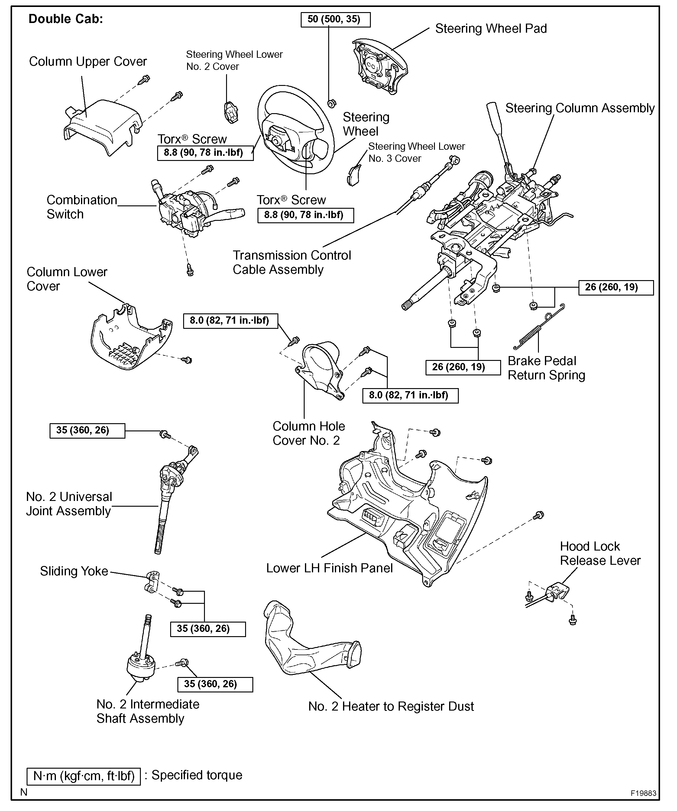

Gear shift lever moves freely up and down
2005 TOYOTA TUNDRA
202,000 MILES • 4.7L • V8 • 2WD • AUTOMATIC
KAISER2JT

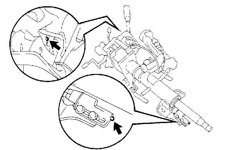

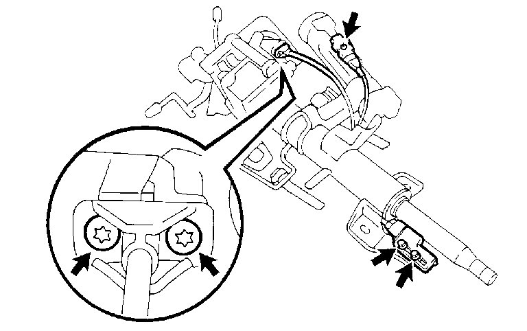

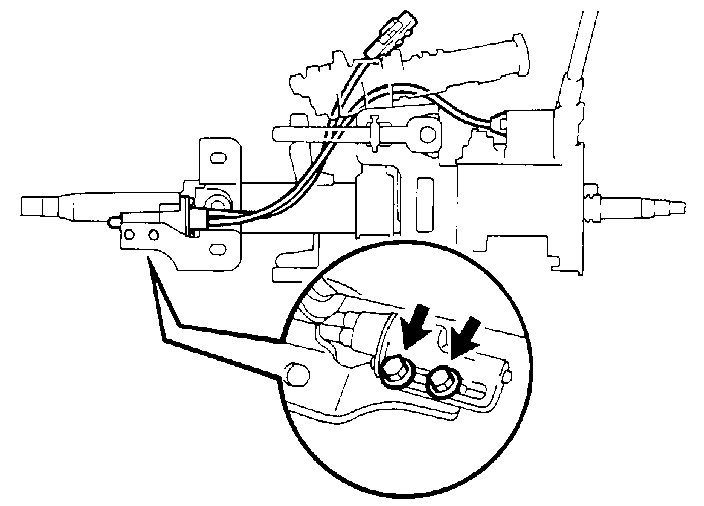

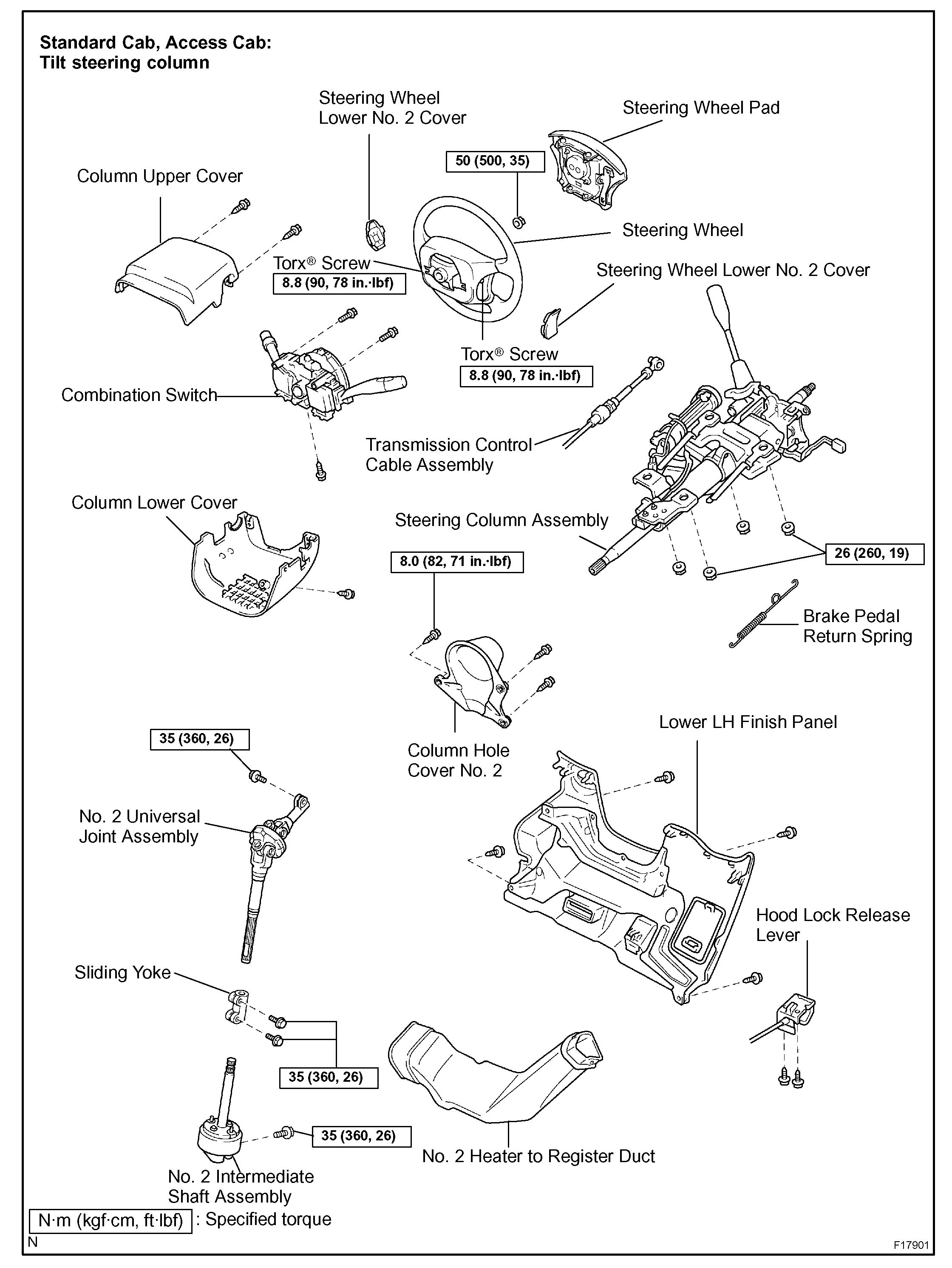

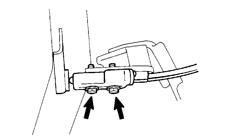

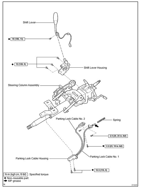

I was attempting to place the truck in drive but when I got to neutral seems like something became disconnected. It's in neutral but moving the gear shift will not engage.
Sep 29, 2019 at 1:47 PM
  • 110,194 POSTS
Welcome to 2CarPros.
Take a look through these directions. They are for cable replacement. You will need to inspect the locations indicated in the attached pictures, which correlate with the directions to see if something is disconnected or broken.
_____________________________
2005 Toyota Truck Tundra 2WD V8-4.7L (2UZ-FE)
Column Shift Assembly
Vehicle Transmission and Drivetrain Automatic Transmission/Transaxle Shift Linkage Service and Repair Procedures Column Shift Assembly
COLUMN SHIFT ASSEMBLY
pic 1
pic 2
pic 3
pic 4
COMPONENTS
REMOVAL
1. REMOVE STEERING COLUMN ASSEMBLY
pic 5
2. REMOVE PARKING LOCK CABLE ASSEMBLY
a. Remove the screw and cable No. 2.
b. Using a torx socket wrench, remove the 2 screws and cable No. 1.
c. Remove the spring.
d. Remove the 2 bolts and parking lock cable housing.
3. REMOVE SHIFT LEVER
a. Disconnect the connector.
b. Using a torx socket wrench, remove the torx screw and shift lever.
4. REMOVE SHIFT LEVER HOUSING
Using a torx socket wrench, remove the 3 torx screws and shift lever housing.
