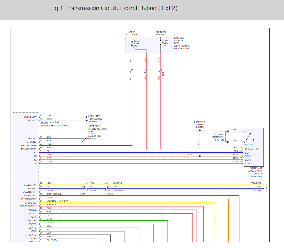

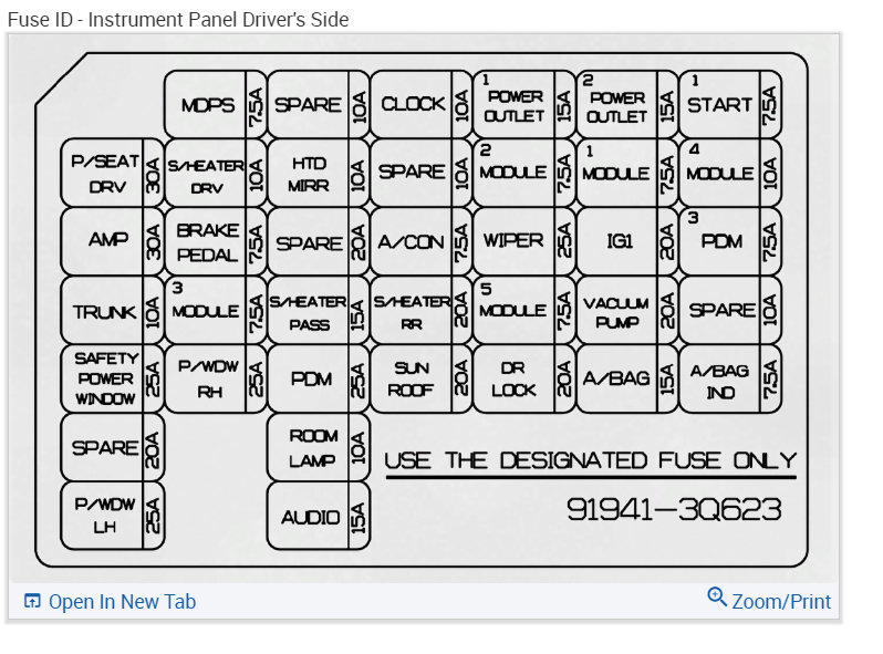

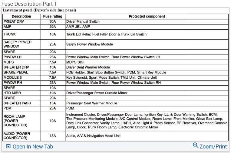

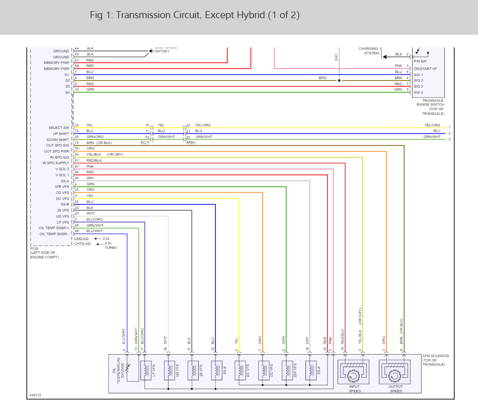

Last night I was driving on the freeway and my gear was reading (D-drive) as it should. Well as I was driving for a period of time I do happen to look at my speed and where it shows the gear functions; it’s blank. I immediately pull over to the median and put it park, still not reading proper gear. I turn the car off for a couple of seconds and turn back on and it’s reading? That’s dangerous especially in a lot of traffic, which can cause a serious accident.
Jun 30, 2019 at 3:13 AM
  • 55,443 POSTS

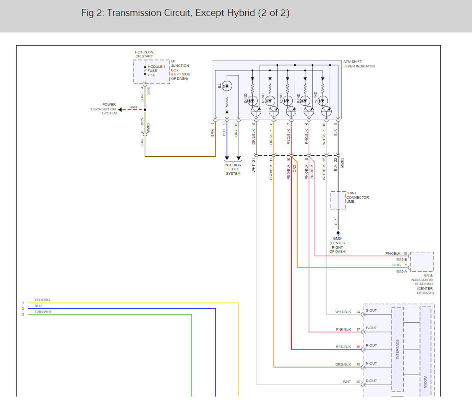

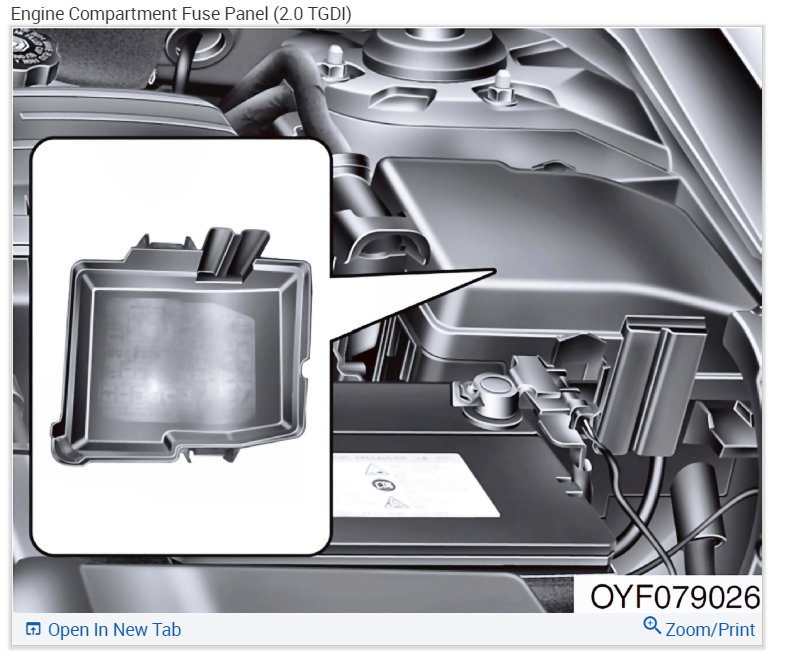

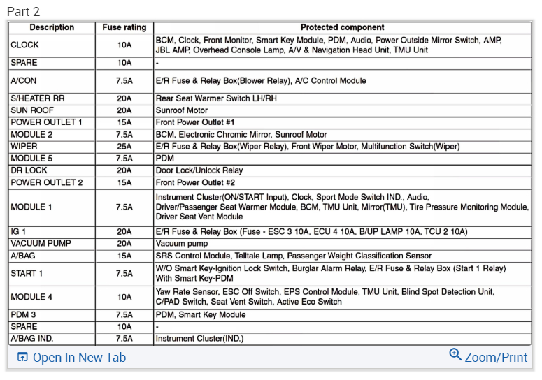

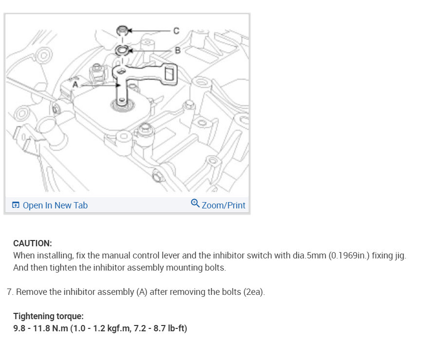

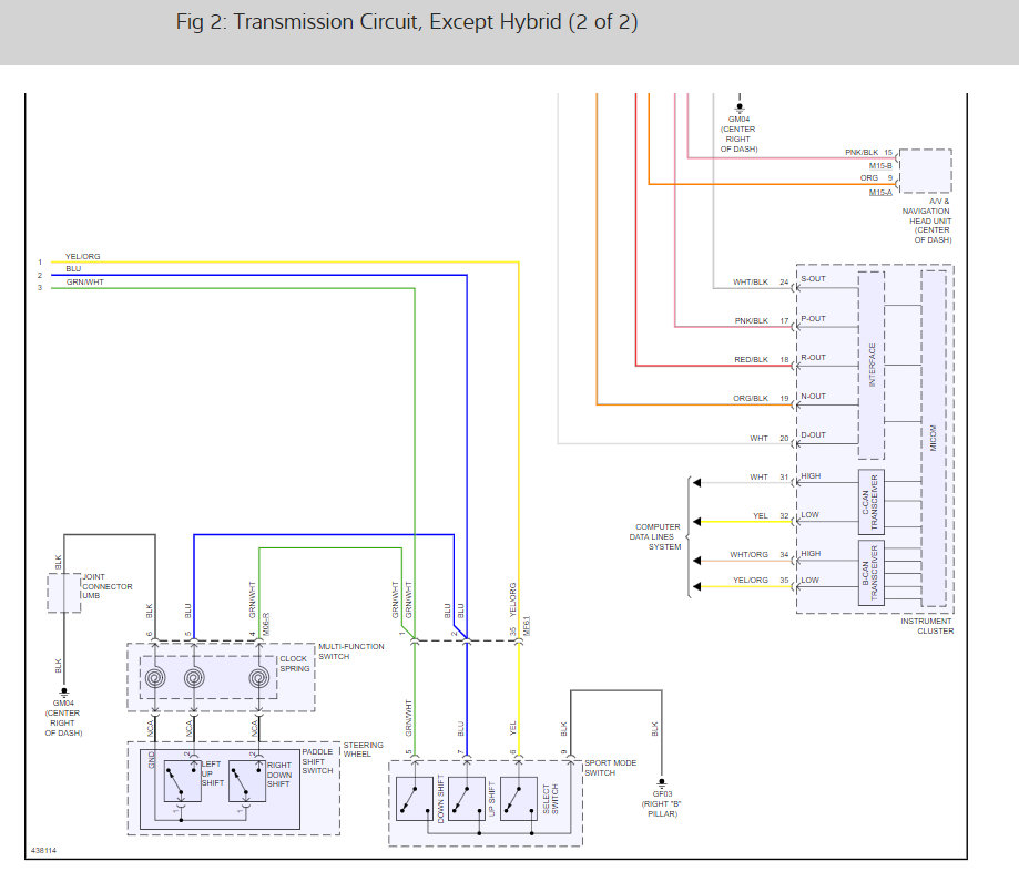

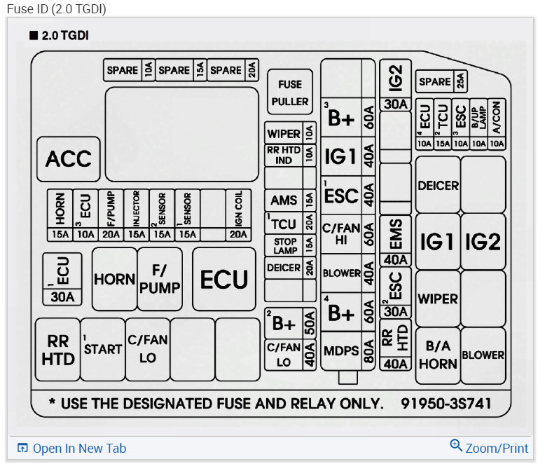

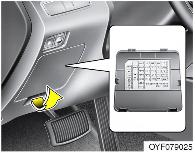

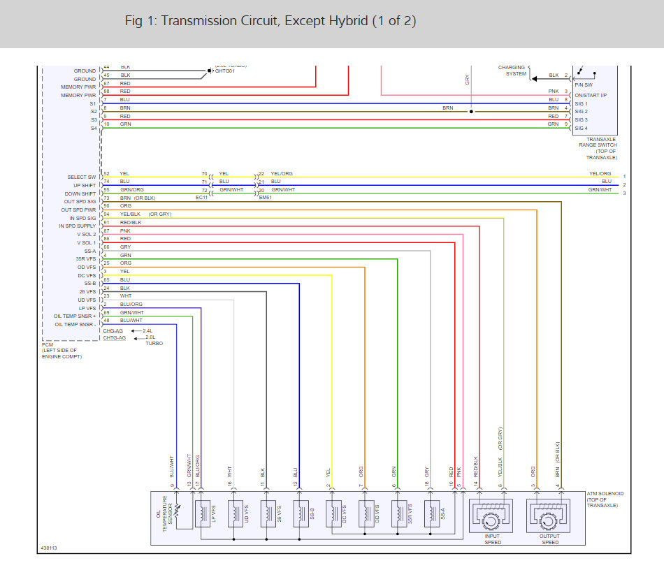

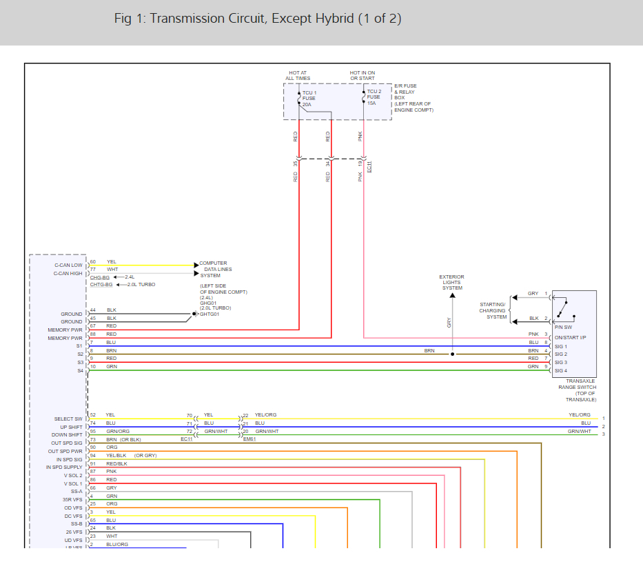

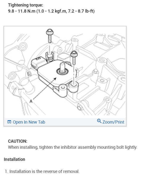

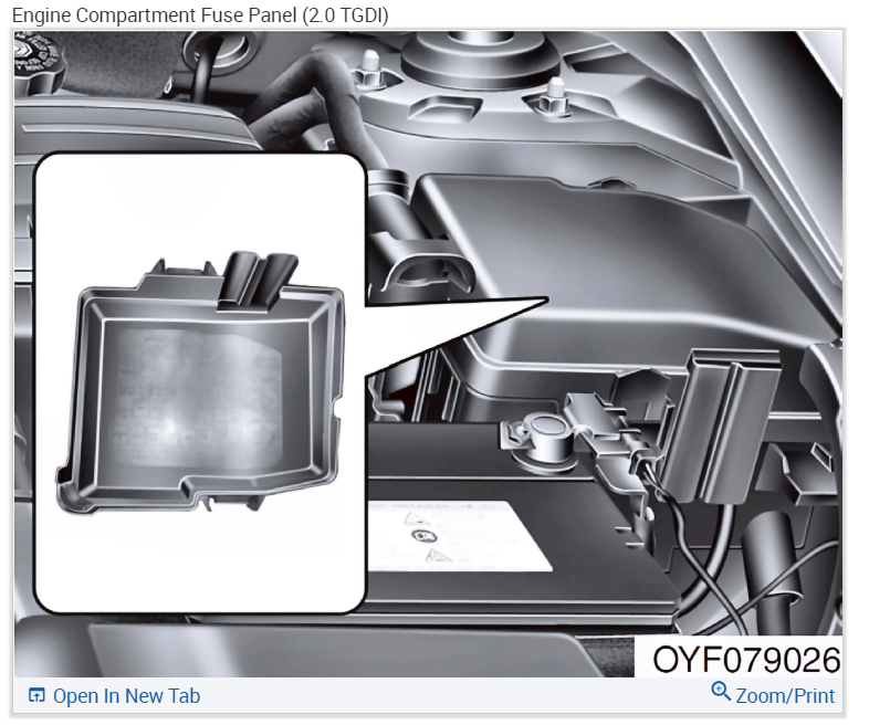

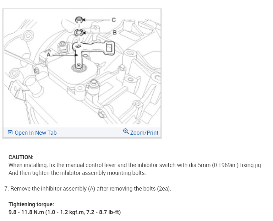

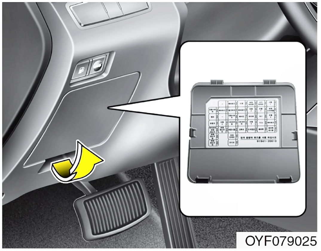

It sounds like you have a fuse (module 1, tcu 1 tcu 2) out or the gear range sensor/switch is not working.To be sure here is a guide to help you check the fuses and the transmission wiring diagrams so you can see how the system works and how to check the sensor out:
Jul 1, 2019 at 7:13 AM
TAE4ASU

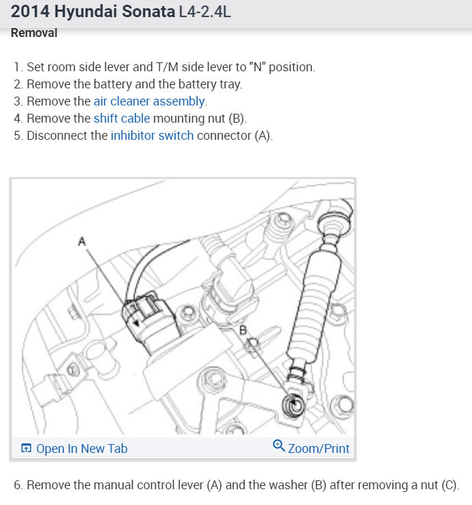

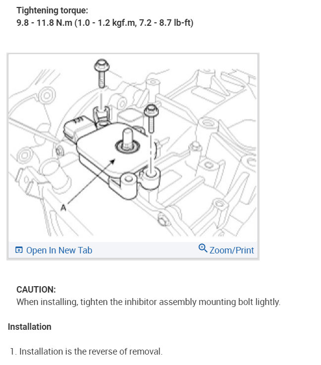

What is code is (P0706), this what came up when it first happened with the engine light on and then the next day the light went off, put the problem still happens. I looked it up and it stated transmission range sensor!!
Jul 3, 2019 at 2:41 AM
  • 55,443 POSTS
Nice work I have diagrams and instructions on how to fix it. Please let us know what happens.
