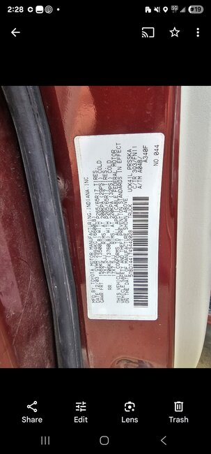

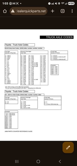

I have a 2004 Toyota tundra double cab 4d with 4wheel drive sr5 vin #5tbdt44174s44202b with axel code A04B Axel code and A340F transmission code series code uck41IL i need a new rear end it went out going down the highway luckily I was able to switch over to 4wd amd limping it home I need to know the gear ratio so I can get a new one I've looked all over online and always says something different.

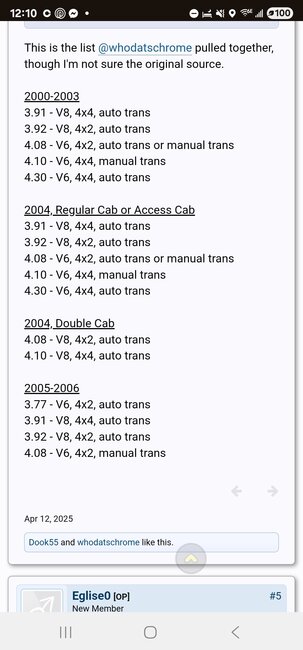

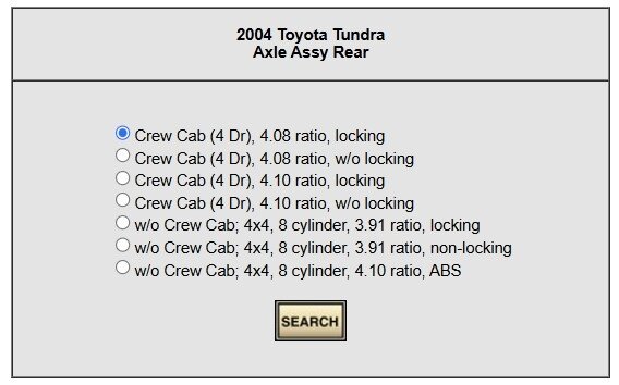

Well it looks like there are 2 ratios in the crew cab. 4.10 or 4.08 Then locking or non locking. Service info doesn't show the ratio just how to pull the third member out and replace it.
However you might want to give these folks a call - https://eastcoastgearsupply.com/
They can likely tell you what the gears are and might have a few tricks as well.
Is the image what you started with?

Im sorry VIN is 5tbdt44174s442028 and I thought it was a 4.3 is what one site says 4.556 is what another says i haven't see a 4.08.

Look at the third picture, Yours is the double cab, V8 4X4 auto Note the ratio for that? 4.10 That matches what I found in the interchange as well. Most of the info I see online applies to the vehicles prior to yours. The VIN doesn't show the ratio in service info so the best way would be to open it up and look at the actual markings.
