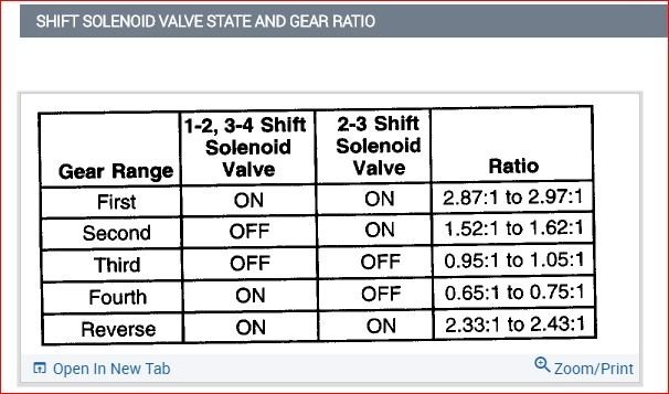

Need to find out my gear ration in my transmission by my VIN number.
May 18, 2019 at 6:03 PM
Hi Darc137,
Here is the gear ratio for this vehicle listed. I don't show any other options for transmission so you should have a 4T65-E.
Please let me know if this is different and I will look for what transmission you have. Thank you for using 2carPros.
