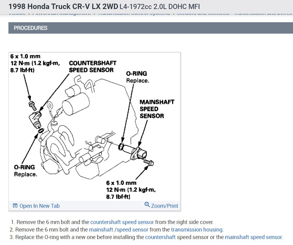

My vehicle listed above is a Mondle is not changing gears.

9 times out of 10 it will be the input shaft speed sensor. This video shows the job being done on a similar car but the process is the same. We should run the codes as well.
https://youtu.be/f3bETtCIdxM
and
Here is the location of the speed sensor (counter shaft sensor). Check out the diagrams (below). Let us know what happens and please upload pictures or videos of the problem.
