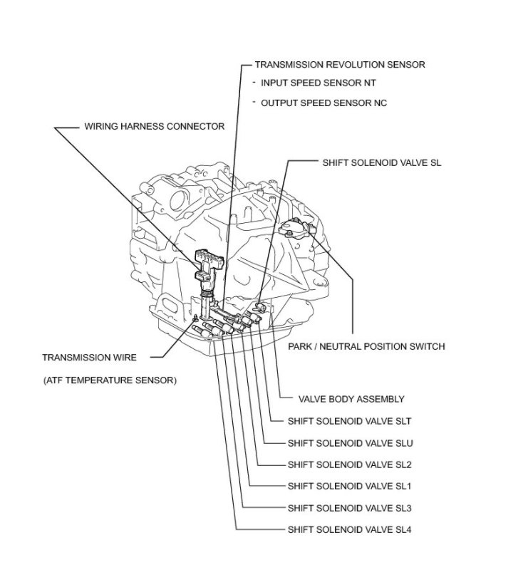

My car gear shift D after ten to fifteen seconds.

Try a new filter and fluid change, perhaps the filter is a bit clogged with debris from the clutches.

Change filter and fluid but did not work.

These cars had problems with the input shaft speed sensor for the transmission. Here is a video to show you what you are in for when doing the job:
https://youtu.be/f3bETtCIdxM
Here is the location for your car.

Was there a lot of debris in the pan that fell off clutch packs, etc?
