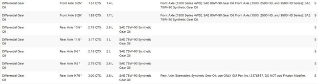

I have looked in my owners manual and it does not tell me how much gear lube it takes for the front and rear axle. Could you possibly tell me?
Thanks!
Apr 11, 2018 at 3:33 AM
MHPAUTOS
  • 31,937 POSTS
There are a number of different differentials used, this chart should help you work out what you need. Check out the diagrams (Below). Please let us know if you need anything else to get the problem fixed.
