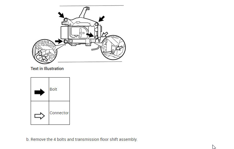

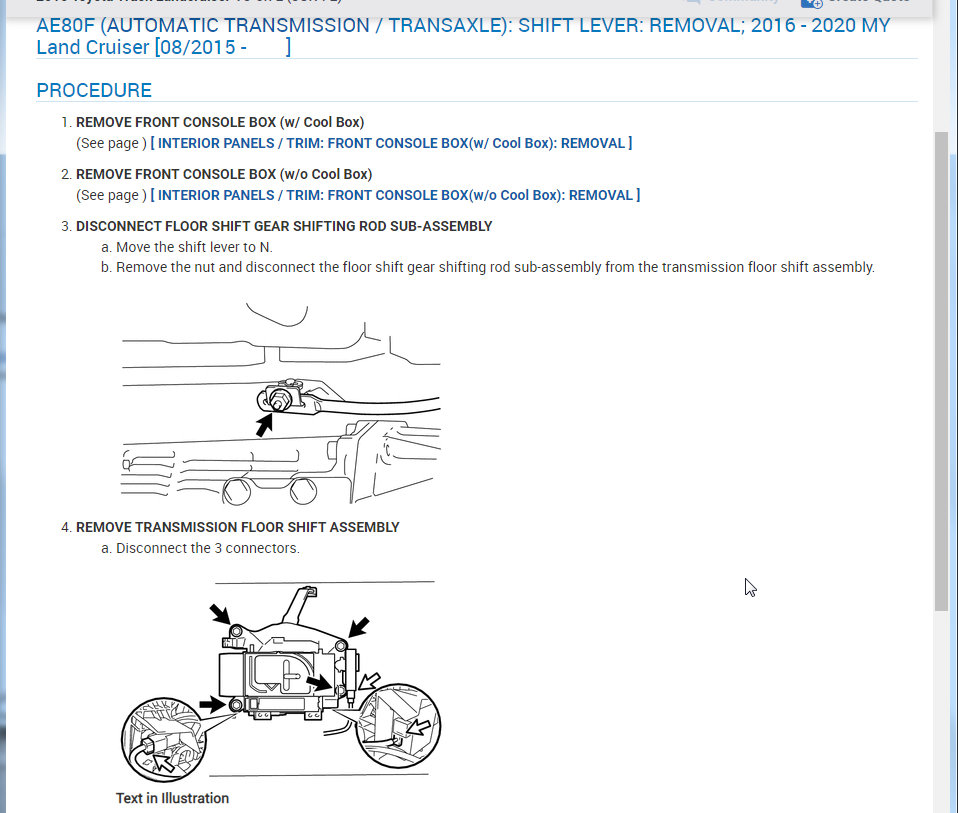

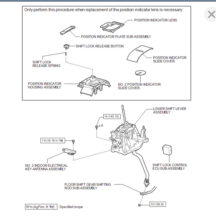

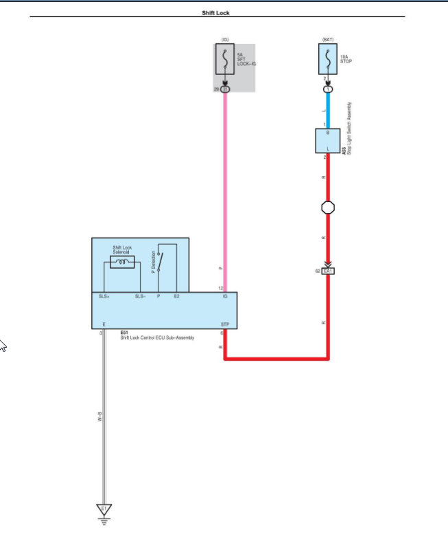

This is normally the shift interlock is not releasing so the shifter stay in park. Basically the vehicle needs to see the brakes depressed in order for it to release the shifter so we need to make sure the brake light switch is working on the pedal. Just press the brakes and make sure the lights come on.
If they do then the interlock on the shifter is the most likely issue. I attached the info on this for your review. I would just make sure the solenoid is getting power using the wiring diagram. If it is then the solenoid is the issue.
