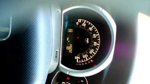

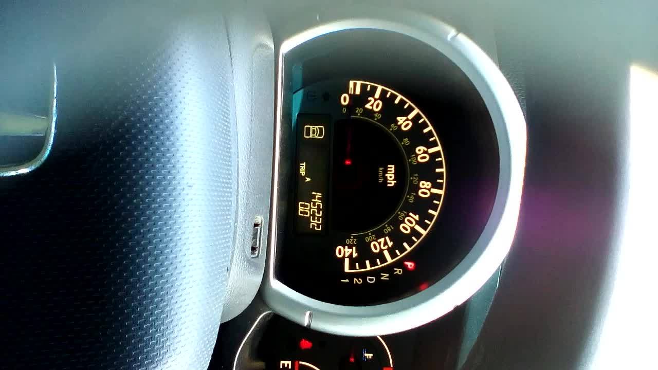

My gear indicator is allways on the p indicator is always red and it only turns off when I start my ridgeline and shift to any other gear
Apr 20, 2020 at 9:44 PM
Can you get a picture or quick video of what you are seeing? The reason I ask is I am thinking this is normal but seeing it will help figure out what is going on. Also, is this something that just started happening or did you just buy this vehicle?

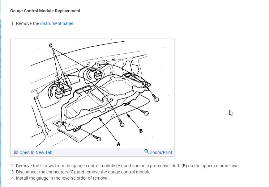

So the way this works is the cluster gets the signal about what gear the transmission is in from the range sensor on the transmission. However, it gets this signal from the PCM so there is no direct connection to the range sensor. I suspect the cluster itself is the issue because I have not seen any of these stay like this. However, before you replace this, let me reach out to a Honda dealer contact that I have an ask if they have seen this or if it is normal. Even though I have not seen them stay on, it may be the way they are so let's just double check that first.

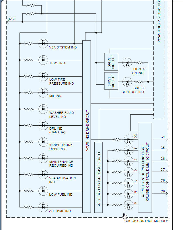

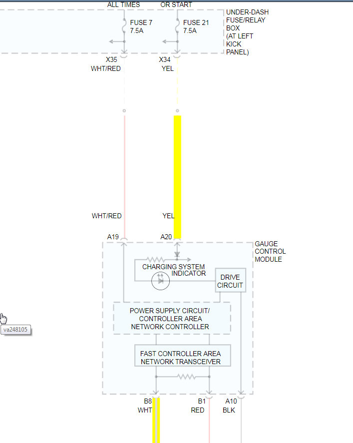

To fix this, I suspect the issue is contained in the cluster because it looks like the PRNDL lights are controlled by the drive circuit contained in the cluster.

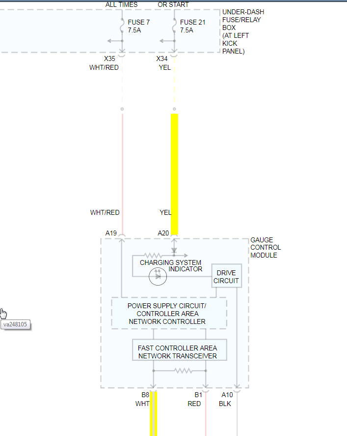

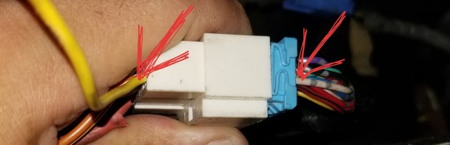

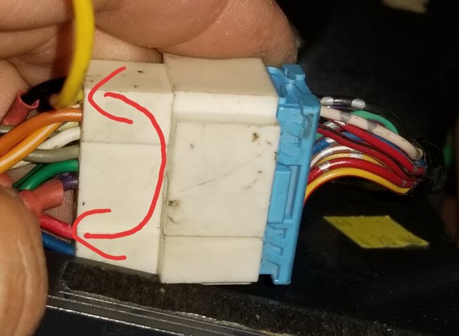

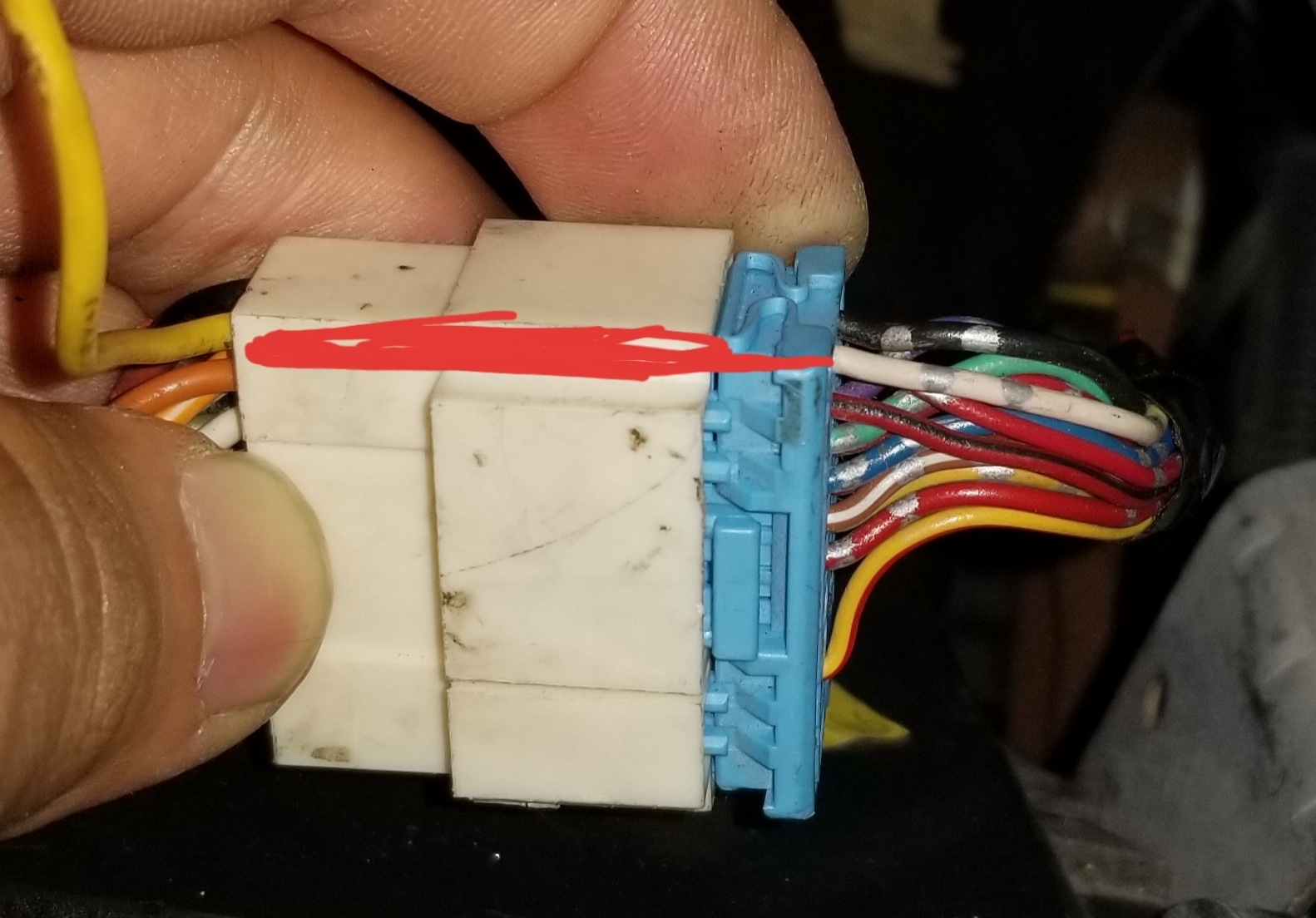

My alternator I'd bad going to replace it today and I thing I found the problem I removed my head unit and realized the a yellow wire was touching a live wire so when I separated my gear indicator when off not sure what the yellow wire for I didn't look.more into it.
May 1, 2020 at 9:56 PM
Amazing. If you can track the wire to one end or the other to see what component it is going to, we can figure out what it is.
Thanks for the update. I would love to figure out what wire that was. Great job!
May 2, 2020 at 11:39 AM
PEREZ415777
  • 13 POSTS
The yellow one was making contact with the red one; that is what was making my gear indicator lights to stay on.

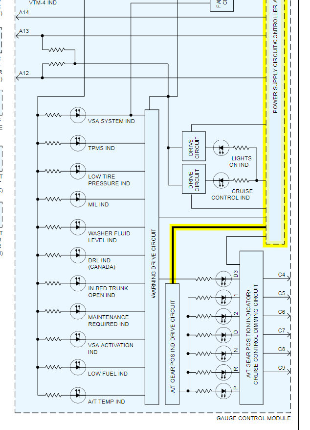

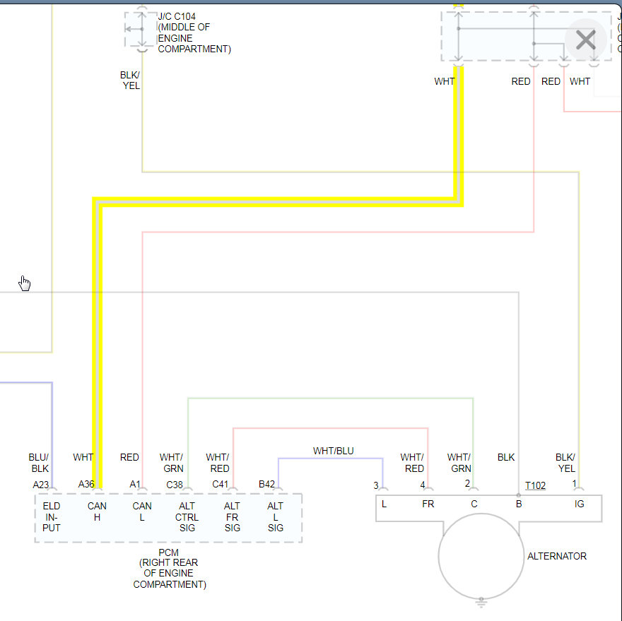

Thanks. so do I have a diagram of that hardness to see why that wire causes my gear indicator to light up?
May 8, 2020 at 12:32 PM
Yes. Sorry I forgot to provide that. It appears the white wire going to the PCM and is the CAN Hi line which if the voltage is off would cause the gauge to act up. Clearly the voltage was having the PCM illuminate the P all the time.
