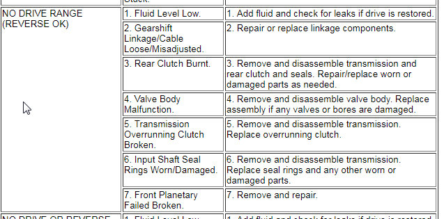

Van does not move when transmission is shifted into drive
2000 CHRYSLER TOWN AND COUNTRY
157,000 MILES • 3.3L • V6 • 2WD • AUTOMATIC
RAUL AVILA
I put it in drive, then it moves but then it does not move anymore. so I turn it off then start it again, then it will go to drive again and it moves a little then stops moving So I’ll do it all over again. but reverse works fine.

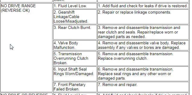

Hi Raul,
Here is the diagnostic flow chart for this issue. Please take a look at this and let me know if you have questions. It is pretty self explanatory but if you need help making a repair that you find as the issue, please let me know.
Thanks
