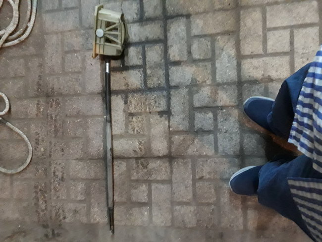

My Lapse 2000 when I try to get reverse speed and pull the spring left towards (as it usual) it does not shift to reverse, but something like first speed. To clarify, I own this car from year 2000 I never do anything to the gear unless lubricating

This is what have seen when moving shifter as sequence reverse,1, 2, 3,4, 5.

Thanks for he video. I can see some hoses getting in the way of the shifting. When the shifter is in reverse try to push the gear selector on the transmission further to see if you can get it in reverse this will tell us if it is a transmission problem or the shifter cables. Please let me know.

Yes, when I pushed the levers to shift I got the reverse and car moved reverse.

The problem solved by changing these parts.
