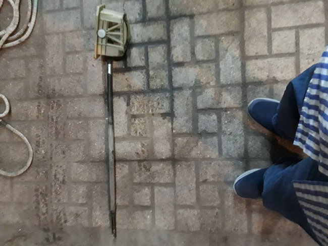

My Lapse 2000 when I try to get reverse speed and pull the spring left towards (as it usual) it does not shift to reverse, but something like first speed. To clarify, I own this car from year 2000 I never do anything to the gear unless lubricating

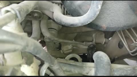

If the cables are warn they will not position the shift lever to get reverse. Can you have someone move the shifter while you look under the hood with a flashlight to see what it happening?

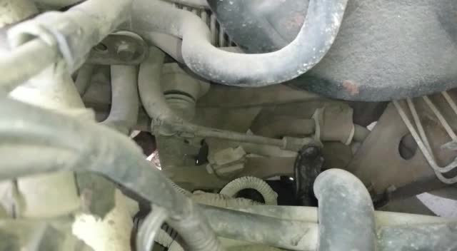

This is what have seen when moving shifter as sequence reverse,1, 2, 3,4, 5.
Aug 27, 2018 at 12:06 AM
  • 55,214 POSTS
Thanks for he video. I can see some hoses getting in the way of the shifting. When the shifter is in reverse try to push the gear selector on the transmission further to see if you can get it in reverse this will tell us if it is a transmission problem or the shifter cables. Please let me know.
Aug 27, 2018 at 3:44 AM
AHMEDMANSOUR
  • 6 POSTS
Yes, when I pushed the levers to shift I got the reverse and car moved reverse.
Aug 27, 2018 at 5:45 AM
AHMEDMANSOUR
  • 6 POSTS
Thanks a lot.
The problem solved by changing these parts.
Aug 27, 2018 at 8:36 AM
  • 55,214 POSTS
Glad you could get it fixed, that kind of problem can be tough. Please use 2CarPros anytime we are here to help.
