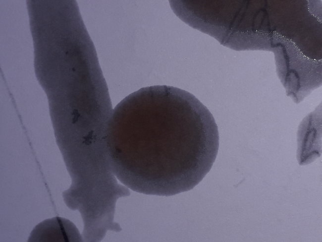

When this problem started up a few years ago and some 10,000 miles ago, I had the oil changed out.
It still looks clean, that pink color of ATF and smells the same as out of the bottle.
the attached photo is a few drops on white paper.
I do not understand what is a "cut seal" in your reply. Are you talking about a shaft seal that is broken and leaks oil? if so where?

So if you have this issue that the vehicle just revs up until you return to an idle then that points to this pressure issue that I am talking about.
If it is not the fluid then that means most likely there is a seal internal to the transmission that is cut and not holding pressure when it is supposed to.
This is not an external leak just a seal on what is called a drum or piston on the inside of the unit.
Basically there are about 4-5 clutch packs and drums with pistons and they all have seals on them. So when you need first gear you apply one combination of clutches and then second gear is a different combination. Each combination will result in a different gear ratio which is how the transmission shifts through the gears.
Take a look below at a cut out of a transmission and you will see the clutch packs. Then the next picture is of one of these pistons where they are showing a seal.
If one of these seals is cut then when it is supposed to be holding pressure it won't and that prevents the gear from engaging.
Imagine trying to water a garden with a hose that has holes in it. You have no pressure at the nozzle because you are loosing it all out of the holes in the hose.
If there are no codes and it just neutrals out, then unfortunately if it were me, I would remove it and go through the unit inspecting this and the valve body for issues. Especially if this has been happening for this long and it progressed to this point. It sounds like it has finally failed.
