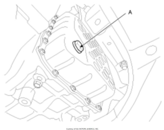

Dears,
Kindly help me. How do i change my gear box oil ?

There is a drain at the bottom of the transmission pan. If yours doesn't have a drain plug, the pan will need removed. Do it slowly so the ATF doesn't go everywhere. Once it's removed, drained, and a filter is replaced, reverse the process. NOTE: Do not overfill the transmission and make sure to use the correct fluid. See your owner's manual if you have questions.

It doesn't has a drain and no way to know the oil level not like the engine

If you have a video how to do it i will be greatful to you, thanks for you reply

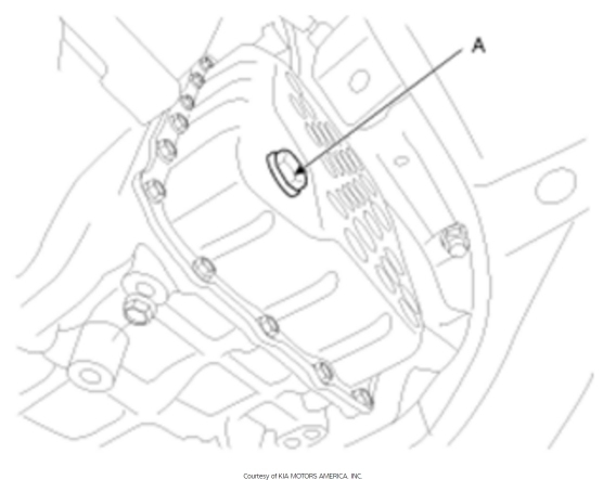

Hi, I found this for you, it looks like you have a plug in the side of the cover that determines the oil level
Let me know what you find out
