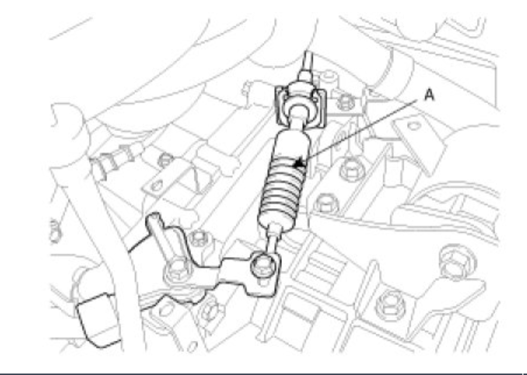

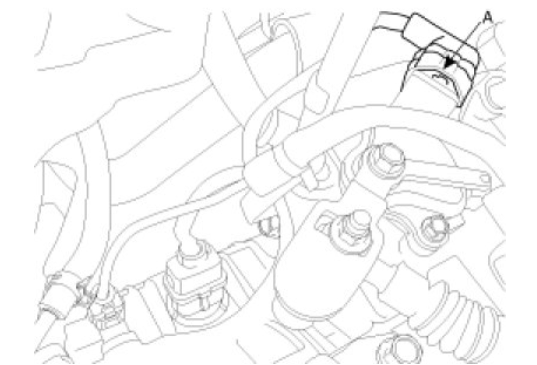

My transmission will not engage any gears. it's a 6 speed semi automatic box. it drove then wouldn't engage any gears at all not even reverse. I really need help solving this problem.
Thanks

Have you checked the fluid condition and level? Does the gear indicator show the correct gear selected? Since it won't do anything, my first suspect is there is a problem with what is called the range sensor. However, very low fluid can cause it as well.
I attached a pic of the range sensor. This is what tells the computer what gear has been selected. If it doesn't work, the transmission will not engage.

Didn't work, tried both of what you suggested.
Jan 25, 2020 at 12:07 AM
  • 110,240 POSTS
Okay, then if I understand, regardless of the gear selected, the indicator is incorrect or not working.That would lead me to believe the range sensor itself has failed or you are no longer
Here are directions for replacing the range sensor. Now, before you just replace it, have a helper shift through the gears so you can confirm the linkage cable is connected and moving the shift lever. Also, make sure nothing is disconnected as far as the wiring.
Here are the directions. The attached pictures correlate with the directions.

5. Disconnect the inhibitor switch connector (A).
pic 1
6. Remove the control cable(A) from the manual control lever.
pic 2

4. Install the control cable (A) to the manual control lever.
pic 3
5. Connect the inhibitor switch connector (A).
pic 4
