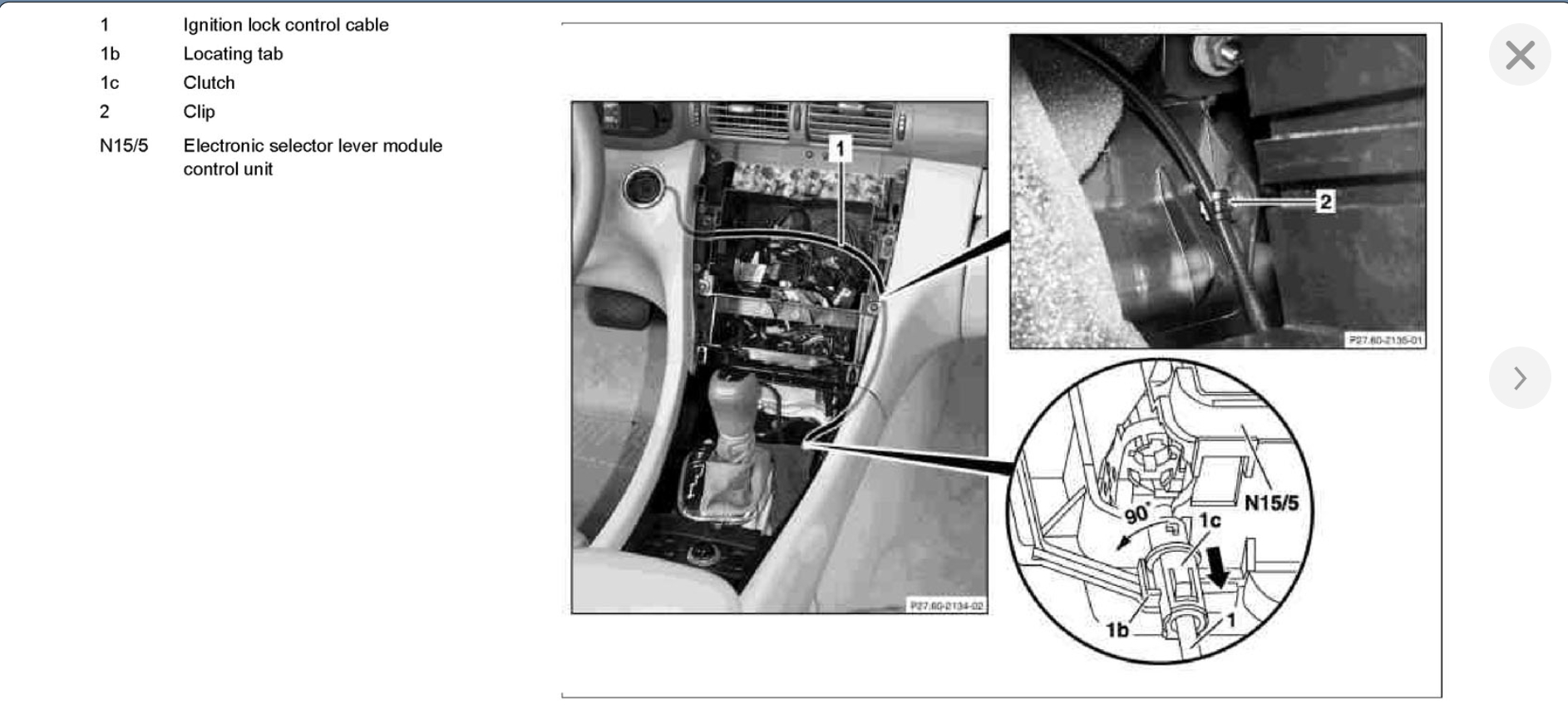

Car goes into drive and reverse, but it will not go into park until ignition is off.
Jul 16, 2018 at 6:12 AM
  • 55,746 POSTS
When you say it will not go into park do you mean the gear selector will not go into park or the gear selector goes into park and the car keeps rolling?
Please let me know, Ken
Jul 18, 2018 at 6:27 AM
ANTHONY SMITH4
Gear selector will not go into park unless car is turned off.
Jul 18, 2018 at 7:07 AM
  • 55,746 POSTS

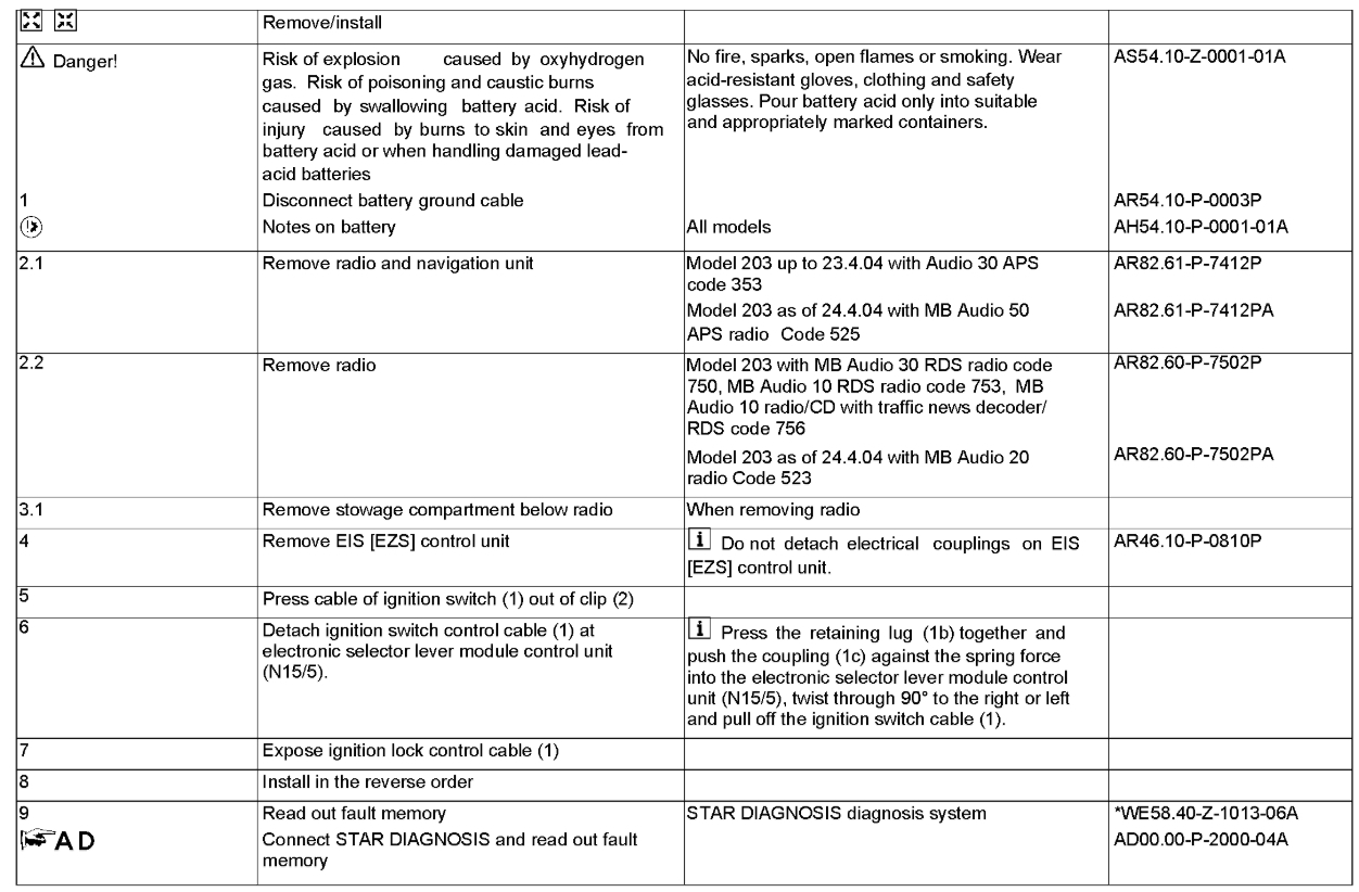

There is a shift interlock cable that sounds like is misadjusted are is not working right here is a guide to show you what to look for so you can find the problem.
