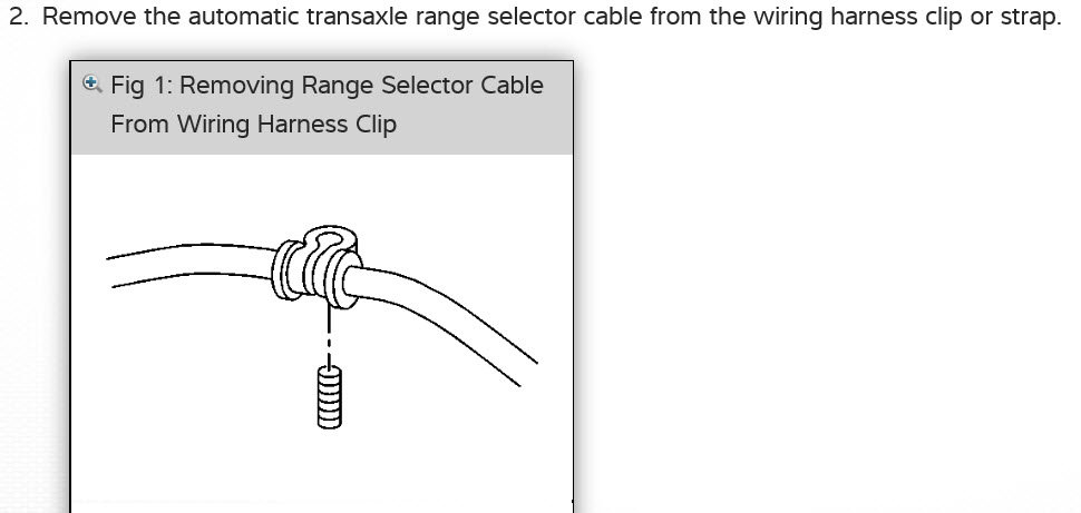

How do you replace a shifts
Sep 5, 2016 at 11:26 AM
HMAC300
Experienced Mechanic
48,601 POSTS
cannot understand question
Sep 5, 2016 at 10:40 PM
AURI LESLIE
MEMBER
3 POSTS

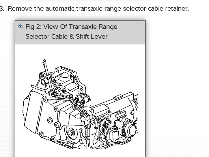

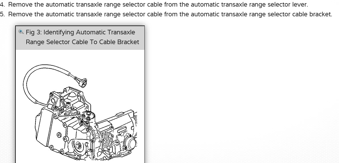

How do I replace the transmission shift linkage
Sep 5, 2016 at 10:42 PM
HMAC300
48,601 POSTS
here is part of instructions as I need to know if it's a floor shift or column shift. it's a cable.you have to remove air duct on engine to get to it
