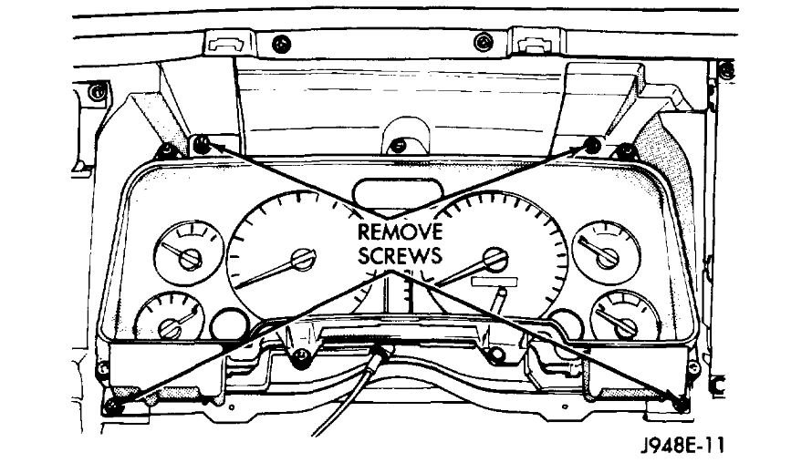

Truck runs fine and no noise from motor. is there anyway to reset dash or run a diagnostic test or reset dash? Truck has been fine no problems. what should i check first?
Dec 28, 2019 at 5:38 AM
  • CAR REPAIR CONTRIBUTOR

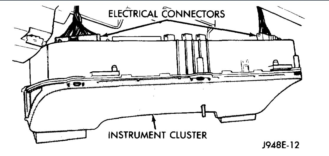

Good morning,
It is too early for these dashboards to be a module.
I would check the connection at the back of the cluster and be sure the terminals are clean, tight and not damaged.
Do you have a scan tool that can read the RPM and oil pressure as live data?
