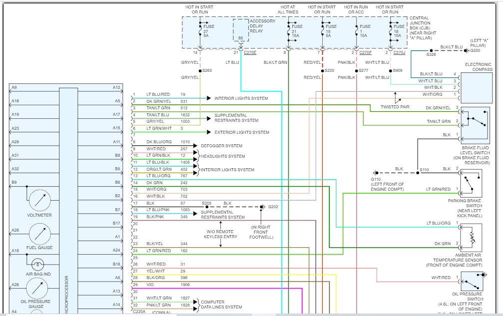

gauges stop working while driving?
2004 FORD F-150
200,000 MILES • 5.4L • V8 • 4WD • AUTOMATIC
MARTINDWAYNEWILLIAMS
while driving the gauges stop working and when they come back on. i hear like a grinding noise.

Are all mechanical gauges inoperative when this happens? I ask because there are different things that can cause it based on what stops working.
If everything stops and then restarts, start the vehicle and wiggle the connector at the rear of the cluster. Something may simply be loose. See if the gauges drop when you do this.

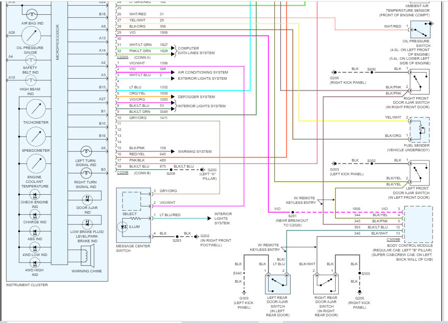

I attached the wiring schematic below which includes the gauge wiring. Note that everything is electronic. With that in mind, is it possible for you to record the sound you hear when this happens? Does the sound seem to come from the cluster?
