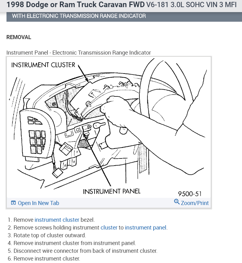

None of the gauges worked including; the digital odometer/trip, gear selector and auto door locks. Today everything started working again. Auto locks lock when started but don't unlock when.shut off.what is the cause?
Oct 17, 2019 at 11:23 AM
  • 55,628 POSTS

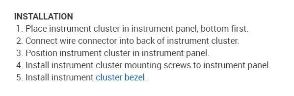

This is common when the cluster goes out. here is a video of the job being done on a similar car with instructions below to show you how on your car:
