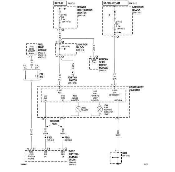

Gauges speedometer do not work
1998 PLYMOUTH VOYAGER
98,000 MILES
DANDYDON
Replaced dash panel still no work.
Jul 6, 2018 at 2:05 AM
Good morning.
Is the check engine light on?
Do you have a scan tool to see if the vehicle speed sensor is sending a signal to the PCM?
What specifically does not work?
I attached a wire diagram. If you have a test light or voltmeter, check the fuses for power on both sides.
