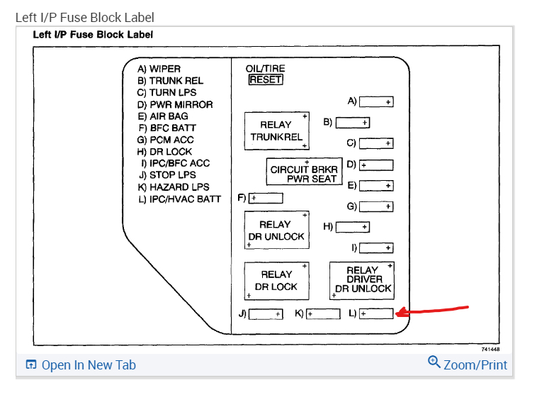

Was driving the car was fine, I parked it for about an hour and got back in heater didn't work, speedometer and gas gauge wasn't working. nothing on dash. Is it the fuse or is there something else going on now?
Mar 21, 2023 at 1:17 AM
  • 55,433 POSTS

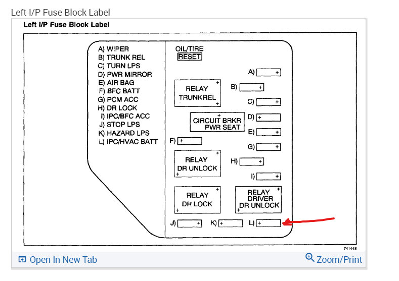

Yes, there is a fuse called IPC/HVAC BATT which is 10 amp (red) in the fuse panel behind the left side of the dash that has gone out.
Here is a guide to help you test it and the fuse location as well in the images below:
Check out the images (below). Please let us know if you need anything else to get the problem fixed.
