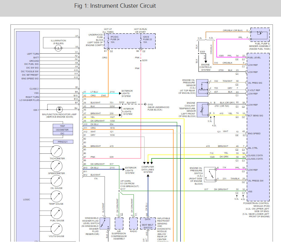

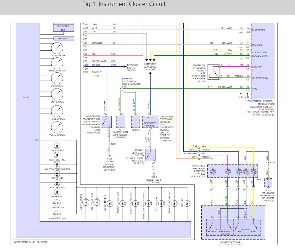

I have a 2004 Chevy Trailblazer and when I start up the vehicle sometime the lights won't come on neither do the gauges would move. Could this be the Body Control Module need to be replace or something ? How can this issue be repair ?
Jan 22, 2019 at 9:44 PM
  • 55,721 POSTS
It sounds like the cluster is going out but to be sure here is a guide to help you test for power and ground and the cluster wiring diagrams so you can see how the system works with a video of the cluster getting changed out for a rebuilt unit in a similar car.
and
https://youtu.be/_HEC44xENxw
Check out the diagrams (Below). Please let us know what you find. We are interested to see what it is.
