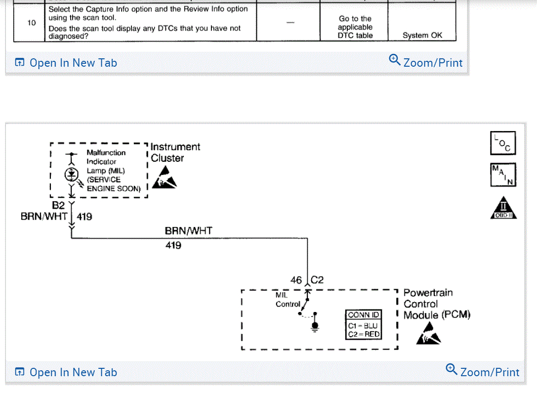

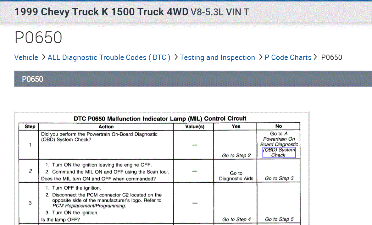

So, I took the truck for a drive after trying to get my parking brakes to work. I was hitting and releasing my e brake to take the glaze off the shoes. Upon doing so my cluster gauges just shut off and my battery light came on. I figured my cluster stopped working so I went and bought a known working instrument cluster, and it does the same thing. Shows what is pictured. Mileage and trip work, also the shift selector, blinkers, hazards, high beams all come up on the dash but none of the warning lights come on the dash when I first turn the key to on. The message center all I get is the battery showing as in the picture and the security flashing sometimes. I’ve checked all my fuses and they all seem to be fine. I’ve ran a separate ground to the black/white wire to the back of the cluster harness still no change. The instrument cluster was absolutely working fine until I hit and released the e-brake while driving. I scanned the truck and came up with code p0650. I’m at a loss.

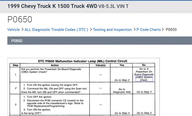

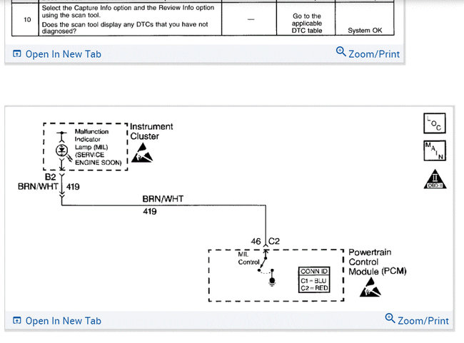

The code is specific to the MIL (malfunction indicator light). However, it sounds a little more involved.

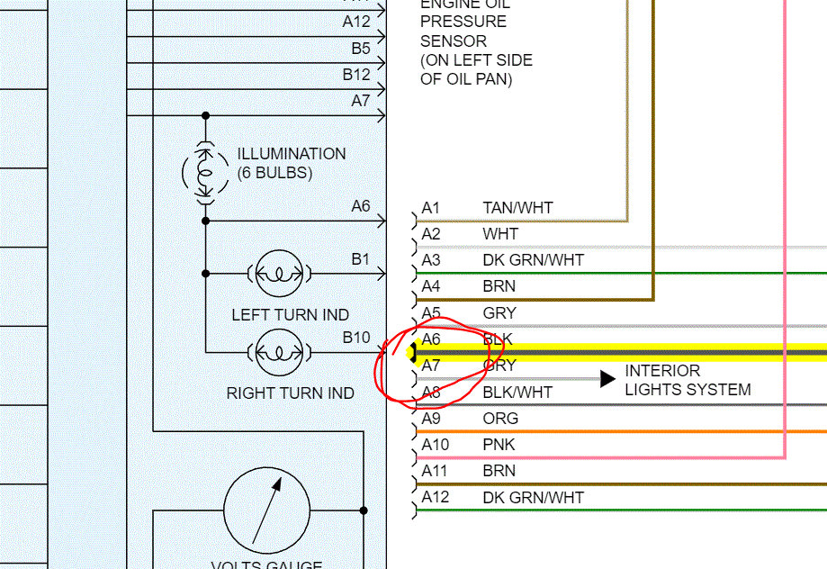

Since you were working on the parking brake, I have a feeling you damaged the ground splice for the instrument panel. On the upper left-hand side of the kick panel, you will find a solid black wire. The black/white wire is specific to the bussed fuse box and washer level switch.
Check to make sure the black wire is not damaged.

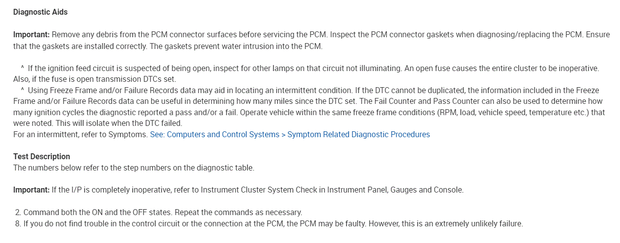

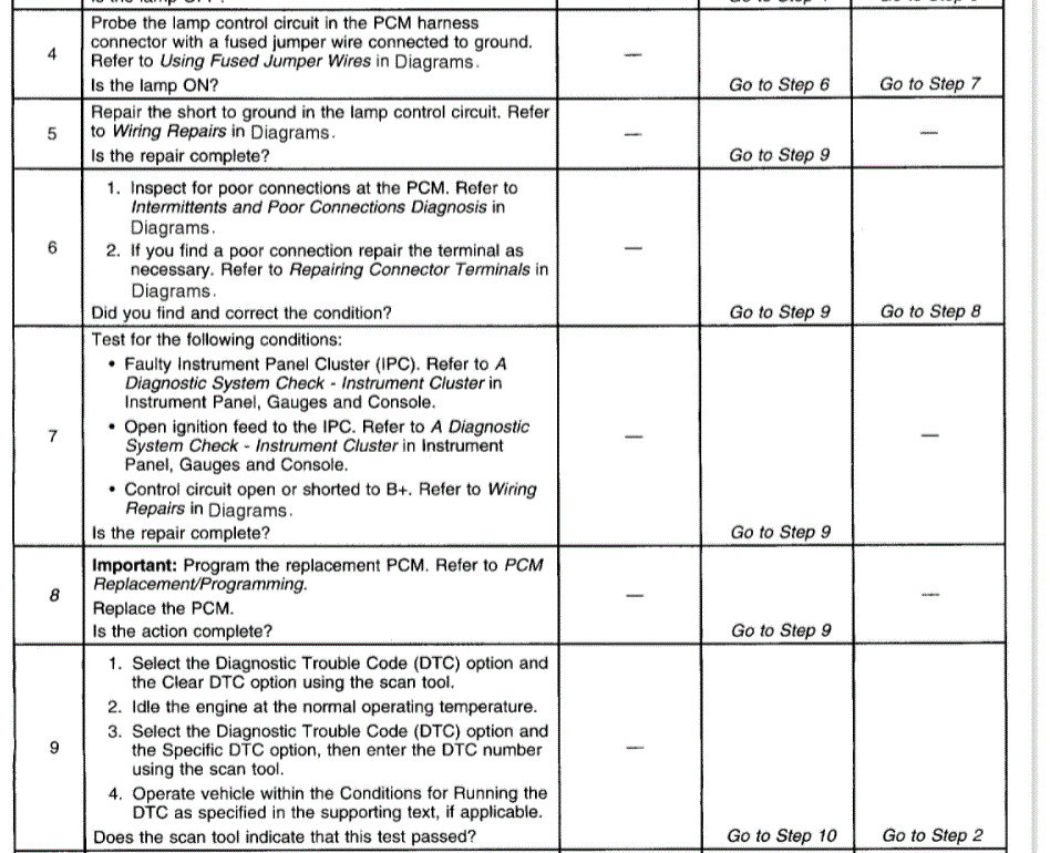

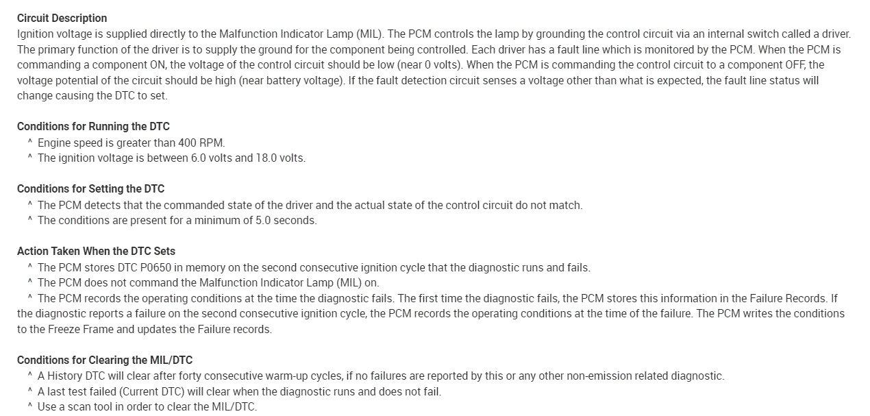

If this all checks good, I attached the diagnostics below for the code. Take a look through them and let me know if you are comfortable performing them.
You may want to do this first. If possible, disconnect the connector from the cluster and locate the black wire. See if there is continuity to ground.
See pics below. The last pic shows the ground of interest.
