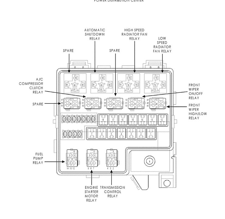

My gauges are not working at all nor my odometer. All the other lights work and the cluster is new.
Jun 23, 2019 at 3:59 AM
  • 55,224 POSTS

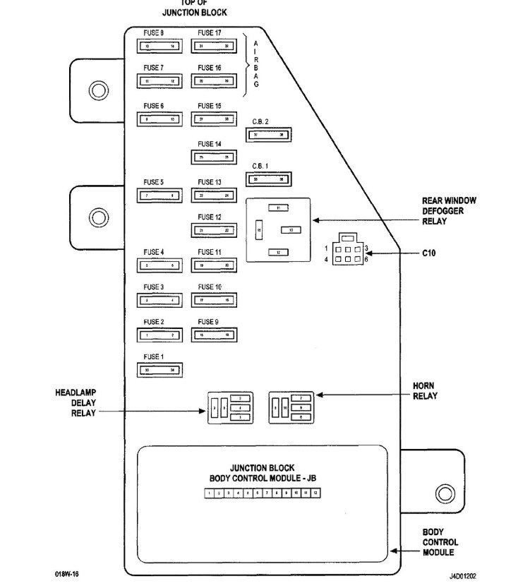

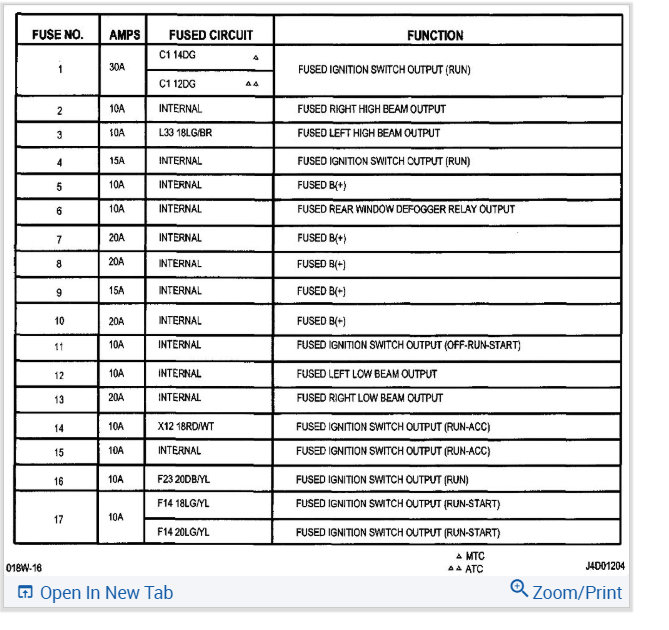

Can you test to see if you have power at fuse # 11 and #7 in the fuse box left side of the dash. here is a guide to help and the fuse locations as well below:
Check out the diagrams (below). Please let us know what you find.
