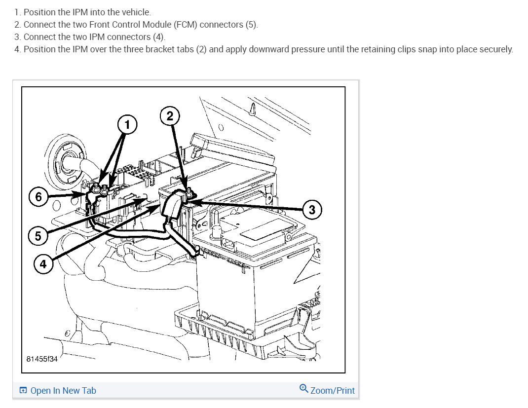

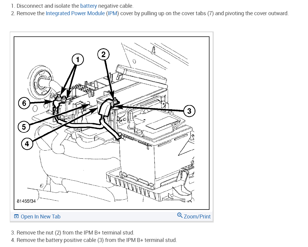

MONTECARLO92

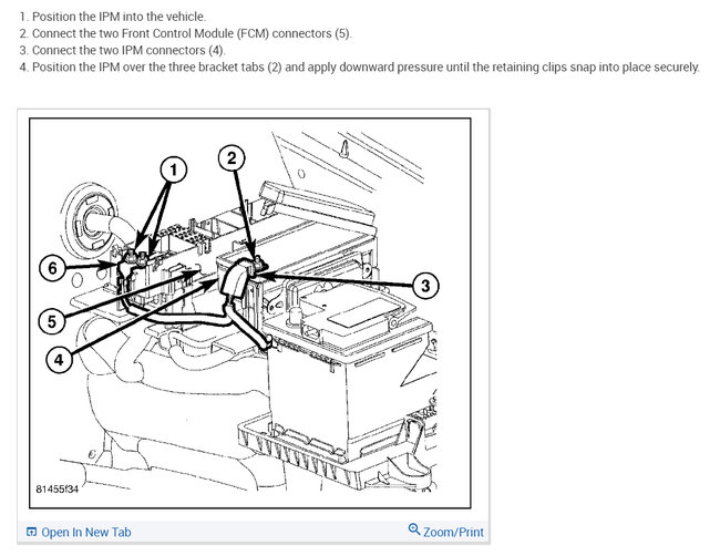

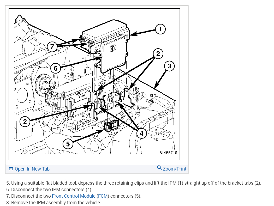

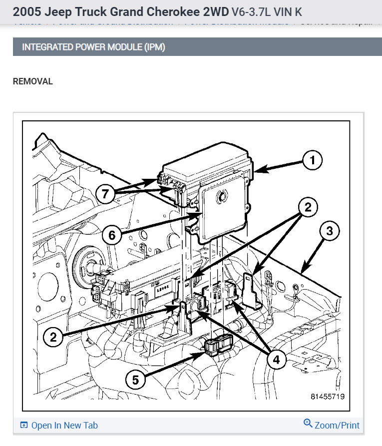

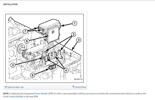

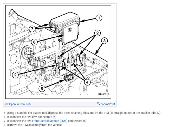

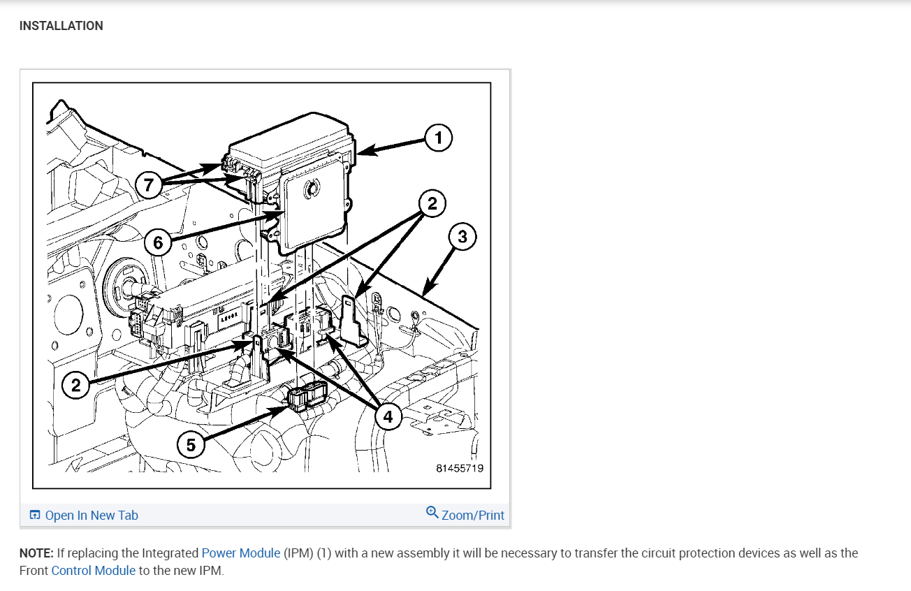

All the above stated is not working, it’ll work sometimes at night but then the radio stops working. What could this be?
Mar 10, 2023 at 4:47 AM
  • 55,433 POSTS
It is common for the IPM (interrogated power module) to go out which will cause the issues you are having. It is easy to replace because it-self learns, here is the location of the part and instructions on how to swap it out. Check out the images (below). Let us know what happens and please upload pictures or videos of the problem so we can see what's going on.
