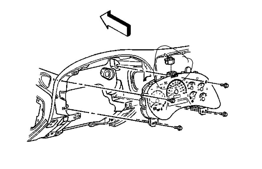

The lights work on instrument panel and speedometer works the small gauges were working and sometimes they would drop to zero I could hit the dash and they would start working again. now I can't get them to work.

It sounds like a bad connection. I would remove the cluster and check the connection at the rear of the cluster. Make sure the pins are clean, tight and no damage.
Beyond, that, the cluster itself is the issue.

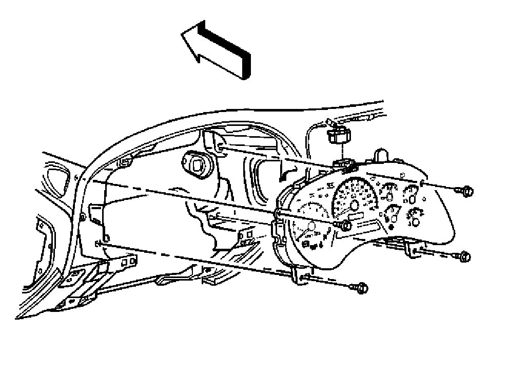

INSTRUMENT PANEL CLUSTER (IPC) REPLACEMENT
REMOVAL PROCEDURE
1. Remove the left closeout insulator panel.
2. Remove the knee bolster trim panel.
3. Remove the instrument panel cluster (IPC) bezel, Chevrolet only.
4. Remove the instrument panel (I/P) accessory trim plate, GMC or Oldsmobile only.
5. Remove the screws retaining the IPC to the I/P.
6. Partially remove the IPC from the I/P in order to gain access to the electrical connector.
7. Disconnect the electrical connector from the IPC.
8. Remove the IPC from the I/P.
