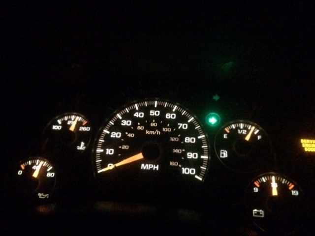

My temperature, gas, and speedometer are not working? My oil and amps is? One more thing, when I pop my horn, the right signal comes on and when I stop it stops. I do not know if the outside blinkers comes on or not. Here is a picture of my dash as my truck is running. Thank you for your time. :)

Check battery to body ground and ground on rear of left hand frame rail as well as header panel for lights which is by radiator. For the gauges scan for codes to see if it is a speed senor otherwise the cluster may be bad which can be rebuilt then a mechanic has to install otherwise speedometer will not work.
