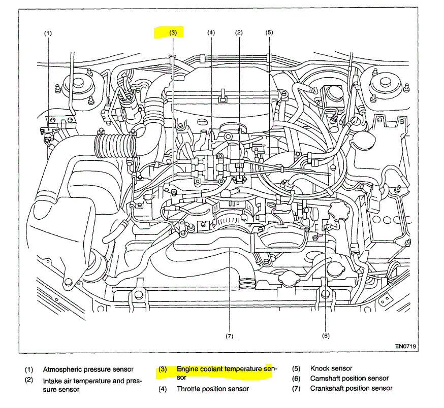

I have a 2002 Subaru outback Impreza sport wagon. Just recently the gauge started showing it was hot. But when I would pull over and check, nothing was overheating.
Then it became erratic and was going up and down. Finally, just stayed on H.
We replaced the sensor, top radiator hose, thermostat, and flushed coolant. Still on H but nothing is overheating. I was told it might be (God forbid) the head gasket. So, I put some sealant in for that. Nothing. Help?
May 28, 2022 at 7:14 PM
  • 110,194 POSTS

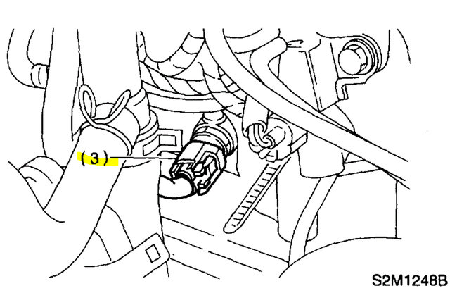

When you first turn the key on to the run position (engine cold) does the gauge immediately indicate the engine is hot? If so, then suspect there is a short in the wiring to the sensor.

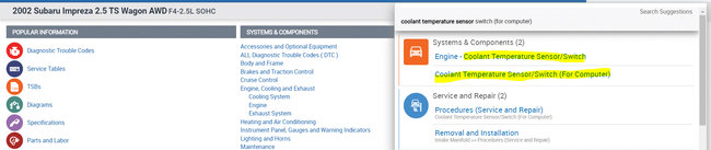

However, there are two coolant temperature sensors on this vehicle. One is for the cooling fans and the other is for the computer/gauge. Take a look at the pic below and let me know if that is the one you replaced.
Also, take a look through this link and let me know if you have any of the symptoms:

I believe it was the engine coolant temperature sensor.
And it doesn't go immediately to hot but within a couple min. even if the car itself is still cold. As I said, nothing indicates the car is actually overheating.
Also, I did use Blue Devil the day before yesterday and it doesn't seem to be helping.
May 29, 2022 at 11:55 AM
  • 110,194 POSTS
Okay. Here is an interesting thought: The sensors (two of them) are both called coolant temperature sensors. If I recall, the one for the fans is on the radiator. The other is on the engine. Do you recall where the one was you replaced?
Also, this still could be a head gasket-related problem. Did you look through the link I attached above?

I'm pretty sure it was on.
May 30, 2022 at 7:34 AM
TJALDRICH22
Oops, it was on the engine.
