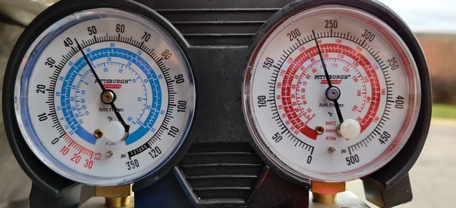

Online I read that the ambient temperature and along with a chart such as the one in the photo I would be able to see if my system is properly charged.
It's this at idle rpm? Is it with the windows open, fan and cooling set to max?
Today I took a reading at 85 ambient temperature. In the picture is a pic of the readings after about 15 minutes the van was running. It's this a good scenario?
Windows were open system set on high cool.
Based on these readings am I to look at the r134 scale? Red and blue lines?
Jul 30, 2020 at 2:49 PM
Correct. You don't have to have the windows open. Some say you should but that is not necessary. However, you read the gauges with the engine on and at idle and A/C set to MAX.
So at 85 degrees ambient temperature your readings are perfect. Based on these readings your system should be blowing cold. Do you have any issues or are you just checking it?

How would I properly read these settings? In other words what are my low and high numbers. I have had 2 different answers.
Aug 2, 2020 at 4:32 PM (Merged)
Good morning again.
The blue gauge is the low side and the red gauge is the high side.
42 on the low side. That is high as I explained before. It should be 25-30 pounds.
225 on the high side. If it was 100 degrees outside, that would be normal.
