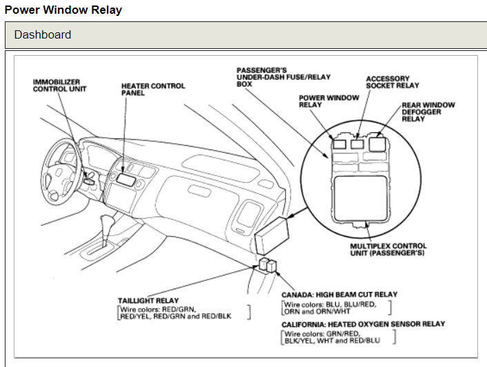

My gauges on my dash stopped working, also my windows will not roll up and it is hard to shift gear.

There is a power window relay that power several circuits. Here is a guide to help you test the relay and the location of the relay below:
Check out the diagrams (below). Please run this test and get back to us.
