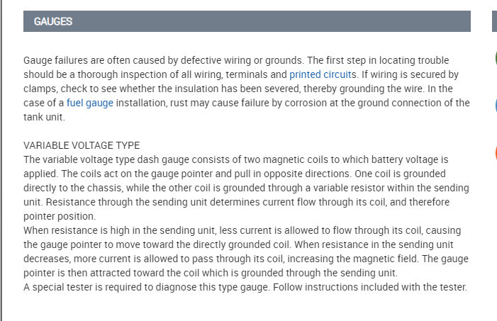

Hello, my voltmeter and my temperature gauges don't work; needle looks to be broken as they are not pointing to any numbers. Is there a "common" reason for this? Or am I looking at new gauges? Maybe a new printed circuit board?

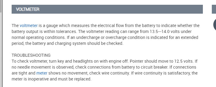

The only thing that these have in common is the cluster so what I would do is remove the cluster and check the connections at the back and make sure there are no issues.
Then check the voltage at the meter as shown in the attached info below.
Here are a couple guides that will help with testing this voltage:
Please let us know what you find and what questions you have. Thanks

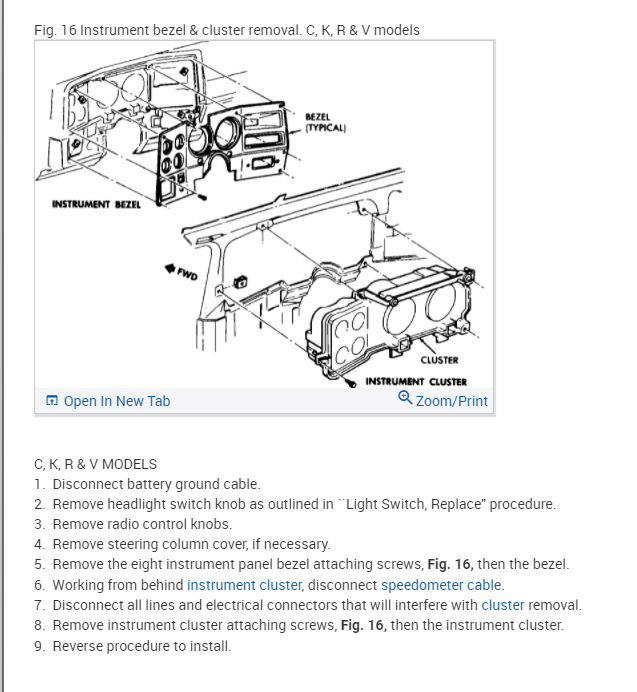

Great, thanks. Can these come out without removing the dash pad, or no?
Nov 6, 2021 at 9:54 AM
It has been a while but no. I think you can access all the screws around the cluster without removing it. The instructions I attached above do not say to remove it either so you should be able to get to them all. Take a look at the second page I attached on my last response and let me know if you need more info or how you make out.
Thanks

It is possible that the gauge is accurate but if it is maxed out then the likely cause is the wiring is grounded and not running through the resistor in the gauge.
Basically, the way it works is there are two magnets that pull the needle to where it needs to be. So, one side is grounded, and the other side runs through a resistor which causes the needle to move through its sweep based on the sensor input.
So, if it is pegged in one direction, that tell me that the other sides magnet is not working which means that wire is grounded prior to the magnet.
So, we need to check for a short to ground or just run a new wire from the sensor to the gauge.

As a follow up to this: the oil pressure is running just under the 60 psi mark, so I think it's working ok..? However, the voltmeter gauge is now having issues: it was working great, and then while driving it, the needle just jumped to 3 o'clock. When I turn the truck off, the needle goes back to 0; turn the key on...back to 3. It's getting power, but no signal. I've checked all the wires, but no luck. Is there a fuse, or something else going on?
