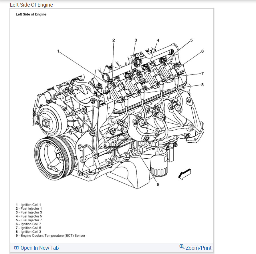

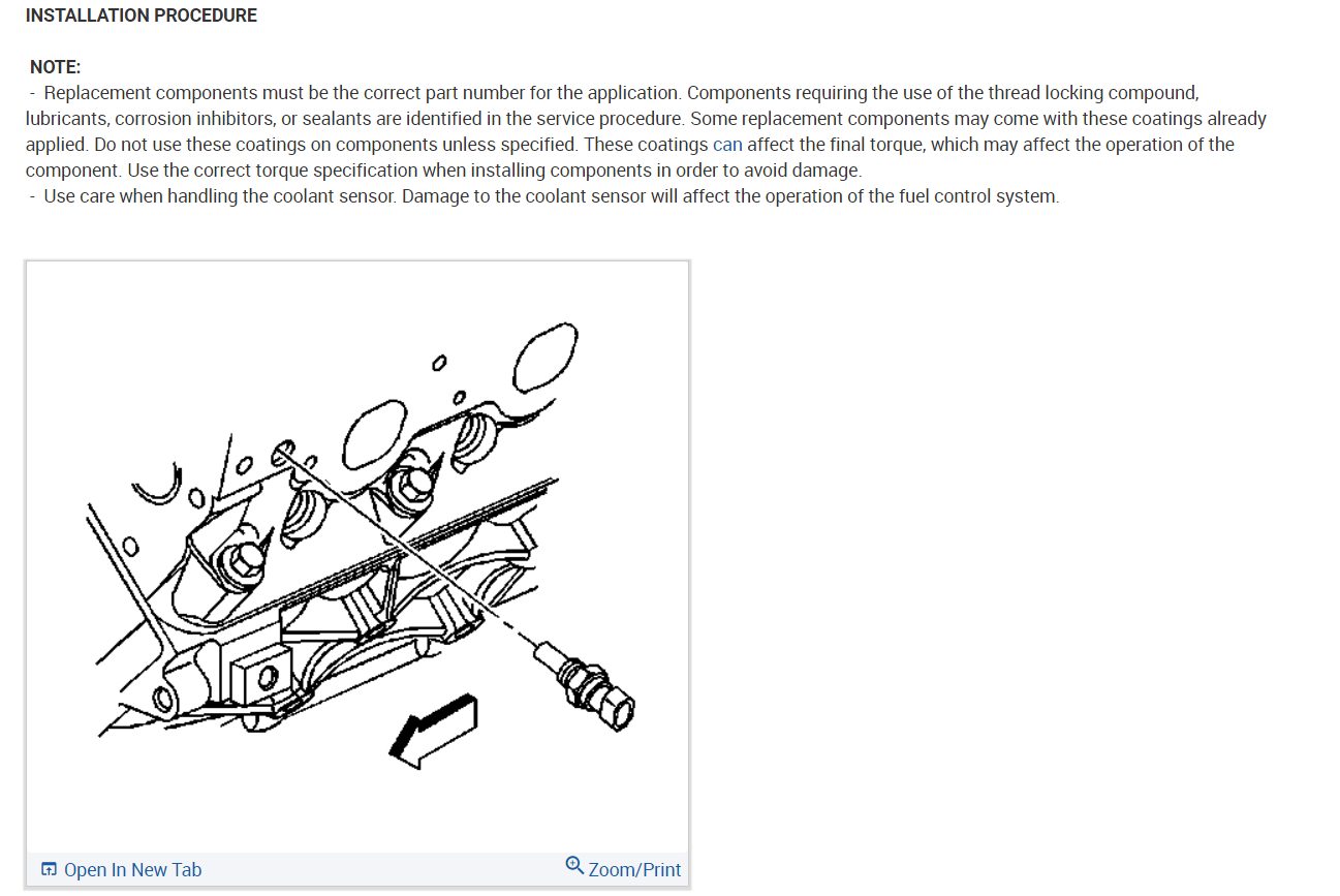

the temperature gauge will get stuck sometimes. I can reset the gauge by removing one of the fuses in the fuse panel that's located near the driver door. This fix doesn't work sometimes though. I just leave the fuse intact and wait for a while( maybe 1 hour or more) and i can reset it back to zero temp. Can anybody tell me what the problem is with this thing?
Jan 29, 2007 at 4:08 PM
  • 75,992 POSTS

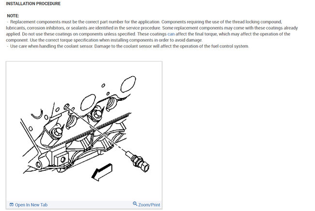

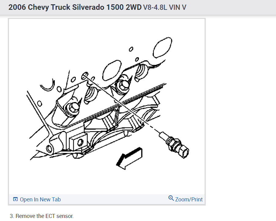

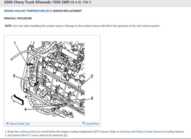

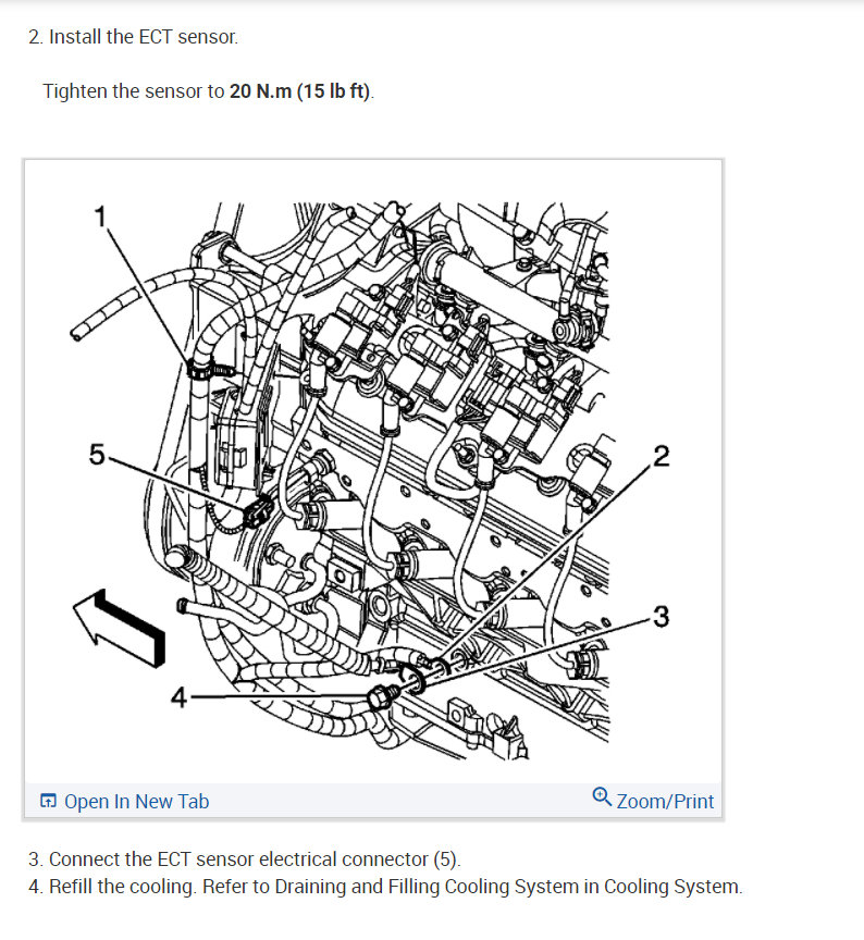

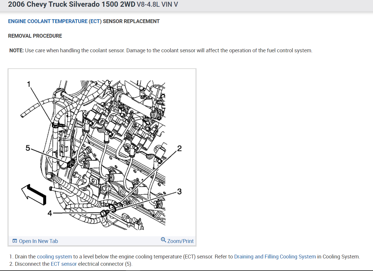

9 times out of 10 it will be the coolant temperature sensor or cluster here is a video that shows how to fix it.
https://youtu.be/_HEC44xENxw
Check out the diagrams (Below). Let us know what happens and please upload pictures or videos of the problem.
Jan 30, 2007 at 4:33 AM
MAB32174
  • 5 POSTS
it was the cluster thank you so much I love this site.
