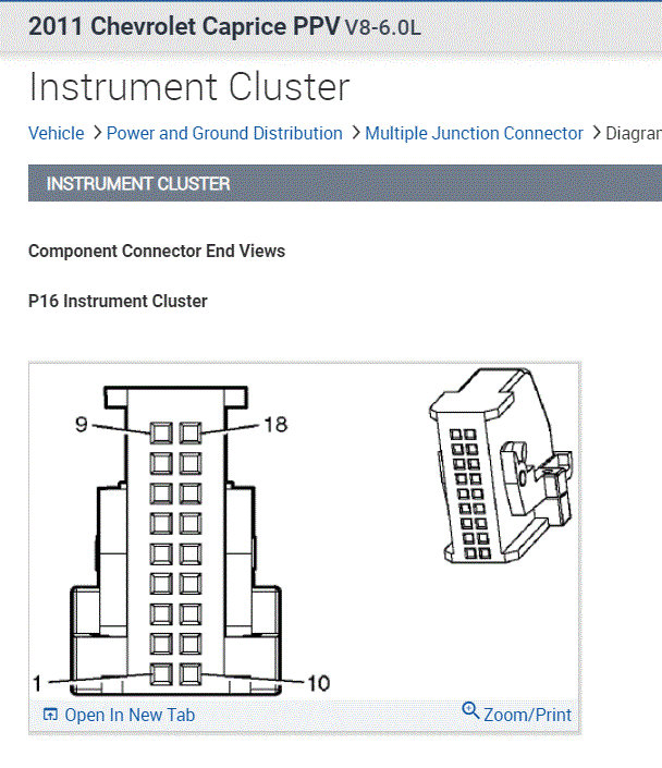

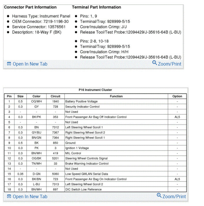

Looking for a diagram/pinout of the gauge cluster harness connector. Don't believe the g8's to be the same and unable to find one for the Caprice specifically. Thank you

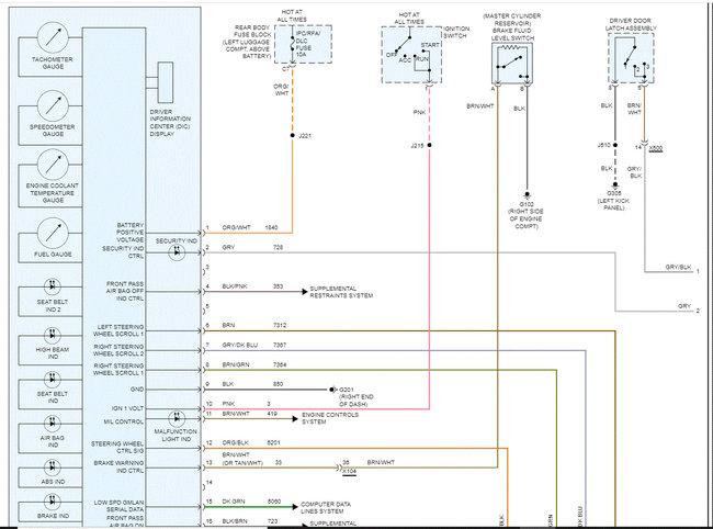

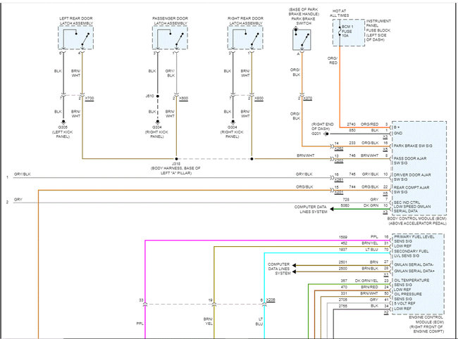

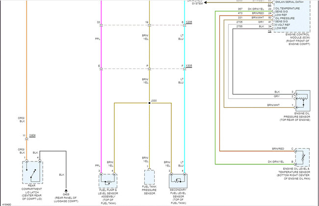

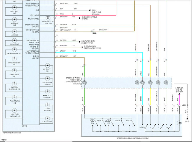

I believe this is a police pursuit vehicle, PPV. I was able to find the wiring schematics for the instrument cluster as well as the connector pinout. I attached them below.
I'm not sure what is happening but let me know if I can help. Also, here is a link you may find helpful:
I hope this helps.
See pics below. Note: Pics 1-4 were actually only two pics. I had to cut them in half to make them readable for you. I did overlap them so you can follow from one to the next.

Perfect, thank you!
