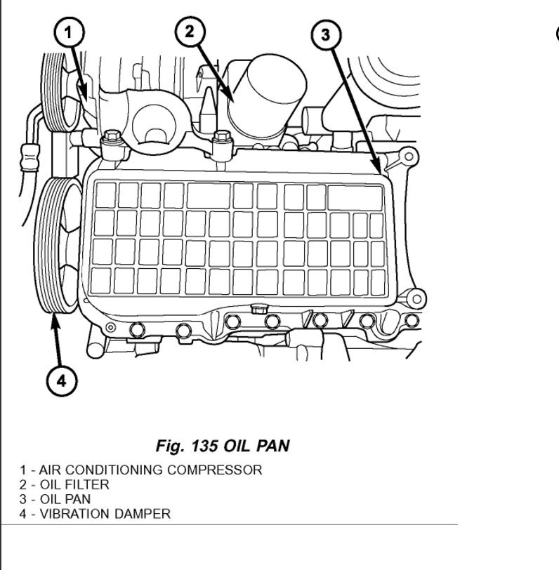

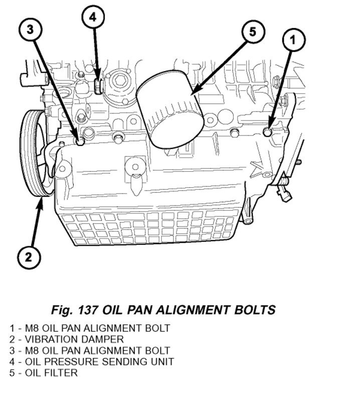

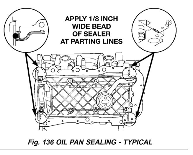

Need to change oil pan gasket instructions.
Jun 25, 2017 at 12:34 PM
Experienced Mechanic
55,554 POSTS
You will need to disconnect the battery and drain the oil before you begin. Also you will need to jack the car up.
Here are some diagram (below) of what to do to check the oil pan on your car.
