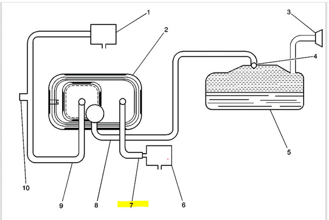

The canister vent valve (#6 in pic) either is blocked or not working. Number 7 in the pic is the vent hose. When filling the tank, air needs to escape. If it can't, fuel can't enter. Check to make sure the vent hose isn't pinched. Also, let me know if the vent valve is what you replaced.

Yes, I replaced the canister vent valve and the vent solenoid. The check engine light has gone off after replacing the canister vent valve but tank still is not vented. I removed the hose completely between the canister and the canister vent valve when I replaced the valve. The car is due for emissions test next month so I am down to the wire. The only thing I haven't replaced at this point is the canister itself. They are supposed to "last the life of the car" according to research.

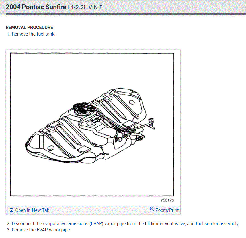

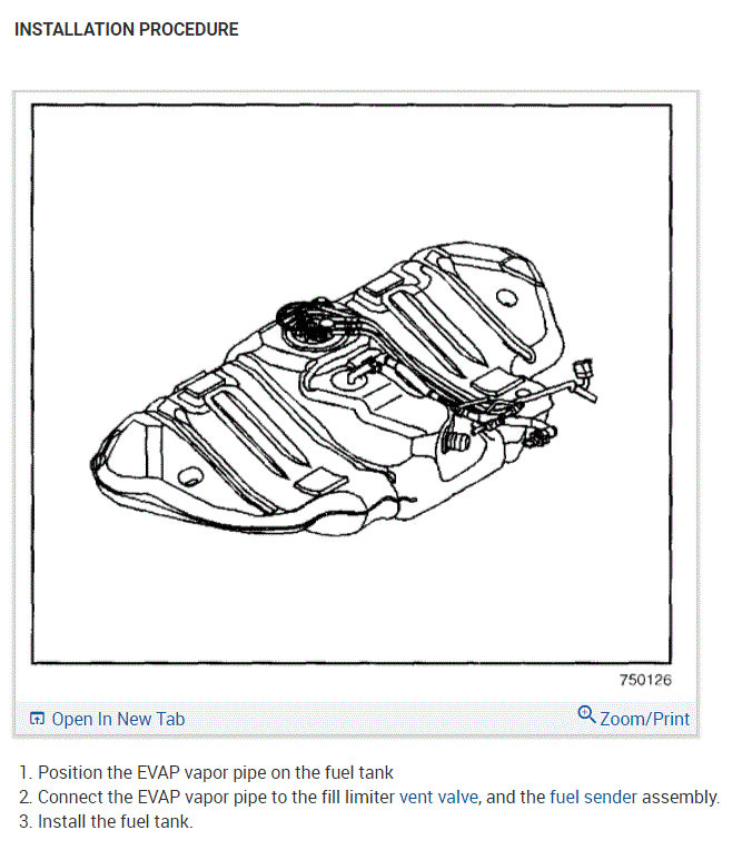

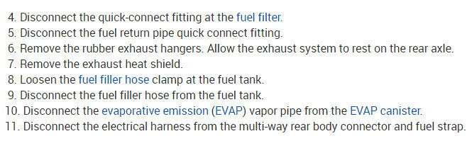

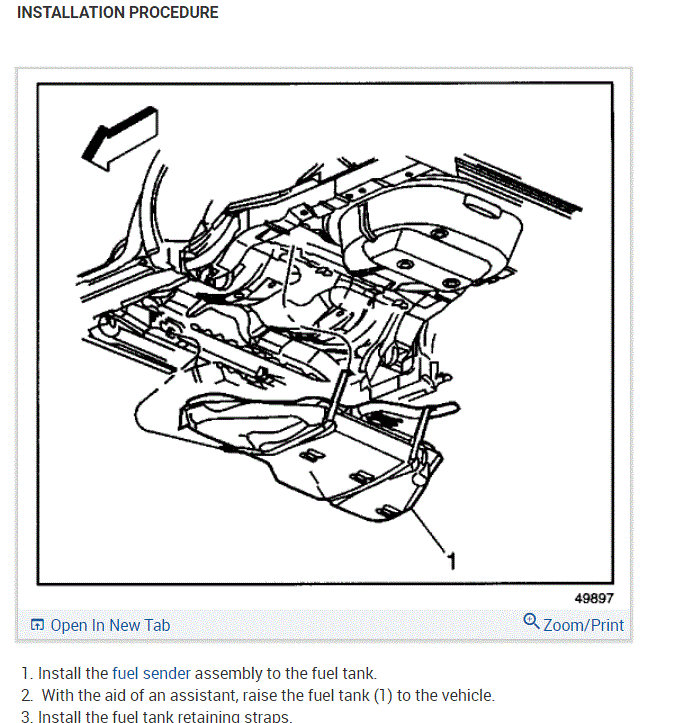

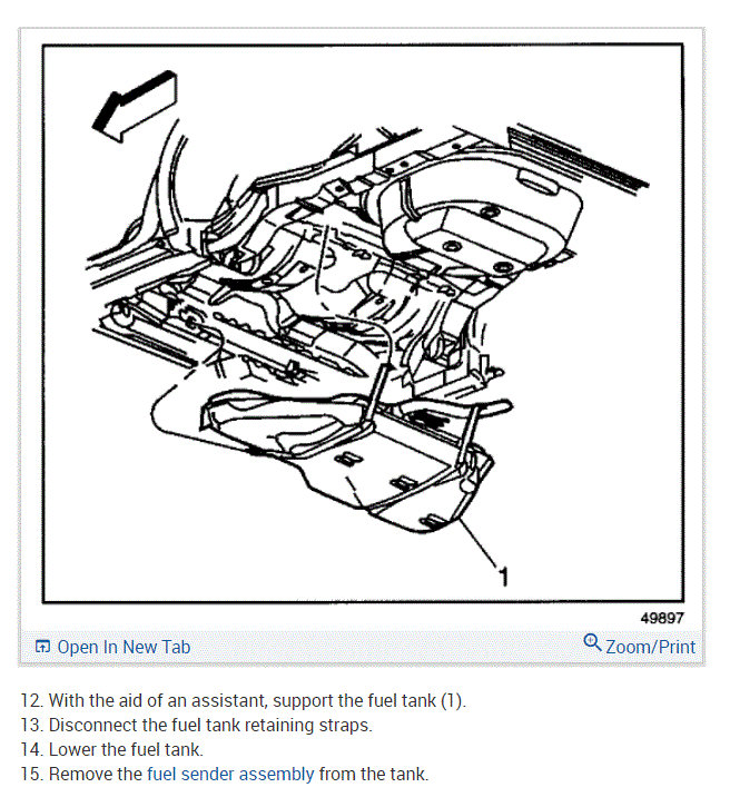

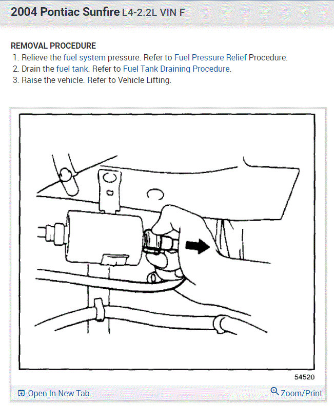

The sound gets louder because the fuel is raising up the filler tube. If you had it disconnected and it only helped a bit, then the problem has to be before the canister. At this point, you will need to remove the fuel tank and check the fuel limiter vent valve on the tank. I have a feeling it is stuck closed or partially closed.
The attachments below provide the directions and pics relevant for the removal and replacement of the fuel tank and the fill limiter vent valve.
If it is still doing a similar thing, either the hose from the tank is plugged or the vent is not working.

Are you sure this car has a fuel limiter vent valve on the tank? I can't find the part anywhere.
Mar 31, 2021 at 12:29 PM
  • 110,248 POSTS
That is what it shows in the manual. However, anything is possible.
