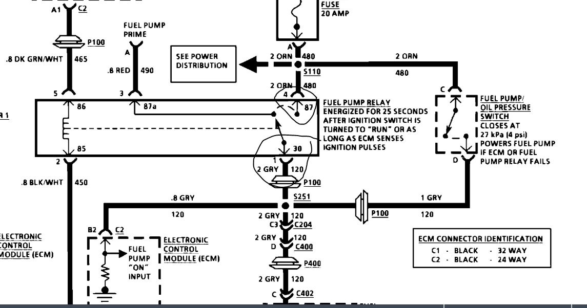

I can't siphon gas out of it. does it have a plug or do I need to take a hose off?

Good morning,
It has an electric pump. You could remove the line at the fuel filter and put a hose into a bucket.
You would need to jump the relay to work the pump manually. Jump the 2 terminals I circled for the pump to come on.
